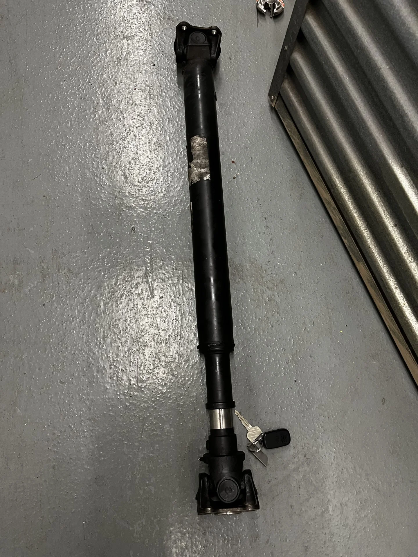

So are the factory shafts pre-greased or not? I've bought new front and rear OEM shafts and never greased them until thousands of miles later as part of routine maintenance.It will have the assembly grease that Toyota uses in the bearing caps, nothing else.
Grease the joints before installation. I like to separate the halves and manually grease the slip yoke splines, then remove the grease nipple for the slip yoke, assemble the shaft and compress the yoke until all the excess grease squirts out. Then reinstall the nipple.
forum.ih8mud.com
factory joints are greased with an assembly lube. Basically it holds things in place and inhibits rust. Bearing grease is made from 1 of 2 base stocks which are not compatible with each other. So it is left to the end user to initially grease the shaft and to use the same grease in perpetuity to provide the longest service life. I personally would just use bearing grease and avoid Moly fortified stuff. But that is an individual's call.So are the factory shafts pre-greased or not? I've bought new front and rear OEM shafts and never greased them until thousands of miles later as part of routine maintenance.
Like this rear shaft I've had on my 80 for ~40K perfectly reliable miles. Did not grease at all upon purchase.
I recall an orange-ish grease coming out of the U and slip joints which was quite a contrast to the gray Valv Palladium moly I use.
I never had an issue running the factory shafts from new. Would be good to put this to rest given conflicting reports from two forum members I respect.
