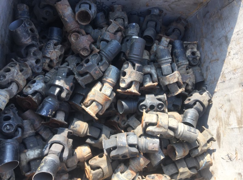

I finally had time to start working on my truck again. I ordered the double cardan joint from Marlin crawler but they sent me the wrong one. After several emails, measurements and pictures, they tell me that the measurements I gave them are for a Tacoma or that the truck has been modified. I have on this truck since new and it has not been modified. What there be a time One Toyota might use a different part from Factory?View attachment 2092895View attachment 2092895
