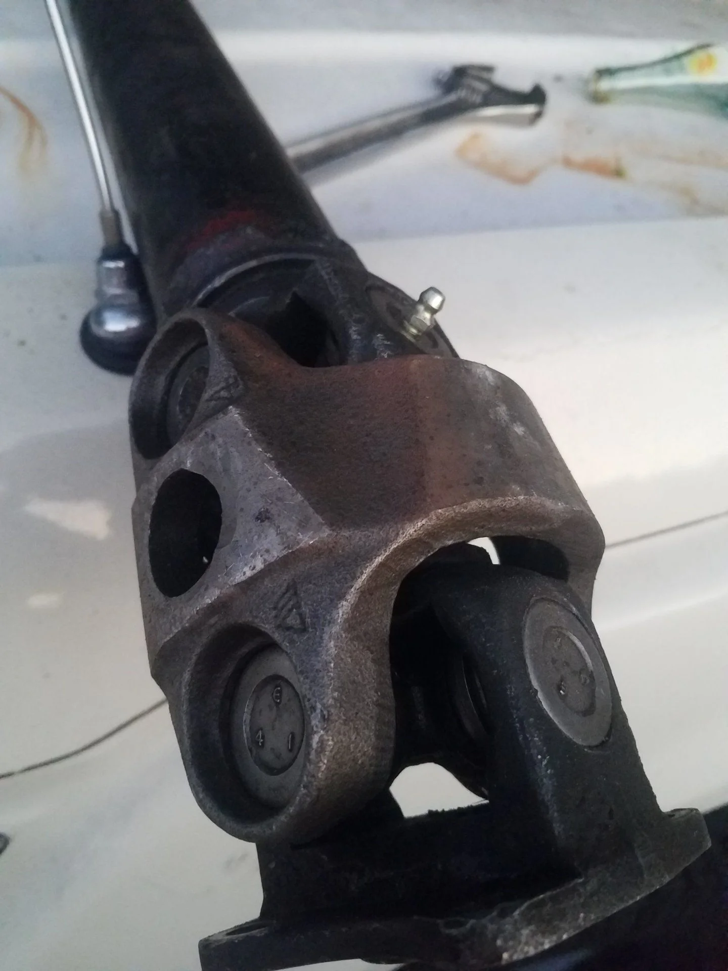

Rear Drive Shaft Double Cardan Cracked

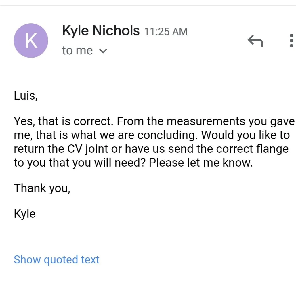

I replied back to them asking whether it was a front or rear part, here's the reply
reply
Does anybody have the measurements for the center to center spacing for the bolt holes? I used a cheap digital Harbor Freight caliper to measure mine
I would have them sent a flange if it will work. The cv Marlin shows is way more readily available than any others.
