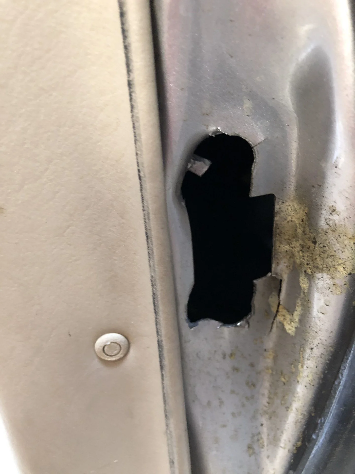

Well I unfortunately just joined this party. I just thought that clunk was a 21 year old door noise.
My rear ds door:
Took the stop off the B pillar and pushed it into the door for now:
rear PS door is fine, but will clean and lube.
Time to asses: 1) body shop (anyone pay for this) 2) weld myself (possible) or enlist local help or 3) build a strap solution. @PabloCruise you still around northern CO? Might be interested to pick your brain.

You can add me to the list of broken doors at 275K. Rear passenger side fully pushed in and after checking the rear driver side it's cracked and ready to give out soon. Fronts don't seem to be an issue. I had cleaned and lubed these in the past, mostly because of squeaking since I didn't know this was an issue. I don't think lubing will solve all the problems, it seems the spring loaded rollers inside the housing have seized up pretty bad on mine, it takes a tremendous amount of force to push it through the stops. Going to soak them in acetone and lube to see if they are salvageable.
I went ahead and made a template similar to @PabloCruise in post 31 and sent it to Online Laser and CNC cutting for metals and plastics - Instant Quotes - https://sendcutsend.com to be cut in 11g sheet metal. I will have the passenger side cut out and welded in and hoping I can just bolt the plate on the driver side to prevent it from cracking further and pushing through. I had to order 15 piece to meet the metal minimum so if they work out I will ship anyone a set for the shipping cost.
