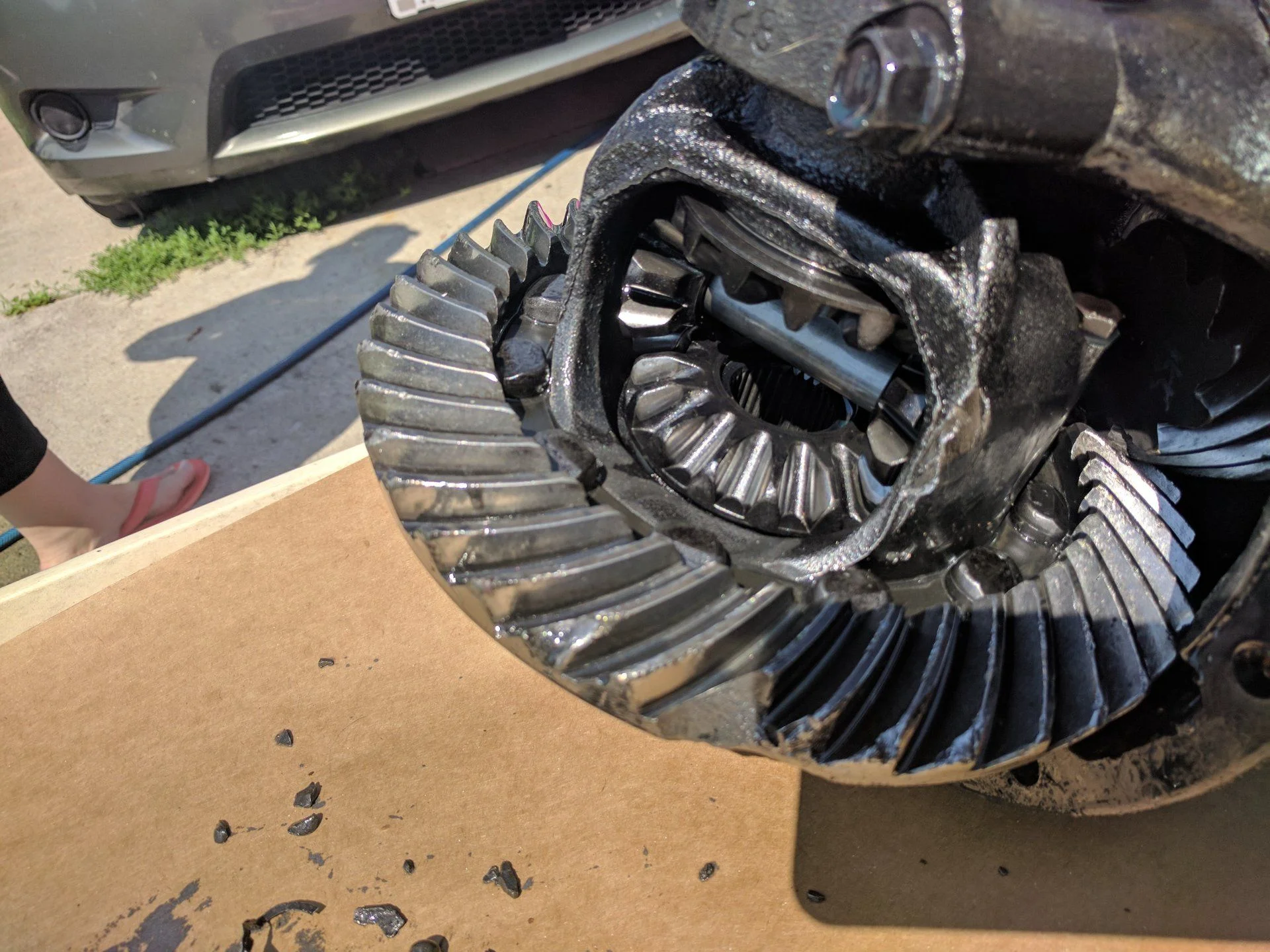

Well I finally had a chance to get my rear third member off my LX450. What I was hoping would be a easy fix, might be more ugly than before.

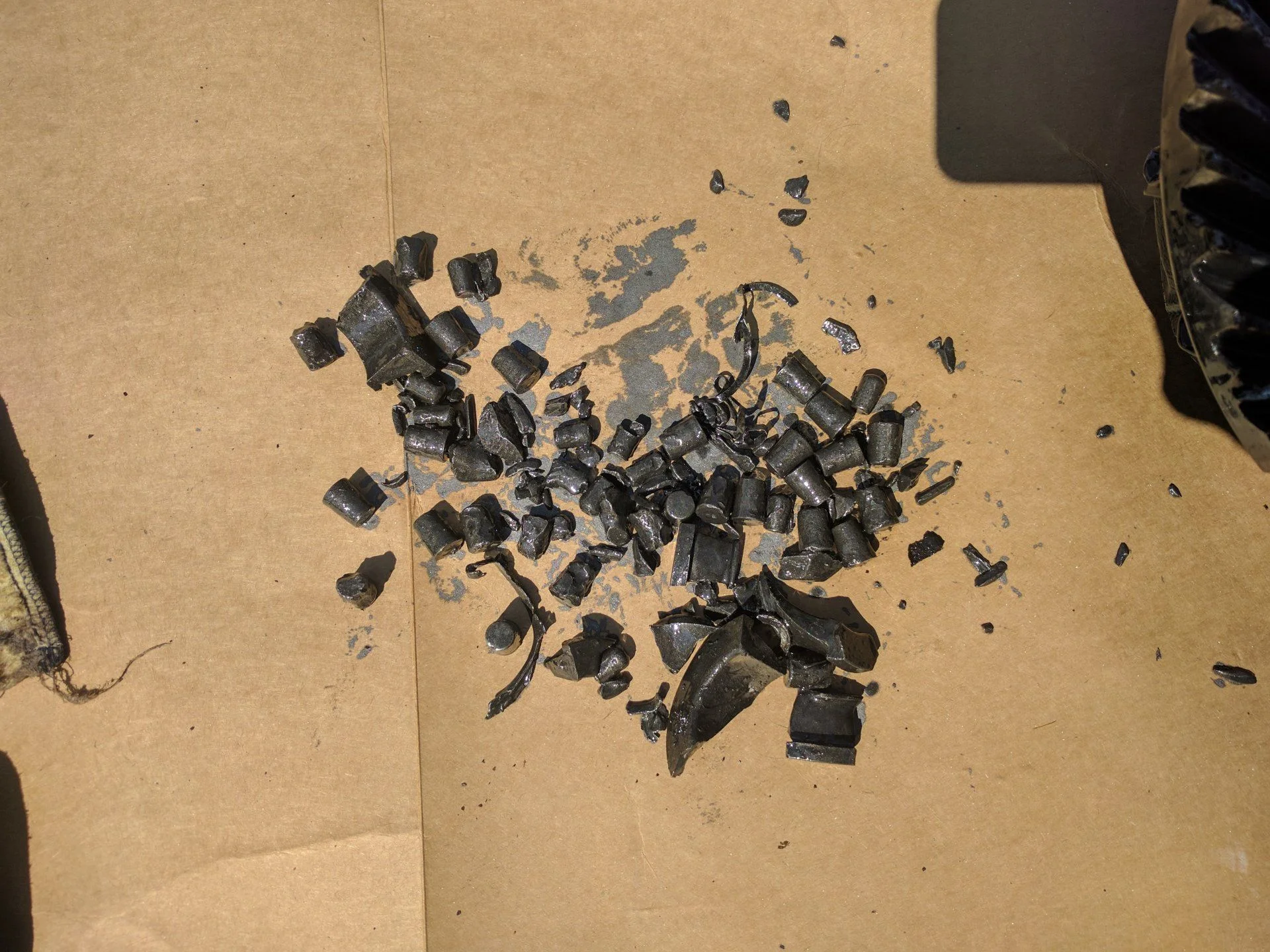

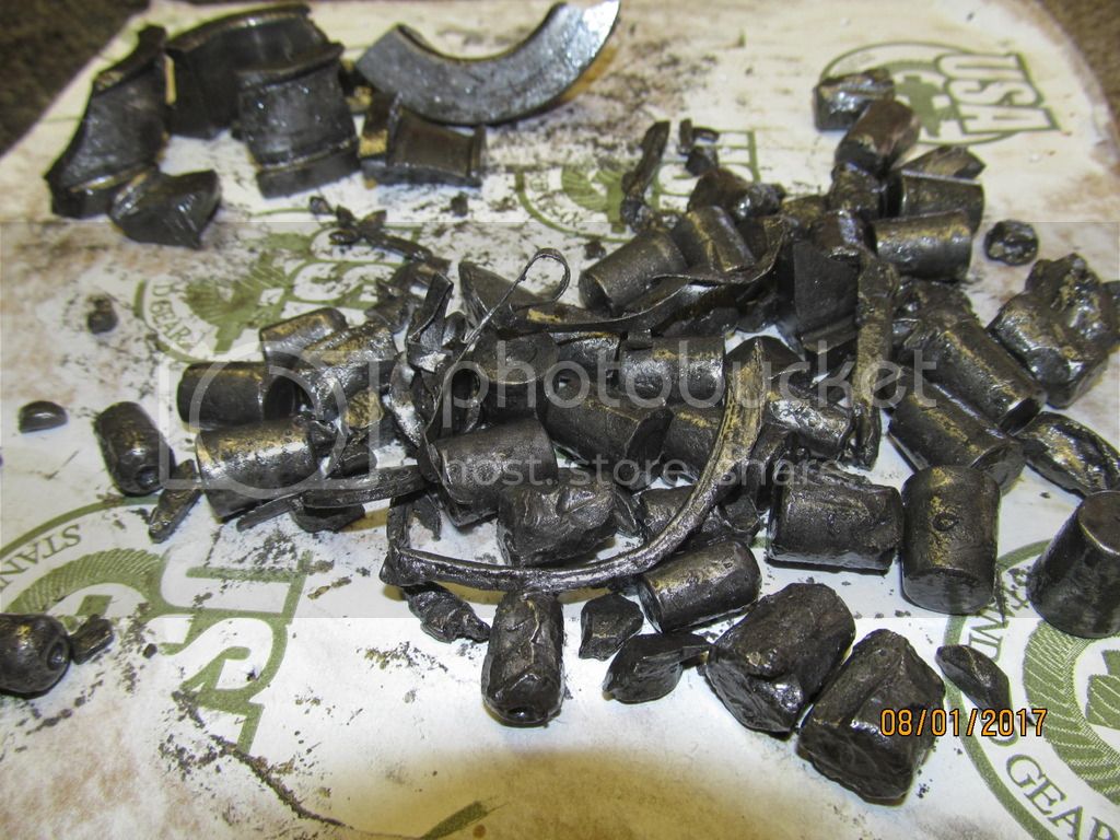

I was very surprised in after removing the rear diff, the amount of metal in there...

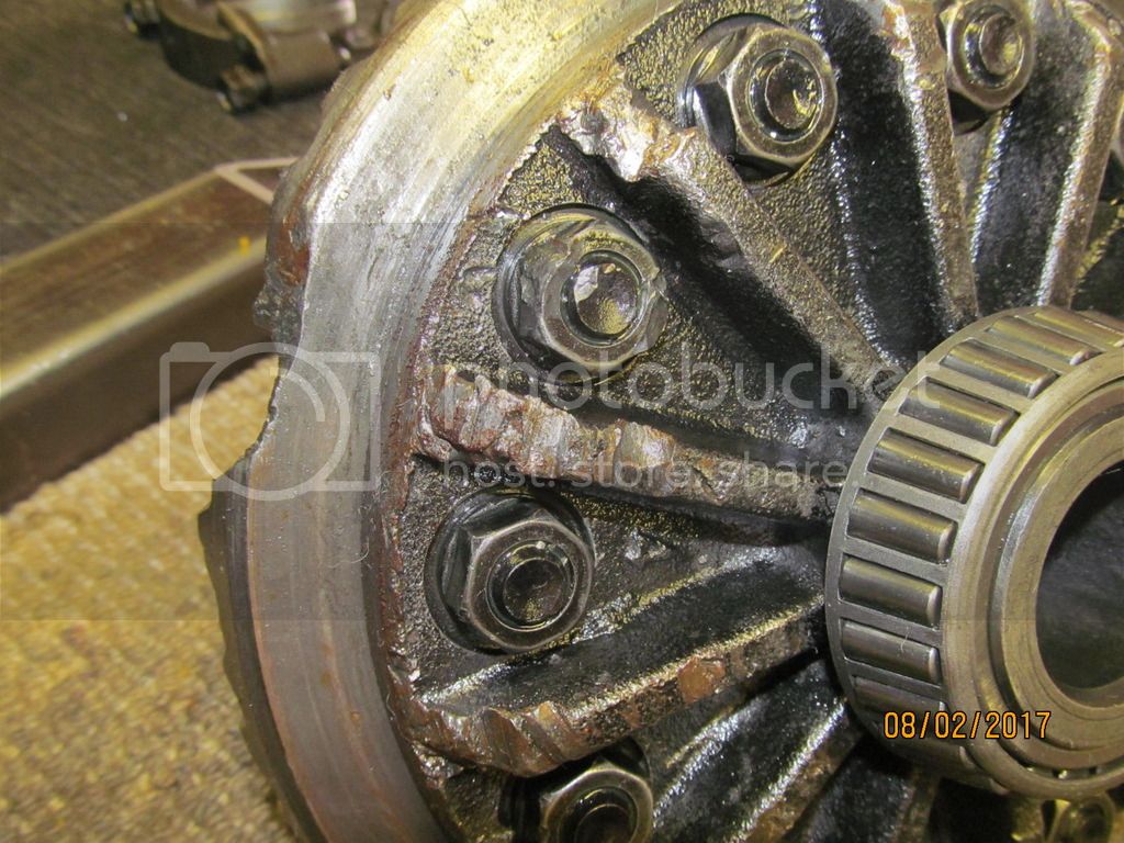

Definitely curious to hear what Zuk says. I'm not sure how you could do something like that just by installing the differential, but anything is possible I guess.
That looks to me like someone didn't clean out all the remains of the previous failure, then it ate the pinion bearings, allowing it to move and
eat the ring.

Since you had two recent failures.....Are you sure the axle housing is straight and true? Could be an external force causing the issue. I think as much $$$ as you're spending, it would be worth a serious look.

Agree here especially given the type of load it was seeing. This isnt normal
I would be a little livid, at that few miles, and a failure of that caliber, and a bearing failure to boot, 1 they either reused his old bearings or 2 Chinese junk, and maybe 3 he used some old bearings from another job SMH I'd be having words with them

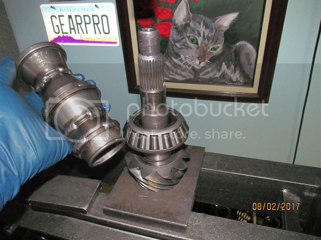

Here's the races for both pinion bearings...and the shims used to set pinion depth.
IMG_1121_zps9qwochht.jpg~original
A closer look at the PB's
IMG_1133_zpsnekidvno.jpg~original
The large inner race is beat up bad as can be expected by the metal soup that was churning close by.
Surprised it's not beat up worse.....must have happened suddenly and George must have pulled over quickly.
IMG_1134_zpsl0ouabyy.jpg~original

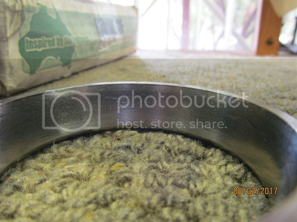

The smaller outer PB race is in much better condition.
IMG_1135_zps2el1f3mb.jpg~original
Another angle of the small race.
IMG_1136_zpstot75zya.jpg~original

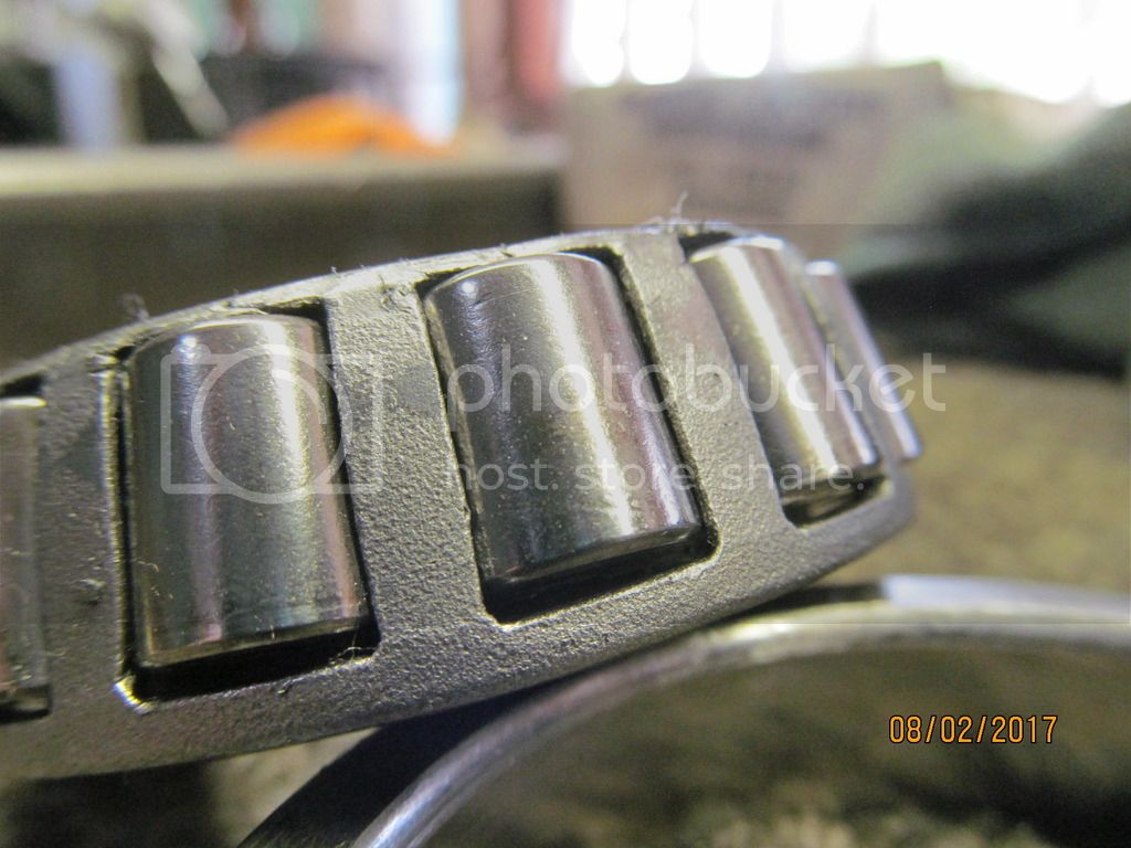

The tapered rollers on the small outer PB are in good condition.
If the driveshaft had been out of balance it would have destroyed the rollers with chunks
missing out of them and there would have been a large increase in pinion noise sounding
like a jet taking off but there was none of that happening per George so eliminate the
driveshaft as a possible cause.
IMG_1137_zpsiur8hclb.jpg~original
Another angle of the rollers.
IMG_1138_zpsp6jqviyv.jpg~original

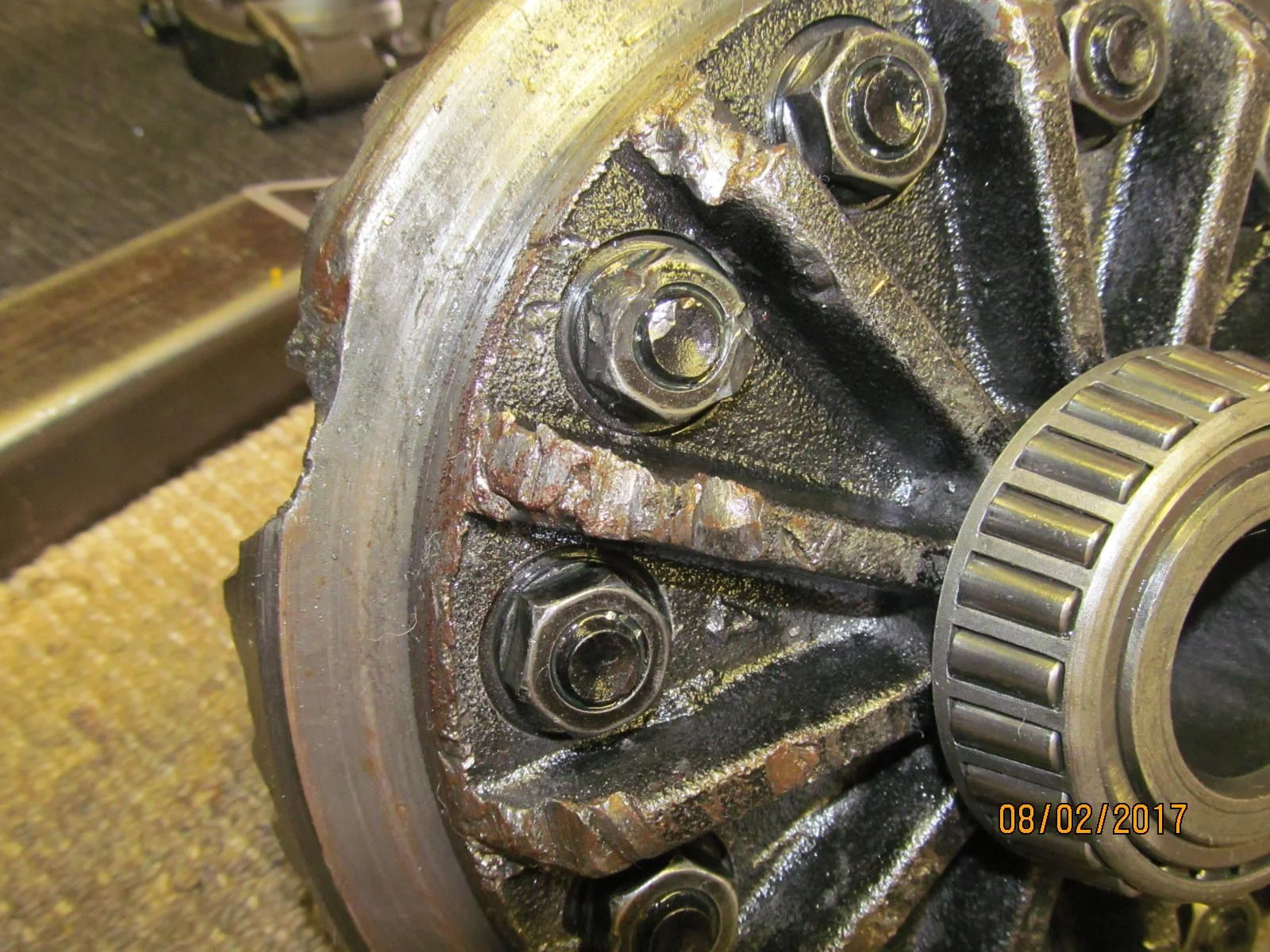

Somehow, the large sturdy inner pinion bearing exploded suddenly on George while he was on the on-ramp to the highway.
If somebody were to beat the bearing on with a chisel and hammer then it's very possible to crack the inner cone raceway
IMG_1124_zpsgrrggmjh.jpg~original
And, like a ticking time bomb, 3000 miles later it could look like this
IMG_1123_zps9f1u0oai.jpg~original

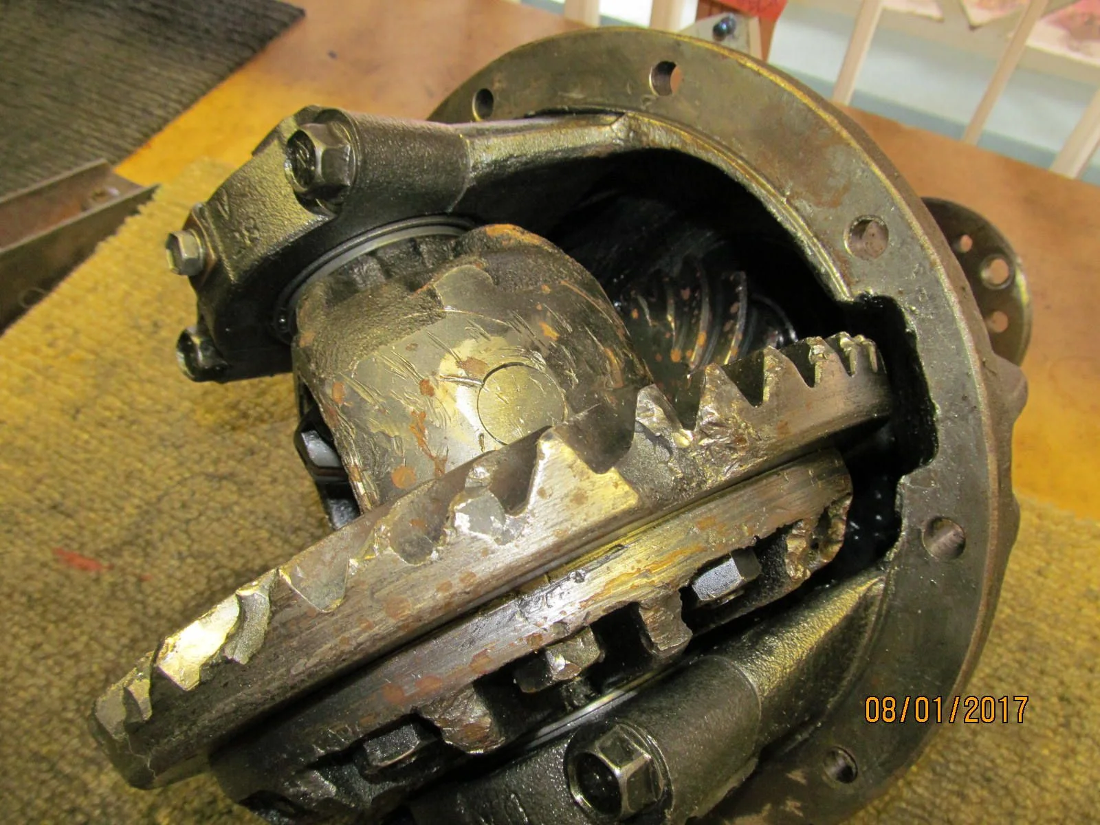

And cause other incidental damage like this.
IMG_1126_zpsu3kgmvfh.jpg~original

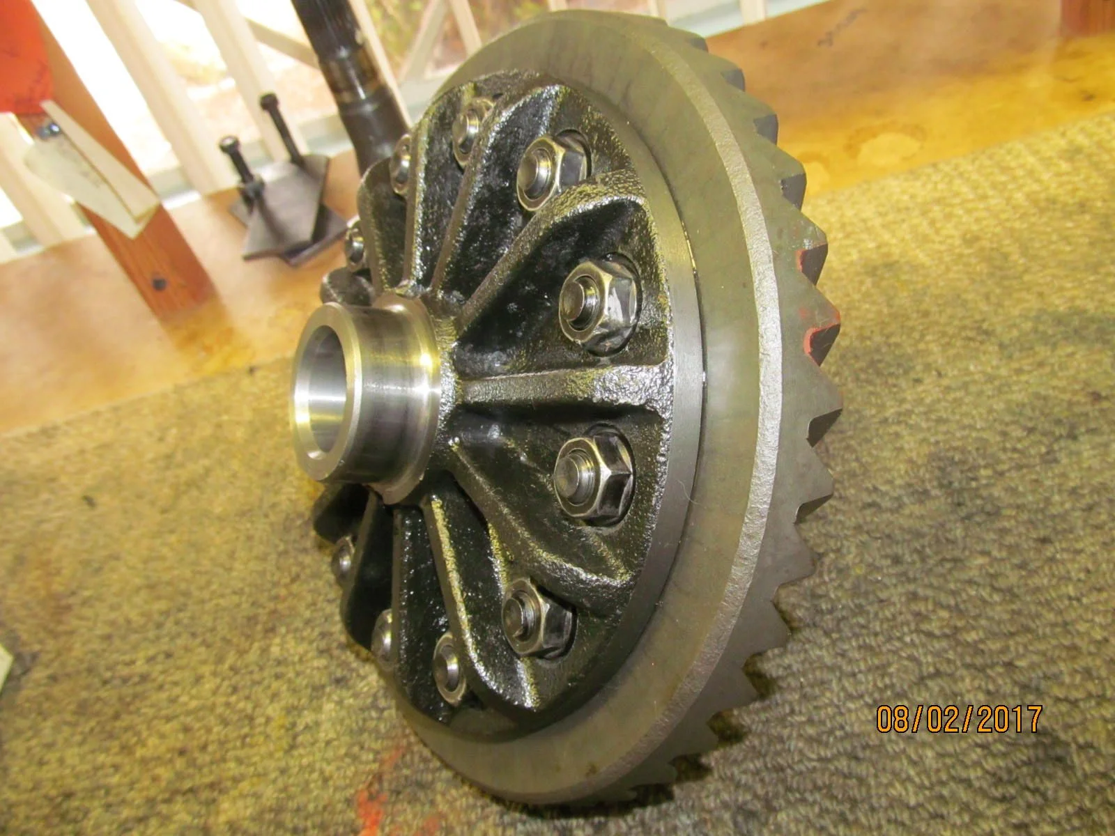

Anyways, here's the "widget" I made to get the big pinion bearing on. Made from old bearing pieces.....and the MIG.
It does the job.

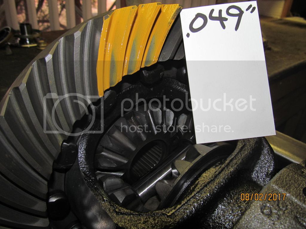

So using a starter shim of 049 this DRIVE pattern way to the toe and far too deep in the root.
IMG_1146_zpsr7wgup6n.jpg~original
Here's the coast
IMG_1147_zpsqk9ifddw.jpg~original

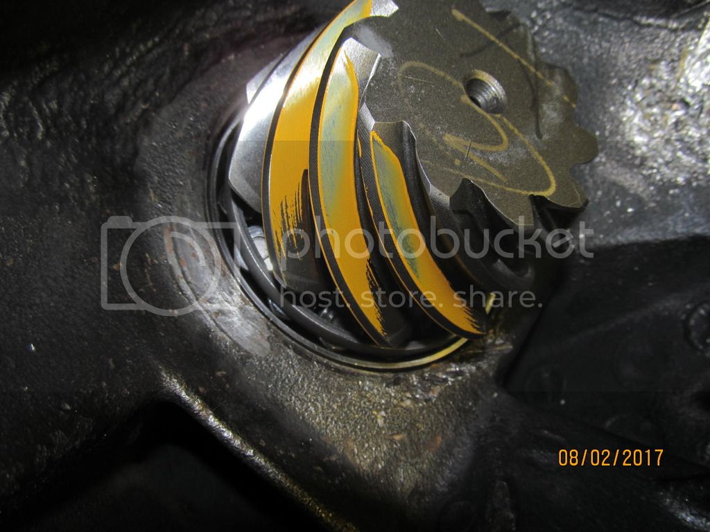

Here's the drive of the pinion....comet tail is hugging the face (top)of the tooth
IMG_1149_zpspkx4ypuo.jpg~original
