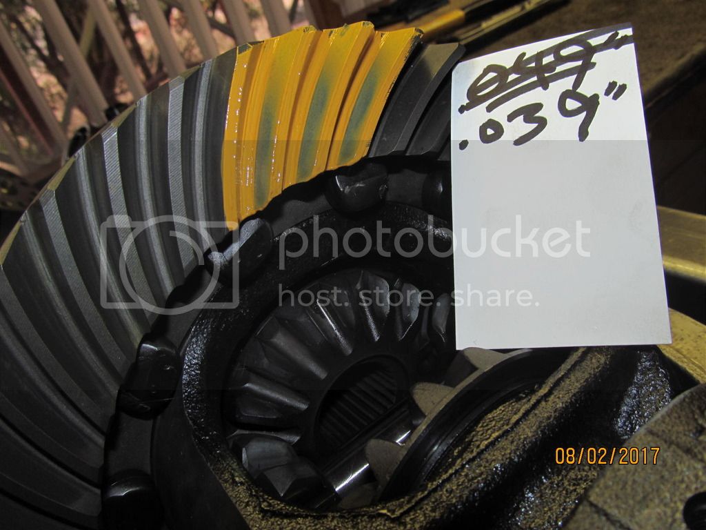

Made a BIG change in shim to 039. Much better. Still need to fine tune it.
This is the DRIVE side....still a touch too deep.

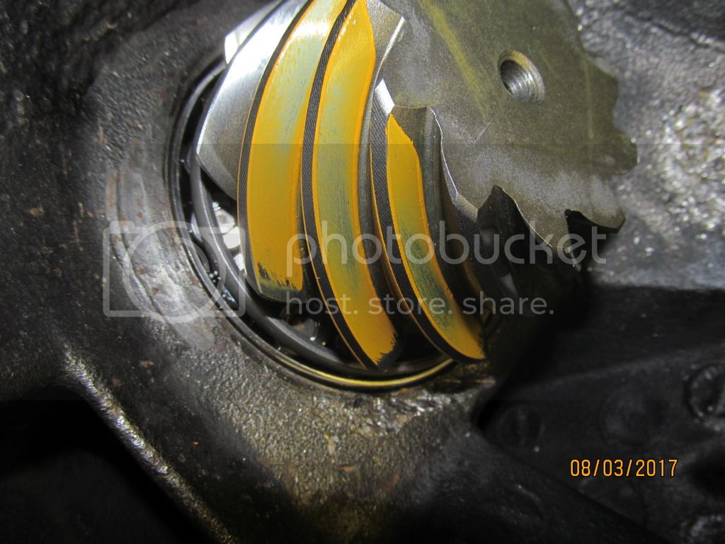

The Pinion tooth ....drive. Comet tail still a little to the face.
IMG_1153_zpsqpr9aubs.jpg~original

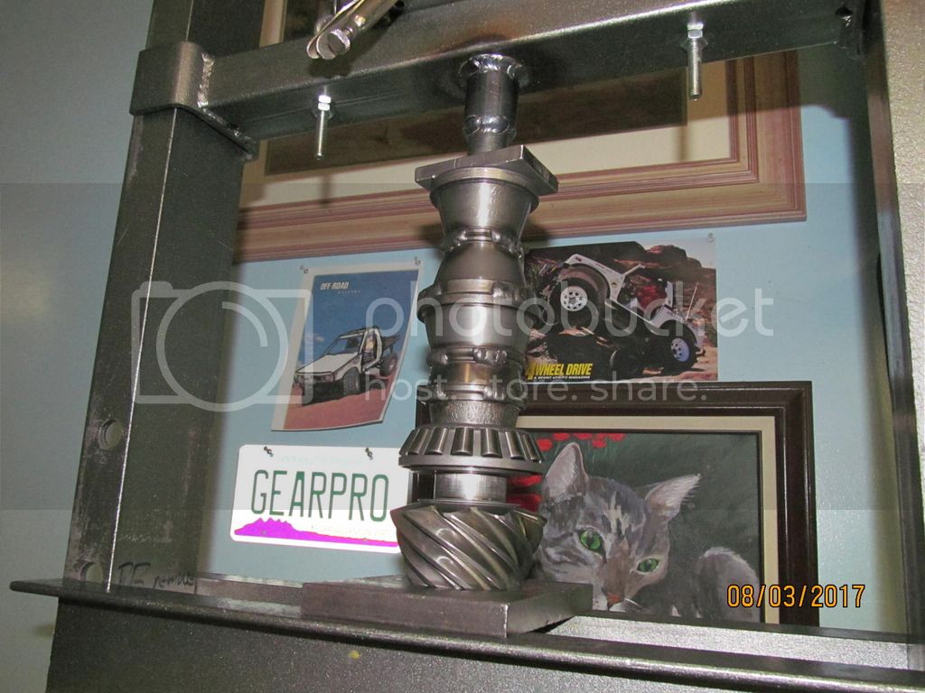

The humble tubular widget to press on the new carrier bearing....without any damage ;)

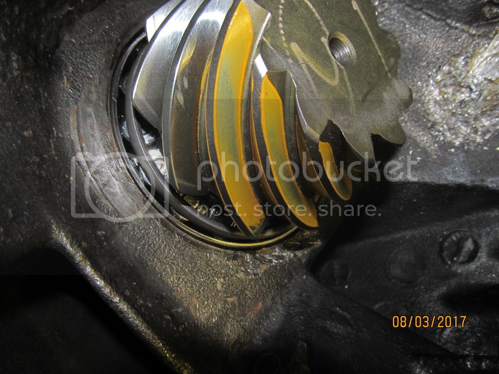

3 of the pinion teeth have some paint on them ....and they are voicing their opinions also.
They say (based on the comet tail in the center) that the depth is set just right.

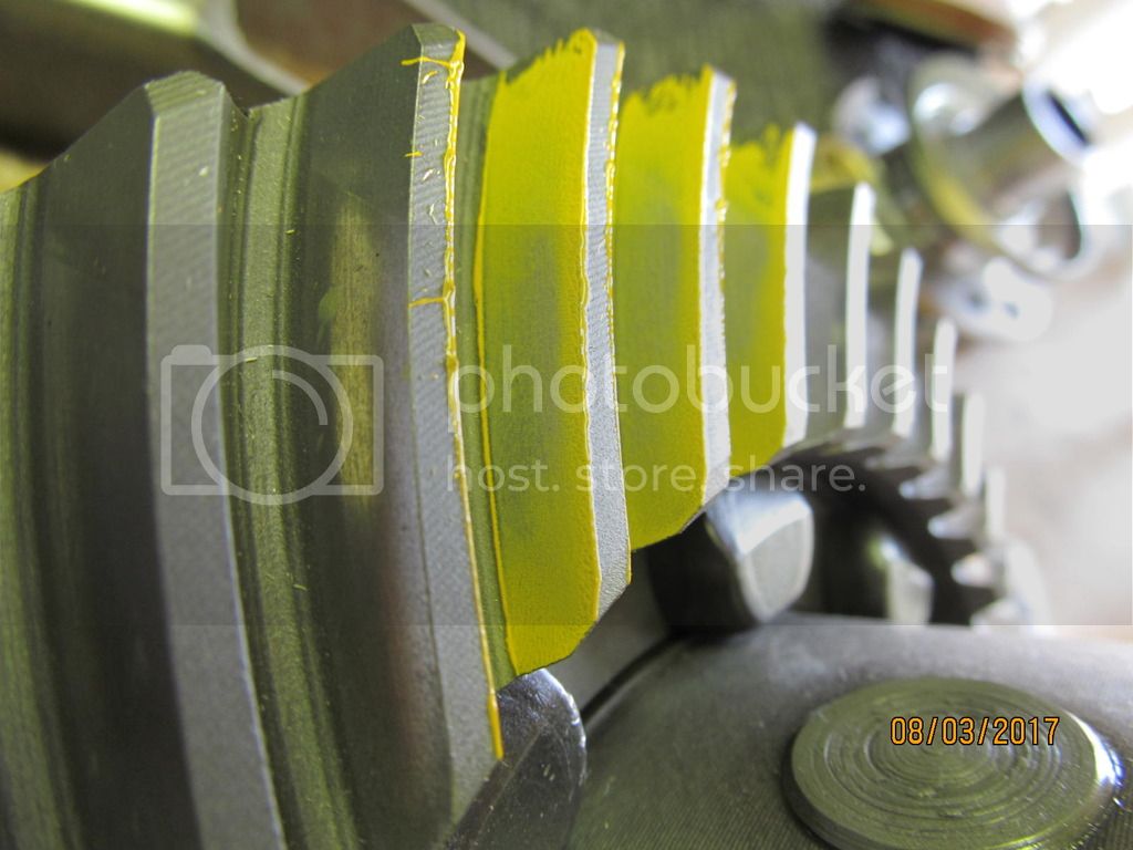

Here's the 2nd pinion tooth and it's quiet.....
IMG_1163_zpsvwmx51fh.jpg~original
Here's the 3rd tooth and I heard it say stop screwing around and put the crush sleeve in now.
