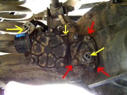

Lift the truck, remove the passenger rear wheel and inspect the wiring harness coming from the locker actuator to the front of the vehicle.
The wiring harness rubs againts the frame and damages the wires.
Inspect from the actuator all the way to the front of the muffler.
Mine was bad in two different sections.

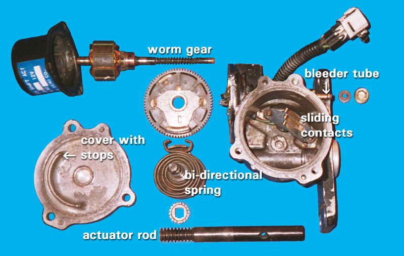

Also innspect the actuator, mine was seized, the bi-directional spring was seized to the cover.
i used this opportunity to service it, grease it and change my rear diff fluid.

I had this exact same issue on the '99 I just bought. Previous owner had never engaged the rear locker. All of the recommendations in this thread are excellent but I was not able to get mine to engage with the driving tips alone. I'm not very confident mechanically (yet) so I didn't want to tinker with this component. I took it to a 4x4 shop and they were able to get it working by disassembling, cleaning with brake cleaner, re-lubing, and reinstalling... basically what diego355 suggested. Cost me a few hundred dollars but I have a working locker now. Very relieved, as when I bought the car I thought I could just replace the locker with an ARB but that is NOT the case; you'd have to replace the whole rear end. Hope you've gotten it working!

On this topic, is it possible to pull the bi-directional spring assembly out, fiddle with it, and put it back in without synching it up somehow?
Because, a while back, I was fiddling with mine to see if it'd work (probably never touched in 20 years). I eventually got it to lock, but then it wouldn't unlock. I needed this truck to drive safely, and was kind of desperate to get it unlocked, so I started disassembling what I could to get it to unlock. Popped the cover off the bi-directional spring and just took the damn thing out (looked OK, no major corrosion internally), and drove around a while without it until it finally got unlocked on its own. I put the whole assembly back in just so it won't accidentally engage, and just never touched the rear locker for like a year.
Now I want to see if I can get it working, and afraid I may have messed it up by getting things misaligned. I finally tried turning locker back on, and just getting the blinking. Wondering if I need to synch up that wheel somehow to put proper tension on it, or if just driving around in gravel with switch on for long enough will just spin the motor enough to get it to line up on its own.
My 98 has this problem, just blinks. Tried the figure 8's etc to no avail. Instead of examining the wiring first I decided to remove that 3 hole cover and peak inside. Looks like it rolled out of the factory yesterday ! Problem is, like mentioned above I'm not sure how the spring goes back in and my manual isn't much help. Any special install tips here ? Thanks !
