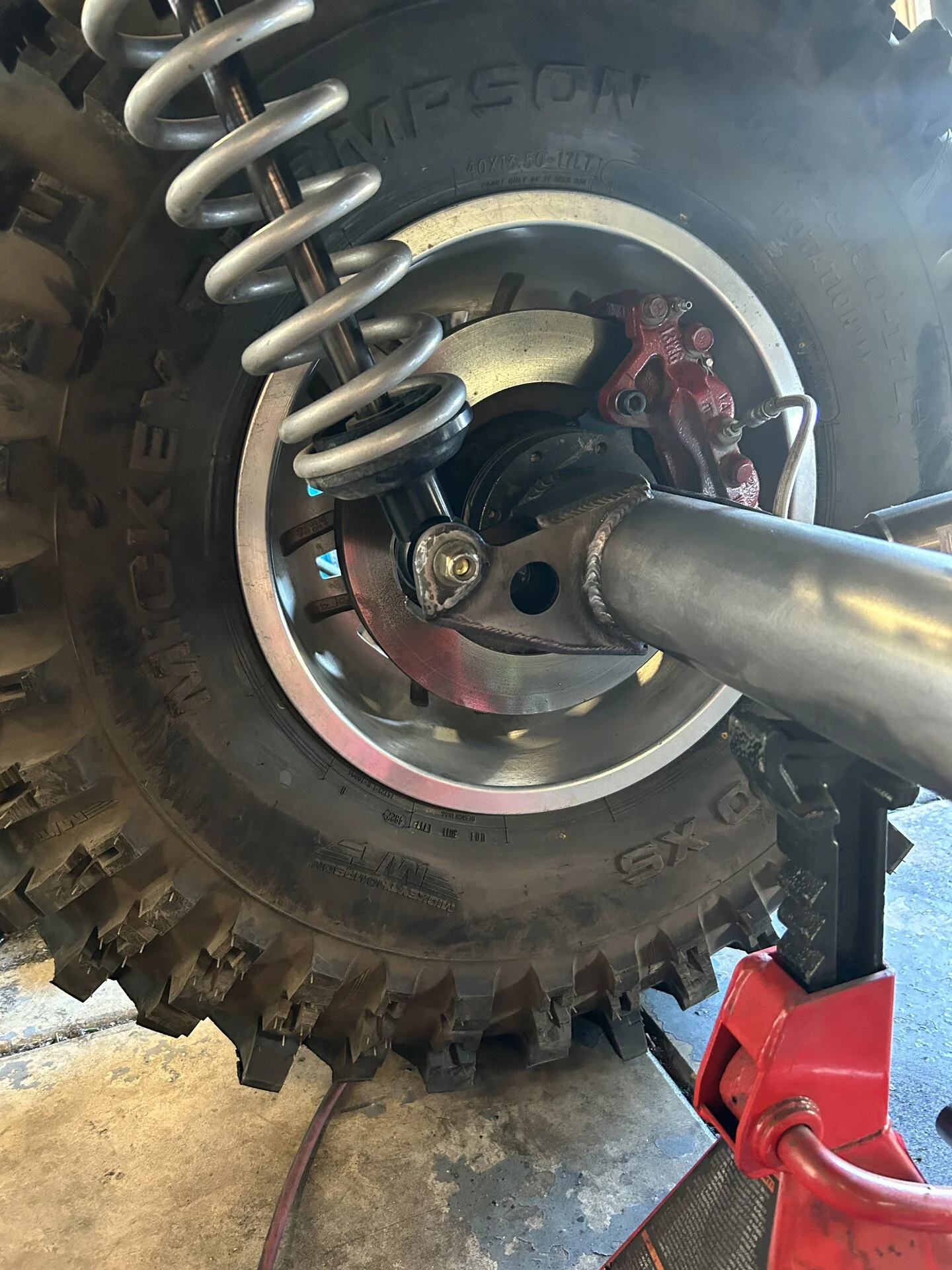

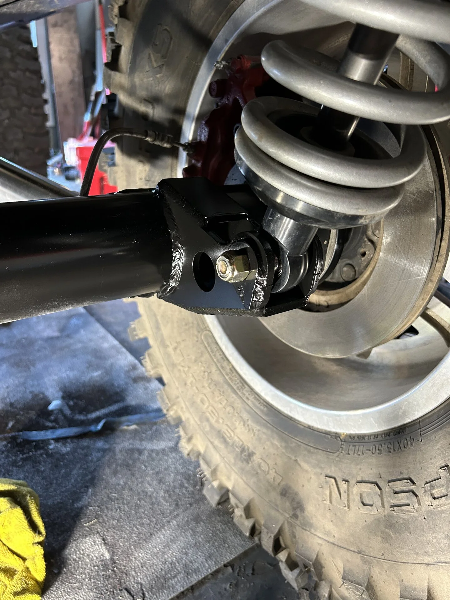

Inboard em and drop the coilover low on the axle. I'm running 12"s on mine, Much more is hard to package on a stock frame IMO.

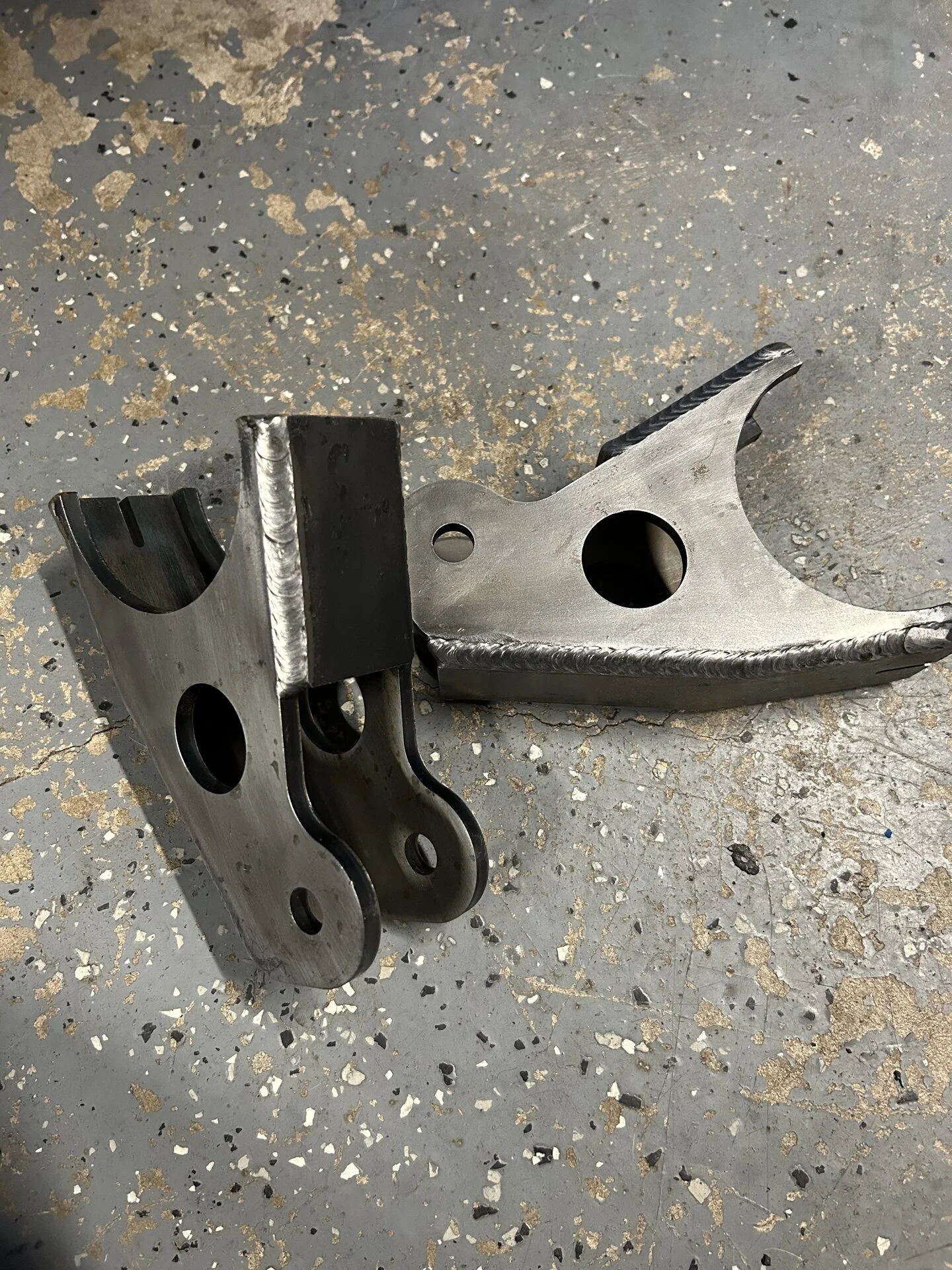

Do you have a low axle mount you like to use or do you just fab one?

Any chance you would be willing to share the cut file?
If I still have it I can. If not, I'd be happy to make another one quickly.

How I have mine
