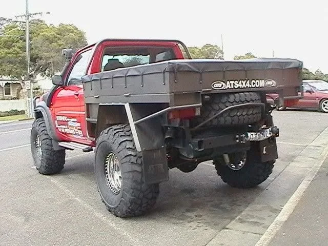

I pondered the same thing a long while back.
The only other thing I could think of would be a major undertaking, cutting out your rear cross member and making a new one below, mounting your spare so it slides in between the frame rails, and putting your extra fuel containers up high or else where, then building your bumper around it.
Kind of like this picture without the bar around it, and having the tire stick out a few inches more:
