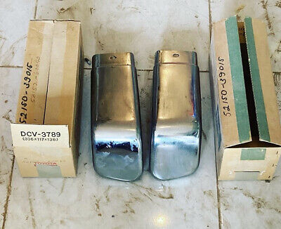

Wow, where do they find that stuff over there? I'm thinking it might be better for the body to make those ends out of plastic.
That guy has quite a bit of NOS 55 parts. He's quite proud of them unfortunately.
