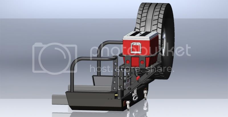

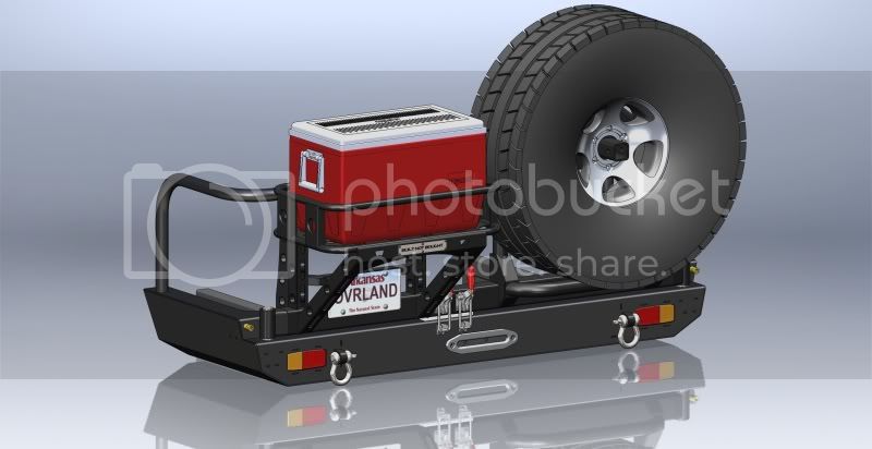

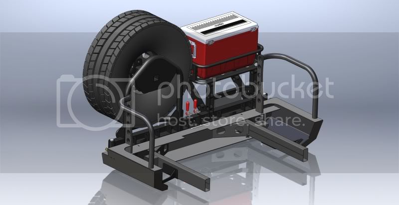

What does everyone think about this possible tail light/quarter guard? A bit mad max, but I think it fits. Maybe even incorporate some kind of storage solution into that quarter panel space??
Mad Max are not, that looks awesome!
My only concern would be the height of the extra side protection and that it anchors to a long flat piece. Seems like a bump on the top corner would push in fairly easily. Keep in mind this comes from someone who isn't skilled enought to grind your welds.
Nice bumper! Just a thought, have you thought of "ramping" the sides down to the main bumper so it's a little less "boxy" looking? (See line on picture below) Not sure, but just thinking it might fit the lines of the cruiser a little better. Don't get me wrong though, it already looks awesome.

Quarter panel bars have never been my cup of tea, but then again, I don't do stuff that serious to need them.
Your design of them does flow and fit well with the rest of the bumper though.
The slope cut on the corner is an interesting idea, not sure I have seen one like that.
Cosmetically I like it, functionally I dont think your applying strength in the areas you ll need it most.
If you end up using them to protect the vehicle, it will most likely be used to help slide around an obstacle like a branch, tree or rock. The force will want to push the bar towards the body obviously and having the plate near the tail light in the direction it is in you wont be getting strength in the way you need it most. Though it is hard to do with the limited space you have.
Ultimately it looks good, but Im suspect of its ability to perform as protection, too much leverage on a long piece of metal.
Maybe add a second lower bar and attach it again near the corner.
If your not planning on banging into rocks and large trees for whatever type of wheeling you do then its probably good. Hard to tell with the top end work of body armour and then big michelins how you plan to use it.

The quarter guard is a good idea. I could have used them a few times. The rear quarters are kinda vulnerable in the tight trees.
