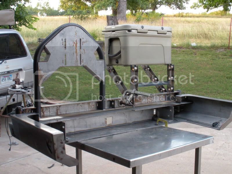

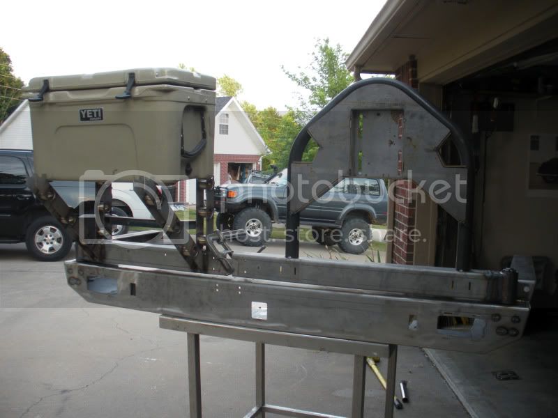

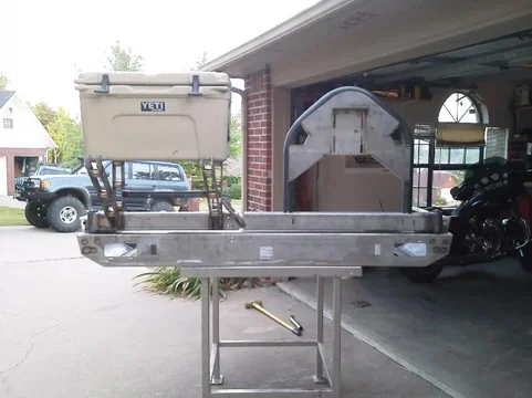

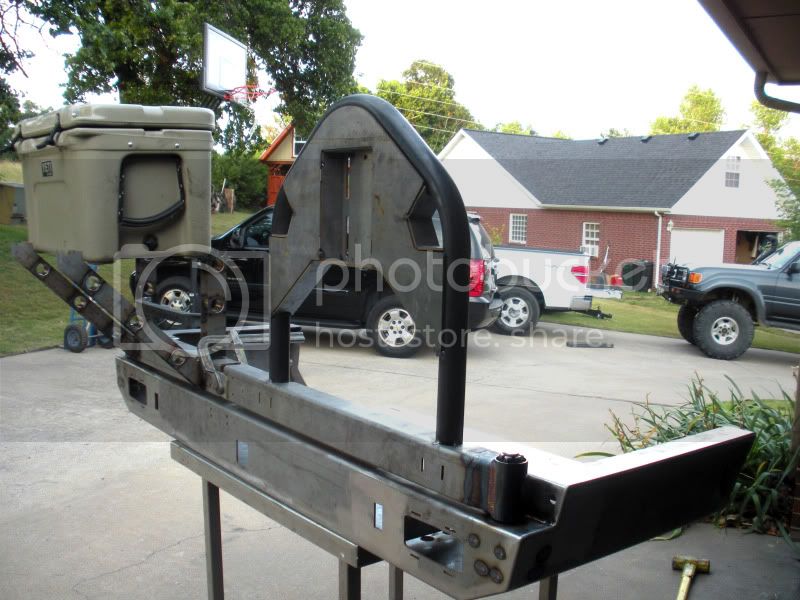

Tire carrier has been made adjustable. Waiting on the pieces for both swing-arms to be cut/formed!
Can't wait to see this all come together....
Carrier is adjustable to fit from a 33" tire, up to a true 39" tire (which is the tire size shown in my renderings).
The adjustment range allows the tire to sit on that lower bar. This will help distribute the load, and also keep the wheel/tire from vibrating or shaking.

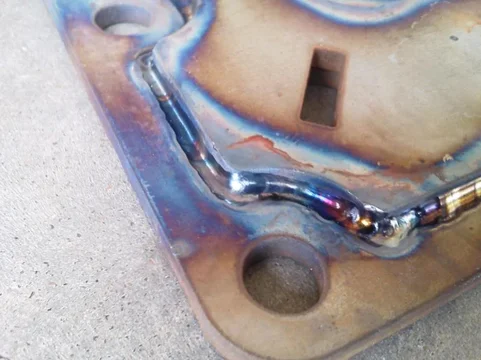

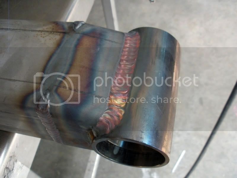

Think this piece got a little hot?
Sent from my C771 using IH8MUD

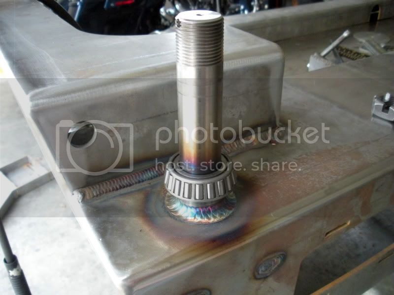

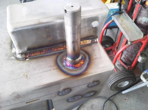

Well, I don't think that spindle is going to fall off...
Internally braced/boxed as well!
Nevermind. It was determined that if a big enough meteor were to hit the spindle, in just the right spot, it *could* break.
So, they got another pass.

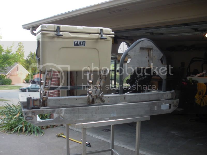

Getting there!

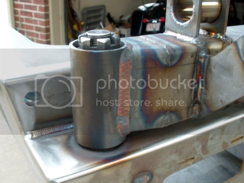

Delancy said:
Essentially, the base bumpers are all constructed in the same manner, and these appurtenances can be added to, right?
Correct. The internal gussets will be included with your bumper so that later on you can add spindles and any type of swing arm setup.
I like the spare carrier design. I bet there's very little deflection possible on any terrain.

That is some of the nicest welding I have ever seen.
No doubt. Hoping for a front to match the quality.
Thanks, the tire carrier will be very stout. Shouldn't move or wiggle at all with the tire resting on the bottom piece of tubing. The whole bumper is pretty overkill, but that's ok. We like overkill.

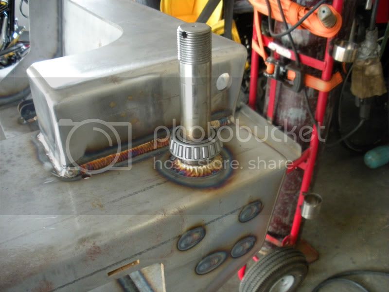

Better pics from yesterday:
Some beefy new spindles! These things are SMOOTH....

He should change his forum name to StainlessDavinci,just sayin':clap: :beer:
Hell, I can't even run the flap disk that well.
