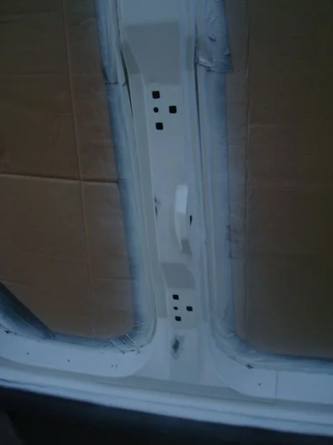

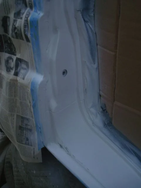

After sandblasting the door jam I found 4 or 5 cracks around the hinge area. Looked like the ones we are all familiar with on the doors. I am beginning to more fully understand why my doors would RATTLE.
Although the jams look killer with the primer, in the right light you can see all sorts of stuff that makes me frown. I guess that I have to do some more sanding. :crybaby:
Today as I was sandblasting I had to keep repeating "door latch project not a paint job."door latch project not a paint job."door latch project not a paint job." It is so addictive to see that just sandblasted grey metal. It holds so much promise.

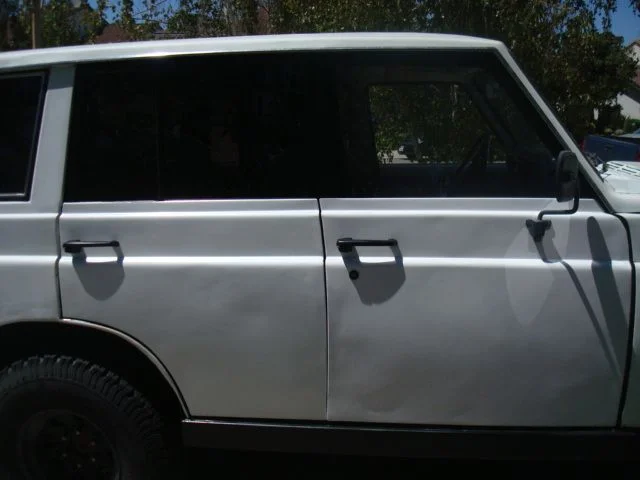

So I finishing the painting on the rear doors. I have the garage door up and have this sheet over the painted white bottom half. I am happy with it! I have masked it all off and have started painting the window frame. First coat down, wait 15mins and the paint again. Am on the last coat, 4 in, and a breeze sweeps in lifts the sheet up and into my freshly painted surface.
At this point I just laugh. That's two days to wait to dry. Then have to resand and paint again, and wait two three days to tatally dry.
I guess it really dosn't matter. I have sent all the hinge bolts and washers in to get basted and the a black zinc coating on them. Have not gotten them back yet. Patience.

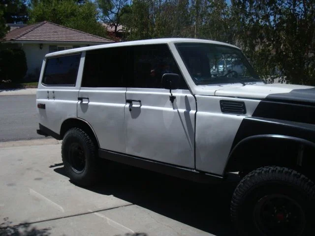

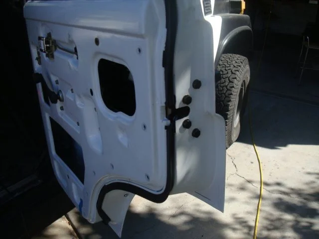

Hung all the doors so that they worked with the new latches. How do you all do it- the paint was sooooo sexy(at least to me) and now there at least 4 or five spots that have been nicked and scrapped. It was almost impossible to do without the gouges. I guess that will be one of the button-up parts of the project.

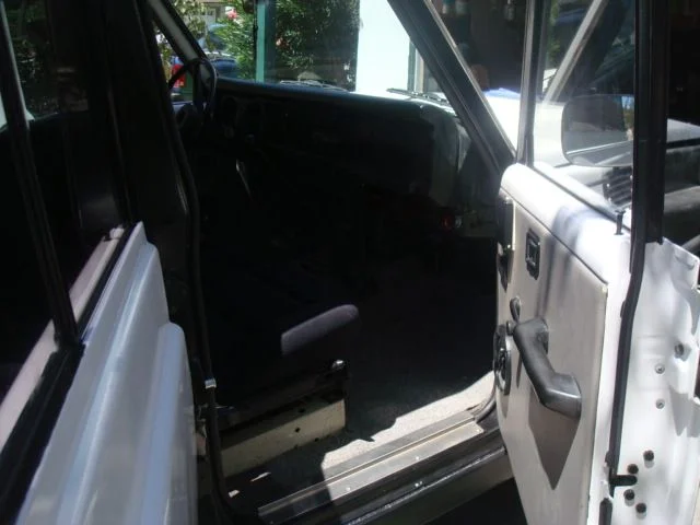

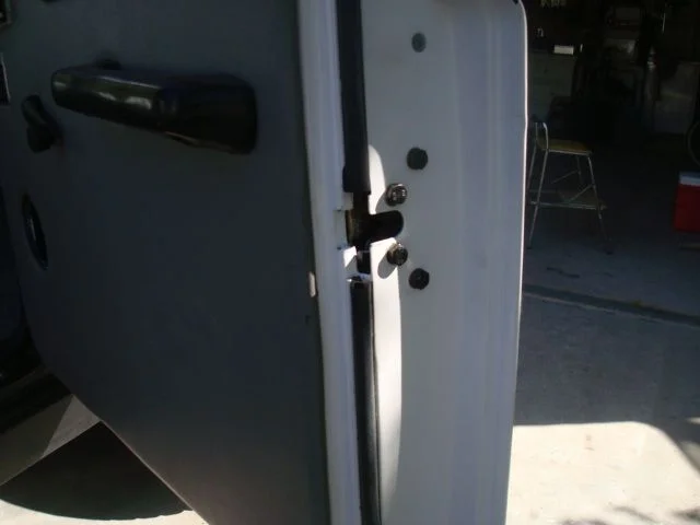

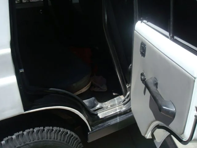

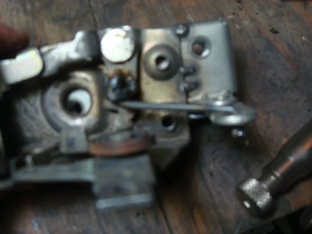

The latch linkages turned out cool. They all work. I ended up using a sleeve type deal that would allow the posts to self adjust. The stroke of the Toyota part was longer than the stroke of the bear claw part. First cut out the star wheel and outside star latch and housing, weld to the bear jaw and then... pics
The 4th pic is the front which had a lot more room to work in, while the rest were the rear which was more tight.
Now the fronts seem to have fit in and all the interior door linkages worked simply. Just hooked them right in. The rear will require me to shorten. Measuring will be required. Not my strong suit.

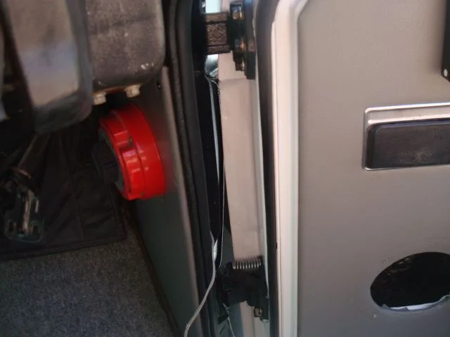

After putting in the glass and all the other stuff in I had four doors (couple days three doors) all done and good...enough. The driverside was always the ruffest. Then it started not fully engaging the jaws of the latch. Side note- my garage has been cleaned up and tidy for a week or so- so nice, even thinking of getting a ping pong table. So after some time and wrenching I found out that it must be binding in the little arm thing that I had made.
linkage7-jpg.922383
linksge2-jpg.922384
Redesigned.
Now I am now trying to weld on a new tab, in a new orientation, and I can't get penetration on the gold colored Toyota metal. I am trying to do two tacks on a 90dergee corner. My tab is attached perpendicular to the Toyota latch metal. The weld is nice on my little piece of metal but almost balls up on the other. I tried concentrating more heat on the Toyota metal but to no avail. I was hoping for better results. :crybaby:
Don't get it!
Any help from the welding masters???!!!!!
