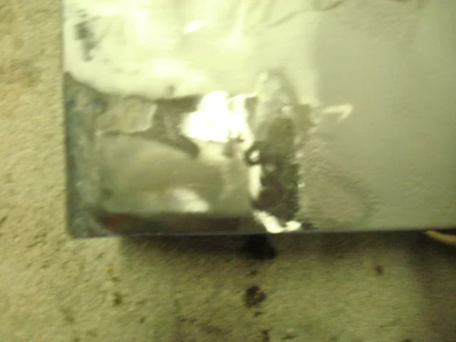

Went to a guy that I wanted to do some dent removal on the doors and found out that the outside skin had been sandblasted and was all stretched out :(, hence if you leaned up against the door it would it would pop in and stay there. I would need to pull of the inner door panel to push it back out. He says that it need to be shrunk back. Didn't know anything about stuff like that!

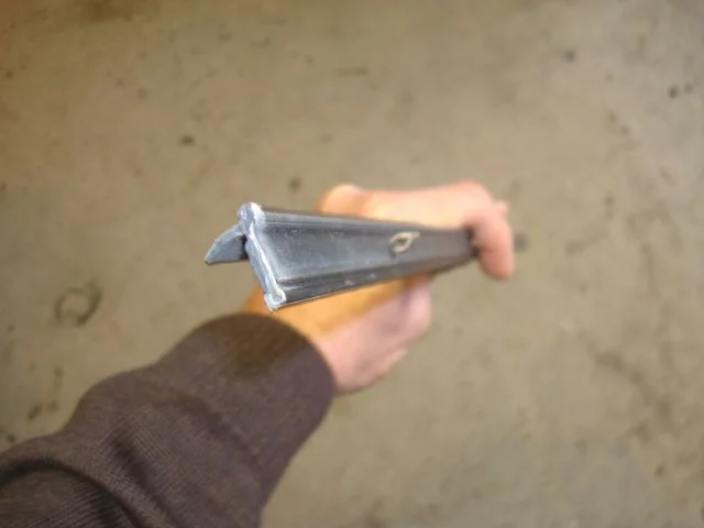

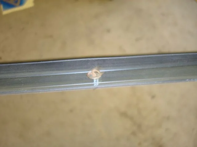

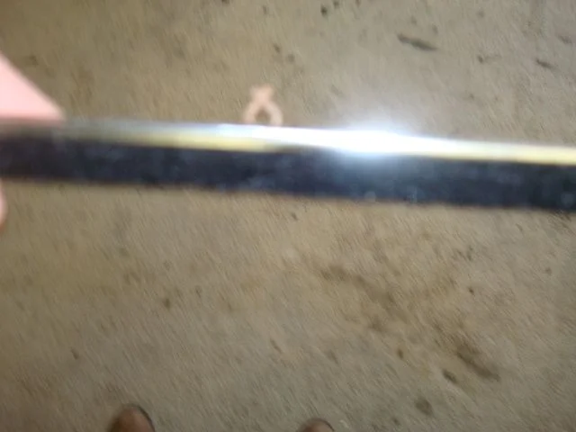

In the meantime while I figure out what to do with that dilemma I started getting the felt and squeegee made up. Not too bad and looks pretty good. On the felt- I peeled up the felt, put in the clips and the glued the felt back down. It came up pretty easily from the silver side and then after applying the glue I restuffed it back under the silver crease.

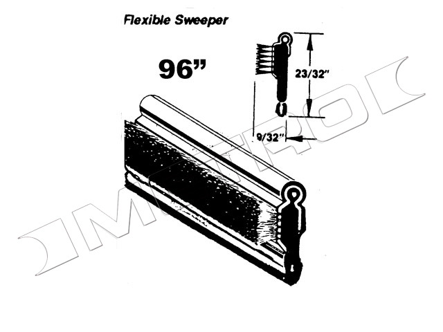

Turns out that the felt I had gotten was too short. The top silver bead landed about a 1/4" below the top edge of the window. I got another one coming to try out hopefully it will be better. Its coming from metro molded parts. The number is wc 4-96. <a href="http://metrommp.com/productimages/640/WC496.jpg" target="_blank">

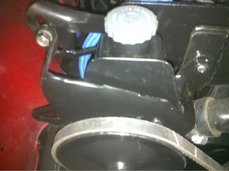

7511 is the Scout steering box # the sag pump I got from the parts store. Just ask for a pump for a 76 Chey 1/2 ton PU . Works good.

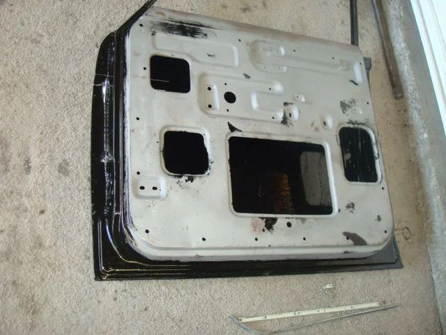

Oh my gosh! It took a month to get the work done! I didn't really mind cause I could go down and check out the artistry of his work on some pretty amazing vehicles.

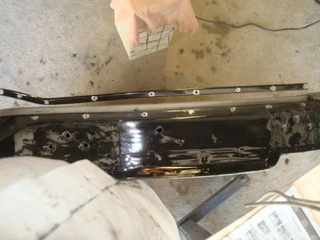

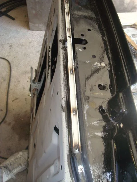

So I got them back and now - Inside and some of the outside Por15'ed.
Finished the felts and squegees

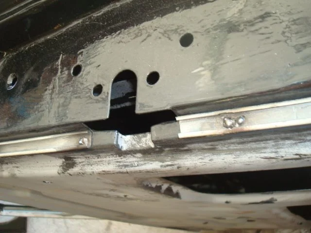

Welded the door seal rubber channels in
So many little things left. Gonna hang them to see if they still fit right. Then it's on to the bondo and paint, dynamat type deadener, box out the body side of the latch, paint, fix the window regulators, and complete the Bear Claw linkages and whatever else comes up. Then I gotta take this thing out wheeling!!!
