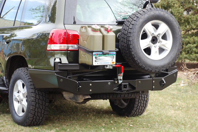

Fwiw I believe this is the Slee prototype:
That looks a little busy to me, but hard to tell. Thinking that was a one-time custom for that green cruiser they have photos of...
From this photo, it looks like the swing-outs are entirely separate from the main bumper...which is GREAT. ARB's seem a little flimsy because part of the bumper surface swings out with the tire. This photo you post looks like the main bumper never moves.
I really like this jerry can mount. -Seems silly that ARB provides space for only a SINGLE can. I would want at least 2...preferably 3..
No matter what, it seems that the 200 available always look like saggy diapers in back...which is why I love the design Willy runs on his. Seems to have far less droop in back.
That was a one off years ago he did for a specific customer. I believe they are coming up with a whole new design.
Copy that but I'd expect something similar with the higher mount carrier pivot. Knowing Slee, I'm sure it will look great.

OK, here it is from the horses ass. We are fully committed to do a 200 series rear bumper. This is where we are now. The 200 is a bitch to work with due to the high side plastic cladding, but more so the lack of available attachment holes on the back frame pieces. As always, we are not going to put out completion dates until the first batch is being run as production parts. Also no pricing at this point and we are not taking any money or deposits.
We have a ton of items to sort out to do this bumper. We also have a ton of info from customer on what they do and don't like about all our other bumpers that we make, so that will be taken into account as well.
The green truck was 7 years ago and it was a one off. Not sure how much of that will translate to what we are going to do now.
