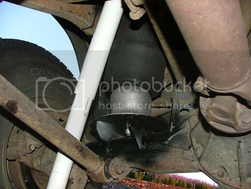

Rear Coils swapped for Air Springs.
For the last few months my rear end has been getting lower and lower. With full load it´s been sitting on the bump stops. I have been dreaming about converting to air springs for a while and last weekend I finally got me into it.
The main reason I wanted to use Air Springs is because I use my truck as a daily driver, then I usually drive a empty truck. But in the weekends I use the cruiser for travelling. Mostly with a truck full of friends and luggages, often with a bike rack with four mountain bikes in the trailer hitch.
Because of this great difference in cargo load, and still wanting a comfy ride both empty and with all the extra weight I´m sure air springs with in-cab control are the best option.
Now I have been driving for three days and I love it.

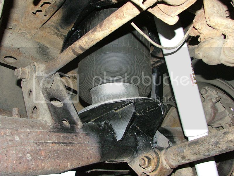

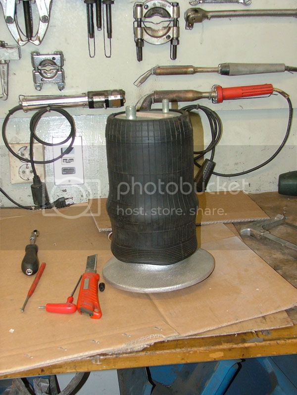

I used Good-Year 1R8-009 spring and Gabriel gas shocks. The shocks I´m using are made for Ford Escape. Whit air suspension you really want soft shocks, first I tries OME shocks but they were far too hard.

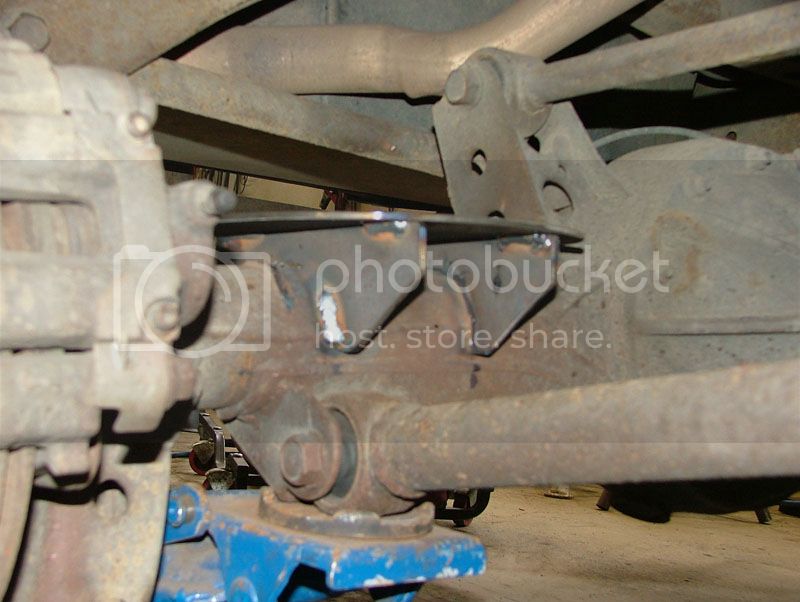

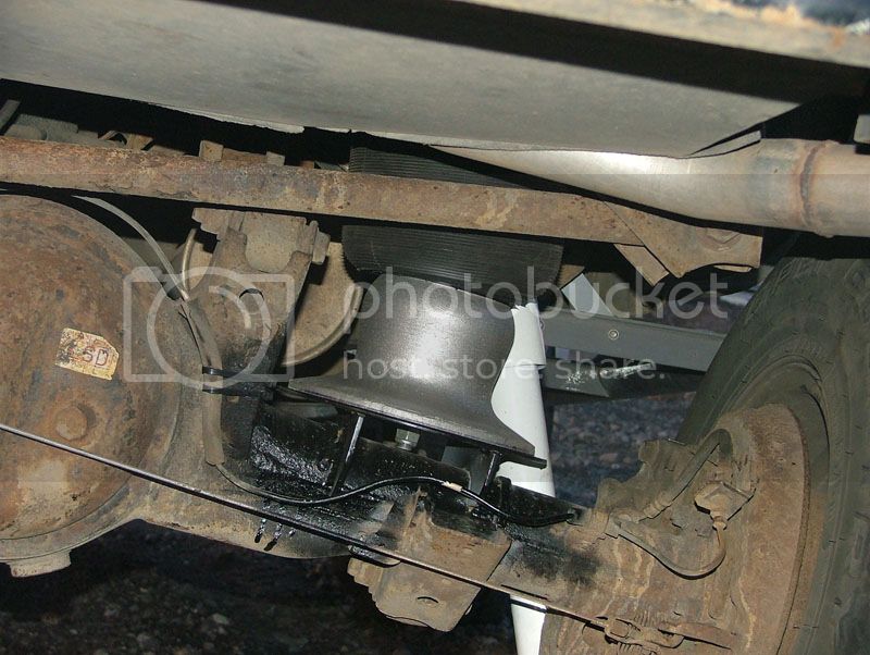

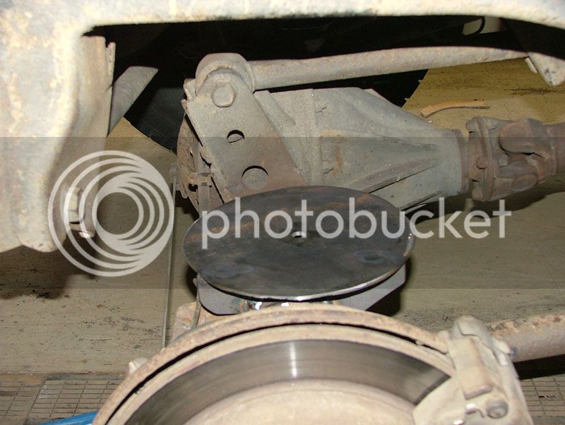

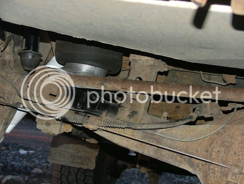

To make space for the Air Springs I had to cut all the tower that holds the Coil spring and the lower bracket off the axle as well. Then I had to make new flat surface in frame to hold the spring and make room for me to fit the bolts that hold the spring in place and the air fittings between the frame and the body. The hardest part of this mod is to rebuild the coil "cup" in the frame to fit the Air Spring.

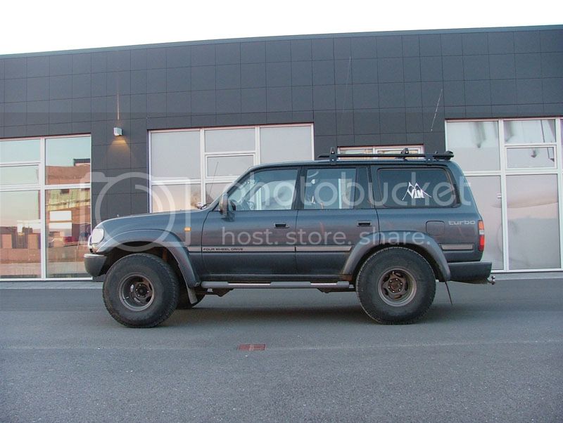

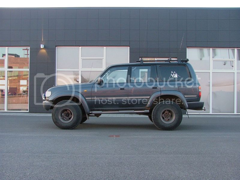

Normal driving hight with 40psi in the springs, I´m thinking about adding spacers to lift the front end a bit. The front springs are getting too soft as well. Hopefully I will replace them with Air Springs someday.
In lowest position.

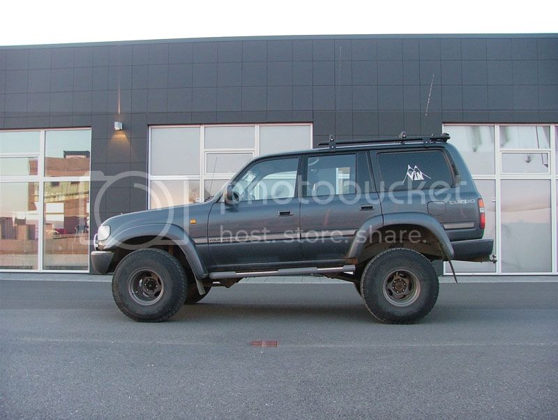

With 80 psi in the springs.

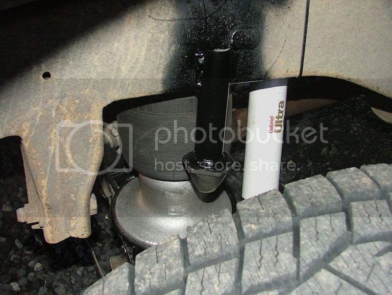

These small bump stops are to make sure the tires don´t hit the fender if I lose the air pressure.

in the lowest setting, is it sitting on the bump stop?

In the lowest pic. the truck is not sitting on the bumpstops, they are a bit lover. I would not drive the truck that low, but it might come handy to be able to lower it that much for attaching trailers or loading stuff in the back.
They are filled individually, there is a meter and two switches in the dashboard, I have just hooked them up (dont have the time this week to install them properly).
I dont think it is possible to keep the retain the stock spring perches in place without lifting the truck sky high. The air springs need at least 32-35 cm (12,6-13,8 inches) as a normal hight to work properly according to the dealer.
The dealer also told me that the springs would work best with 40-50 psi pressure, in the normal driving hight I have 40 psi, and then the truck is nice and soft. If I lower the pressure, it becomes to soft. In the highest position in the pic the springs are very hard and uncomfortable but adding extra air might be useful offroading and to lift the rear end while crossing rivers though I would not drive for long like this.

this is way cool. you could adjust height and feel on the fly. groovy. did you have to do a check on the axles after welding the modified spring supports?

This has held up quite nicely, I never did the front though. This has been completly trouble free. The only thing I have thought about adding to the system is a automatic hight control valves. There is always a little air leakage so I have to add a little air every few days.
It would also be nice to have the automatic valves to keep the truck automatically in same hight if I load it or unload. But still I haven´t done it, it is easy to do all that manually ;)
The suspension is very nice, I just have to remember to have enough pressure in them, if it is to low the truck gets very soft and sways to much and hits the bump stops.
The more load I have in the car the suspension just gets better and better ;)
I love to be able to lover the back when I arrive at the campsite (to make unloading it much more comfortable) and when hooking up trailers.
I have no regrets at all of doing this mod.
