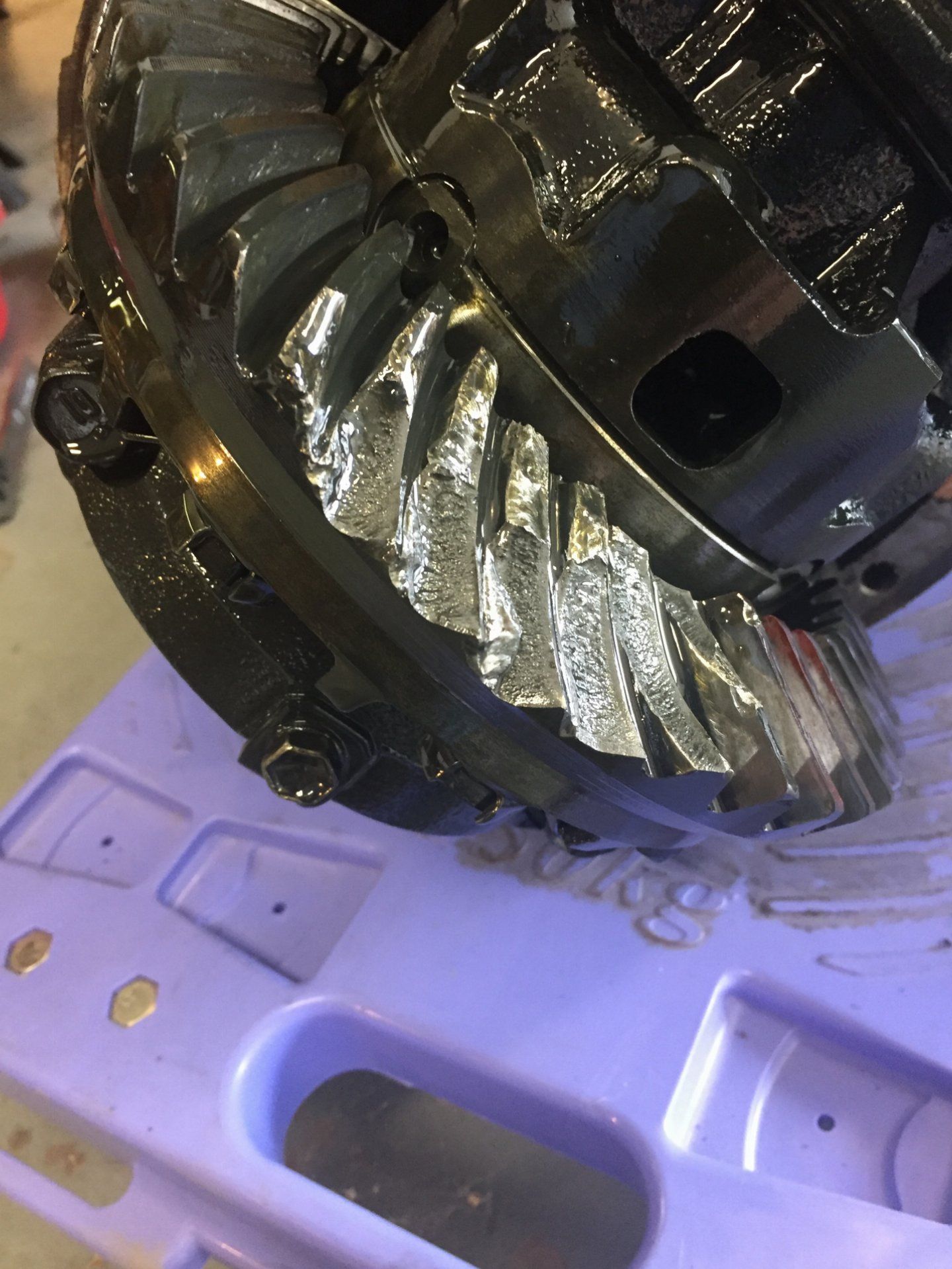

Well, here it is , OUCH !!! now on its way to ZUK !!!
