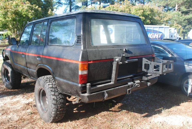

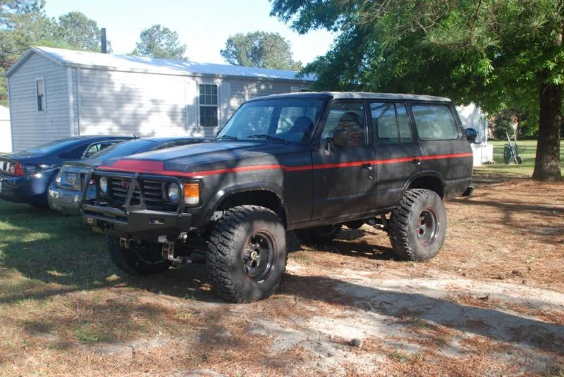

Still working
Still getting things done but one step at a time followed by lots of time. But she's running and I'm going to GSMTR hell or high water. Sliders are not on and the skid plate is still off and the roof rack winch and most of the ionterior mods still to go, but I amgoing to GSMTR in this:
Still roughf but running thanks for all the good wishes and hope to see ya at GSMTR:bounce::steer::cheers:
Aaaaaaaaaaaaaand he's back! Truck is looking great doc!
