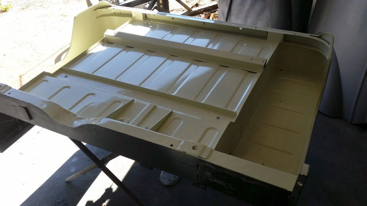

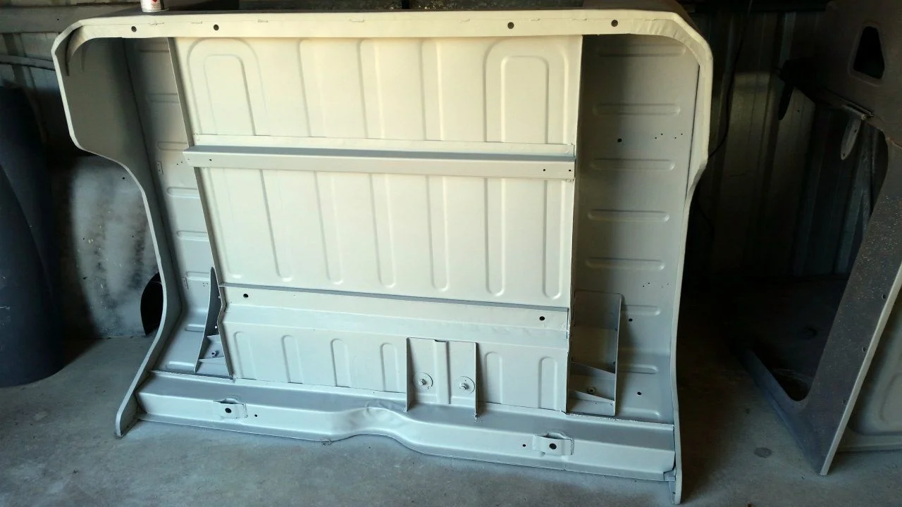

you did an amazing job straightening the floor. I checked the before pic. Al the dents are gone. excellent!
edit: the floor isnt new right? or is it? didnt look that bad that it needed replacement?

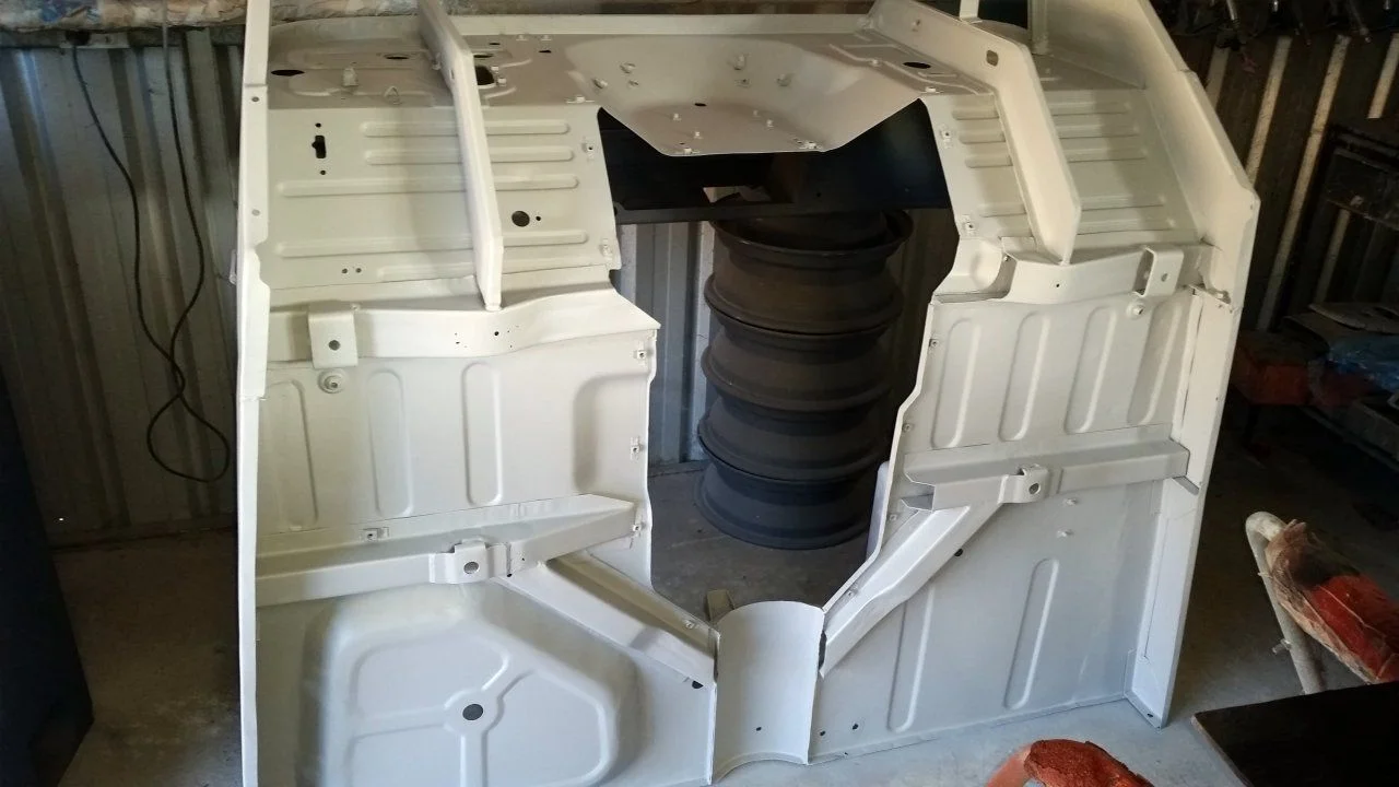

Replaced the Rear Floor, Mid Floor and recess under Drivers Seat. A new Rear Sill was fabricated and major repairs to the Wheel wells and Rear Quarters.
Used Real Steel replacement Panels.
Great job on the tub.... Looks superb!

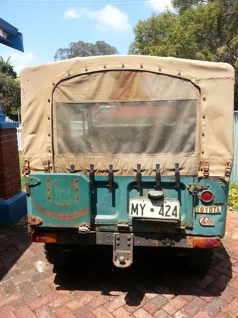

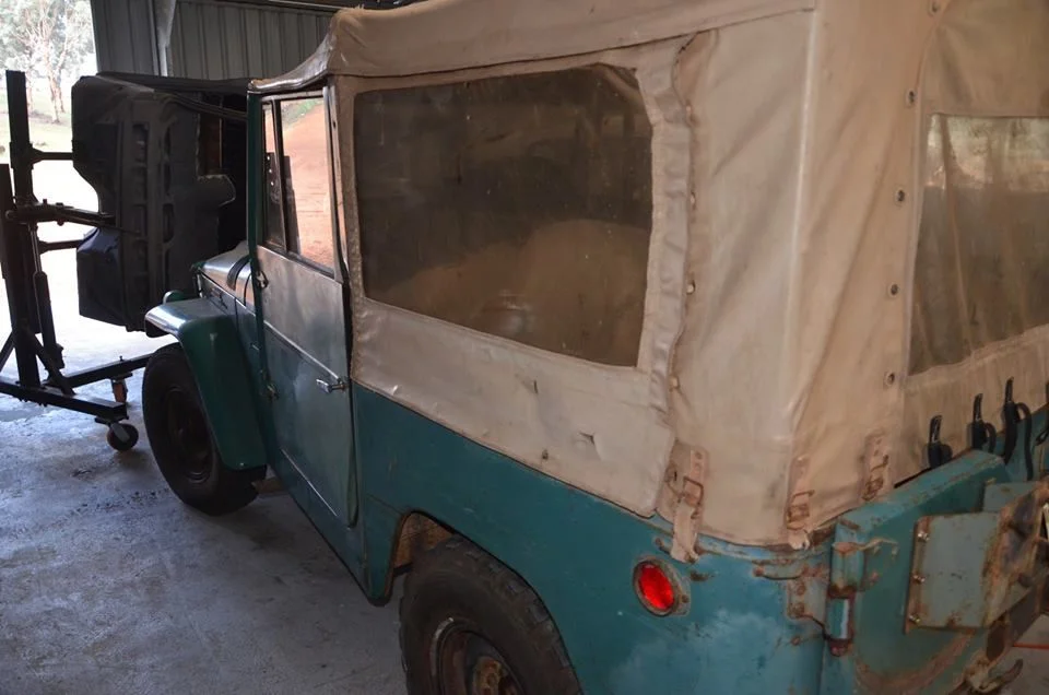

Andy ... Were you planning on using the oem top again?
You got it safely stored away right... If it's possible I'd love to see detailed pictures of the top... Now that it is off ... But... When you take it out no rush
Yes it is stored away.
The plan is to use it as the template /pattern for a new one.
I'll get Photo's of it for you some time soon.
What specific Photo's did you want?
