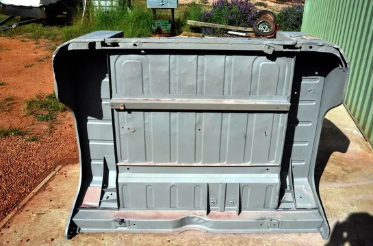

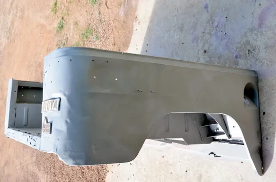

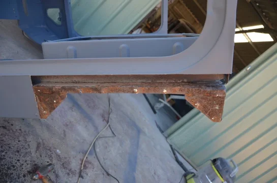

Body back from the Sandblasters. A few more surprises than I anticipated!!
Rear Floor and Mid Floor in a sad state, as is the Floor under the Drivers Seat.
LHS Sill repaired so far. Much to do.

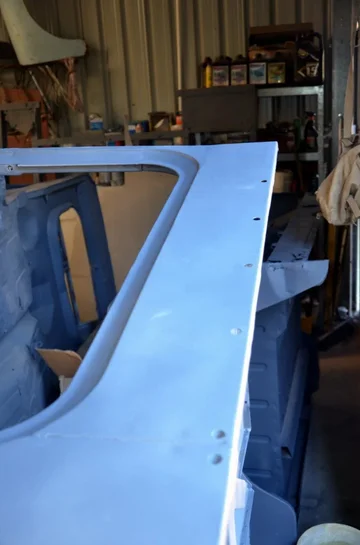

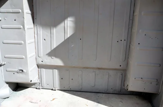

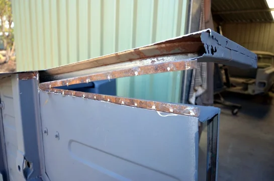

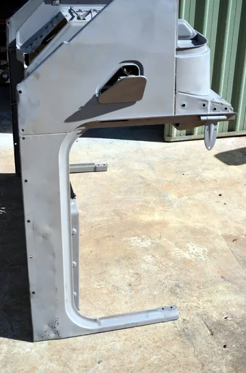

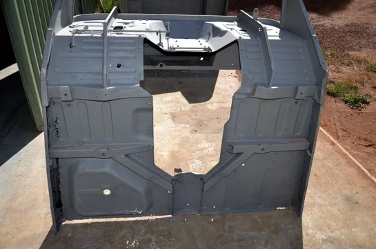

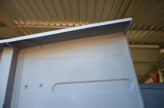

Front Half of Body nearly completed.
Fabrication of new floor to door panel edge piece. New lower door panel skin, new back edge to drivers side floor, reworked and reshaped the new under tank floor and also fabricated a couple of new braces as per original. These have all been welded in and the door panel refitted and spot welded to floor and bulkhead. All exposed areas spot rust treated and etch primed. All new metal etch primed as well and all welds ground back.
