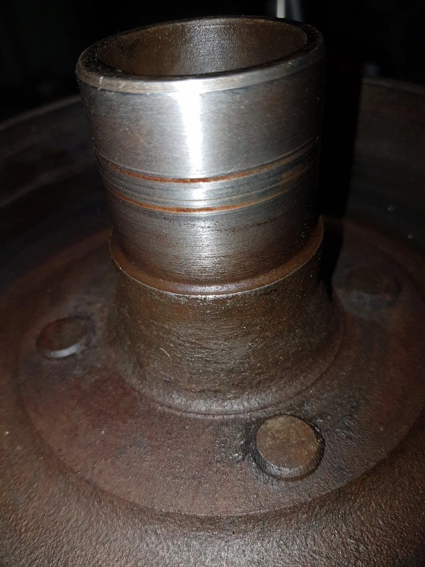

I would use a speedi sleeve but you need to fill the grove so the sleeve and seal doesn't run hot. My mate has success cutting the seal down in height so it runs on a clean spot but I have never tried this fix.

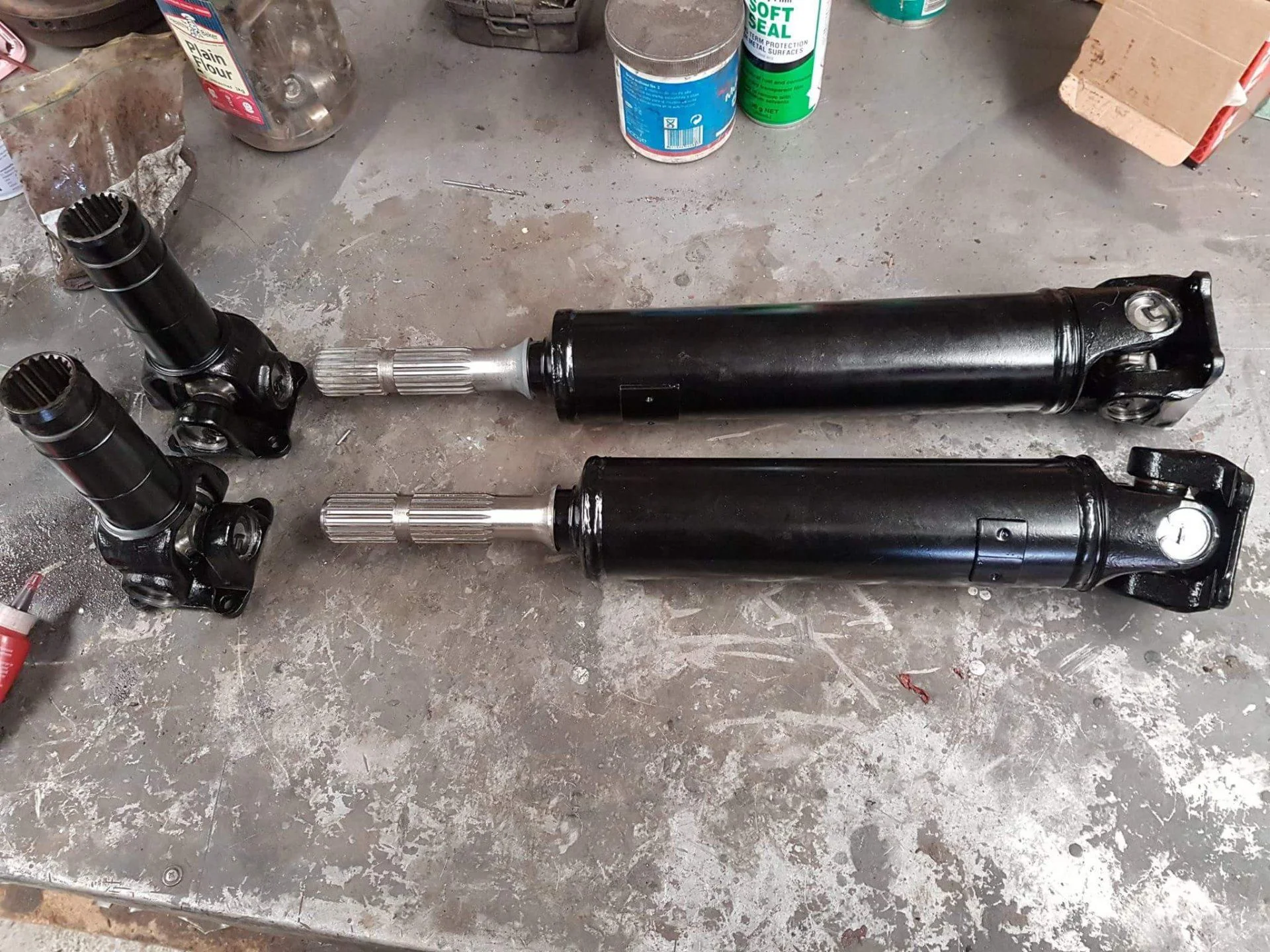

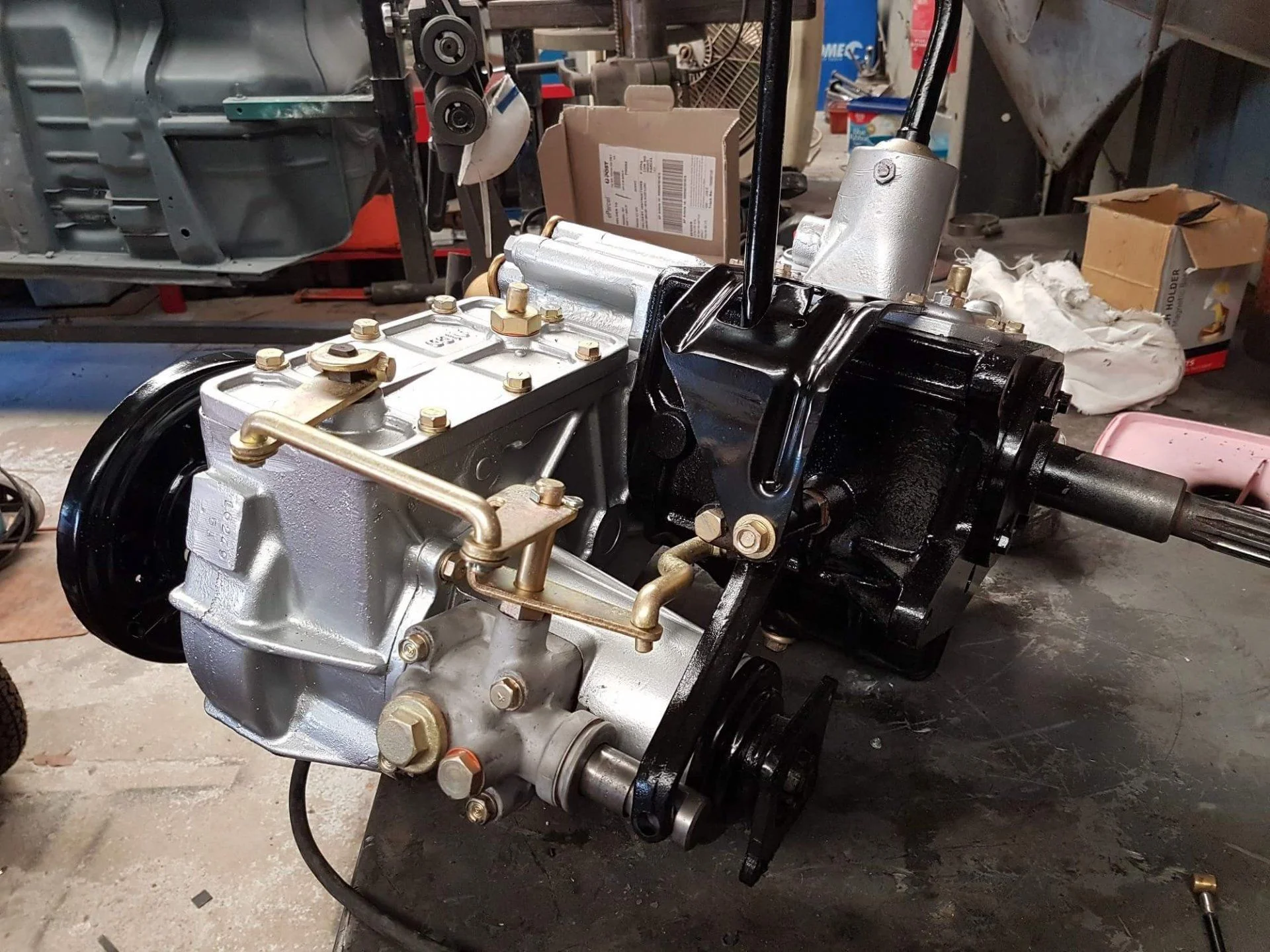

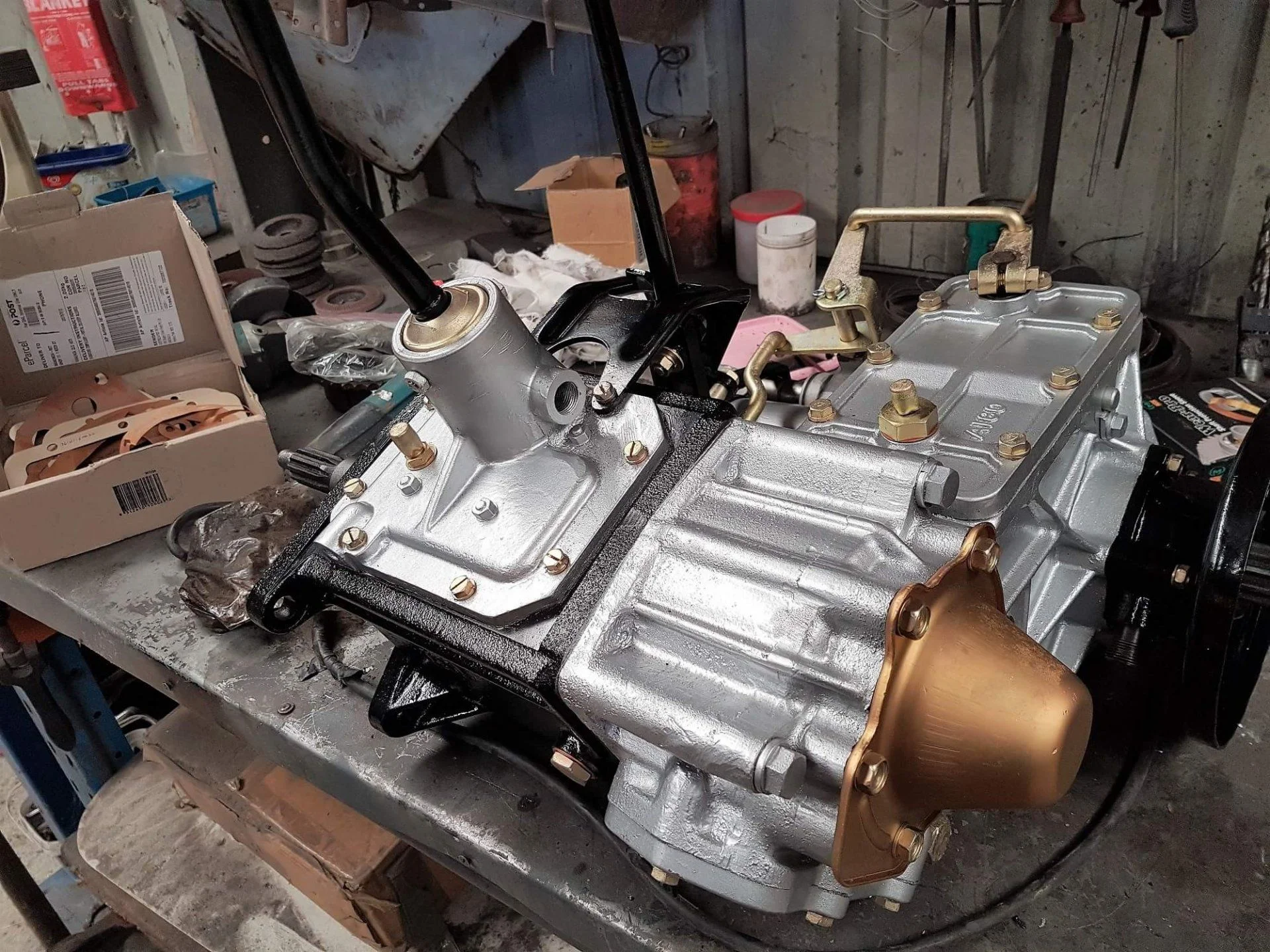

Gearbox and Driveshafts turned out looking great. Thoughts?
Just need to source Rubber Boots for Driveshafts (?) , Or the Puegeot alternative ( thanks Paul) and getting the Handbrake Drum Shaft 'Speedi Sleeved'.
Where:s best to source Inner and Outer Gearstick Boots and Transfer Case Boot?
