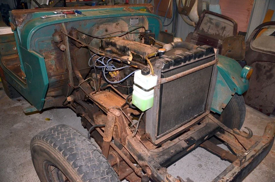

RE: Advice from FJ25 'ers' for my 1964 FJ40
my 62, seat frames are body colored. black is underhood, firewall and fenders from the folded over top piece down (so just the side splash shield section?? for lack of a better description)

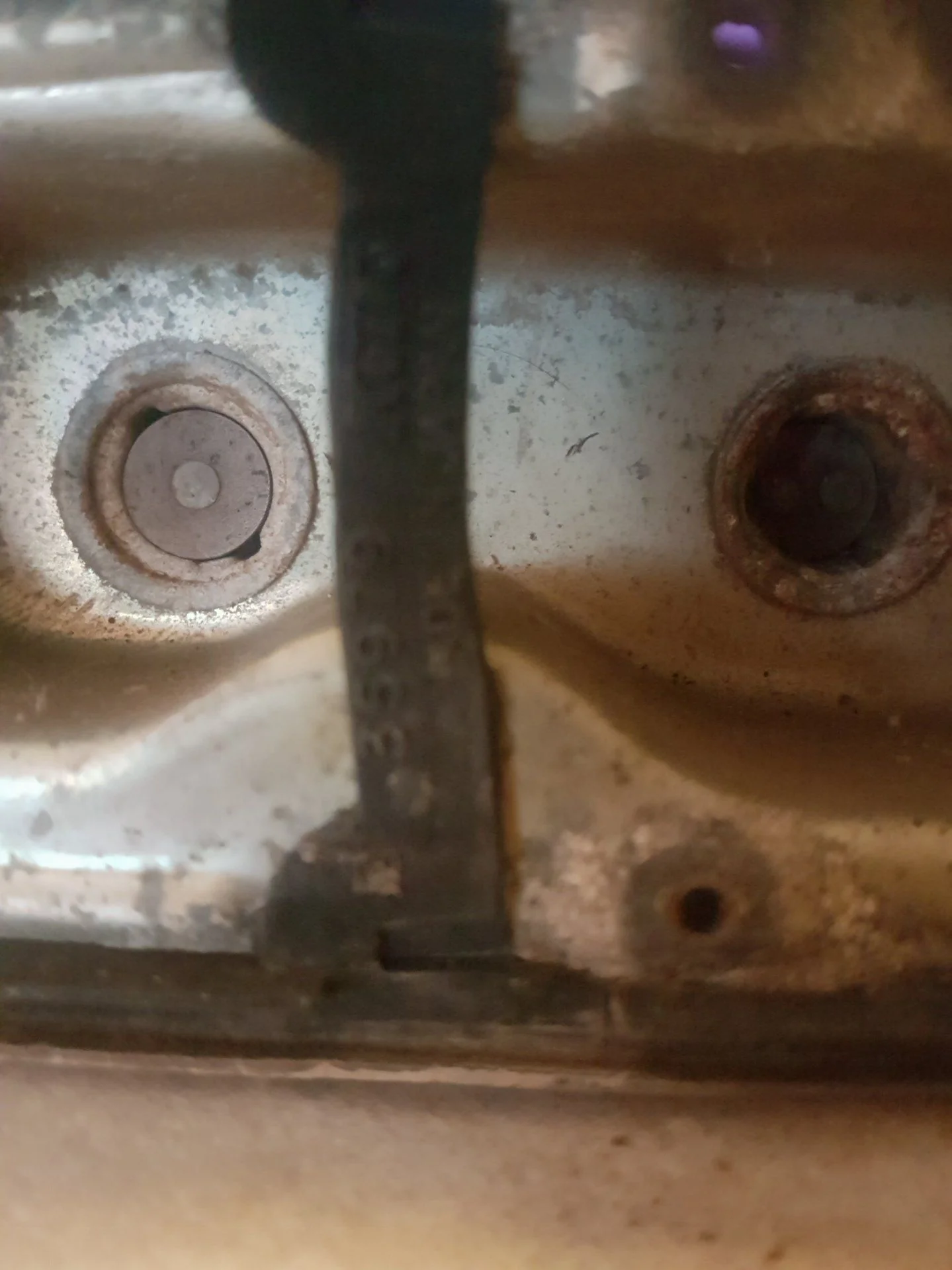

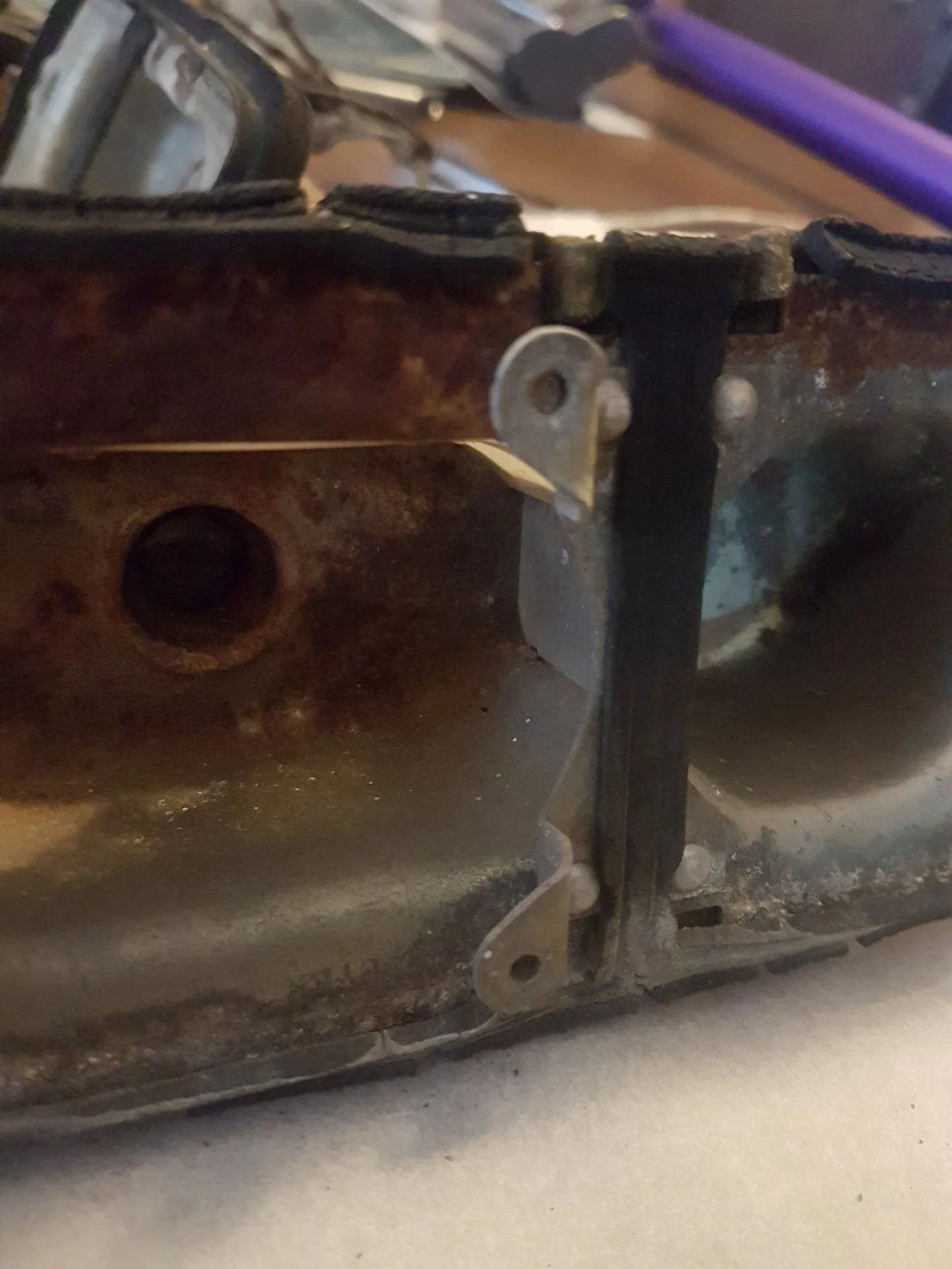

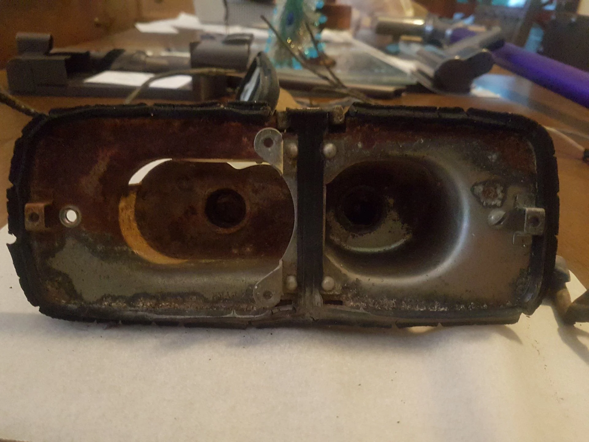

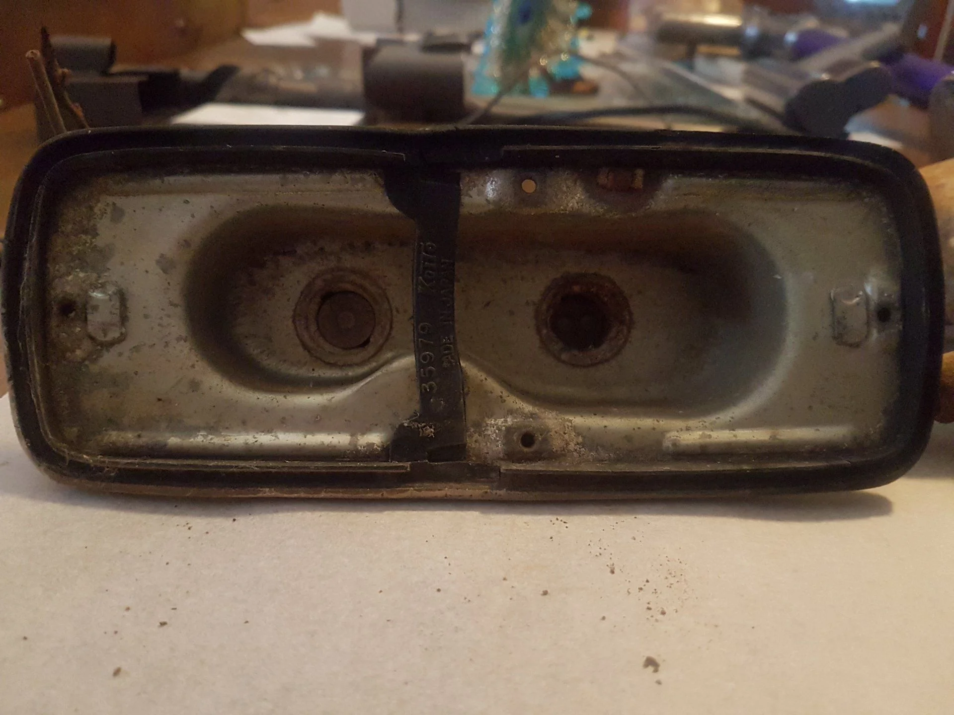

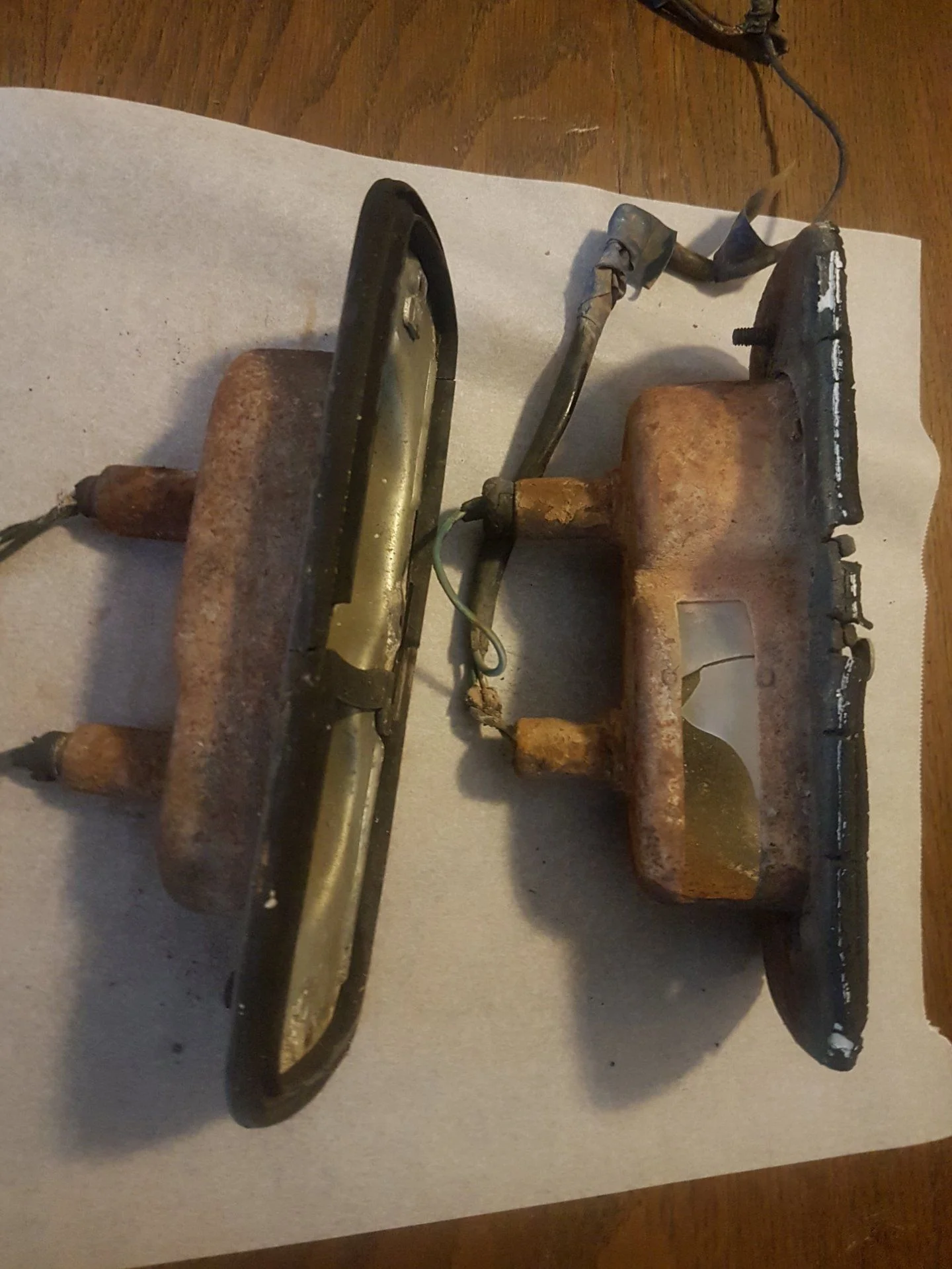

These Tail light assemblies are from a late 60's Toyota Stout. One has the clear aperture for the License Plate. Anyone able to provide a comparison to the Landcruiser version?
Wondering if I could use these?
Perhaps blank off the clear lens opening?
No help from me on the taillights.

Confusion comes from previous Owners handywork. Parts and Panels painted different Colours to Original. Firewall is a mystery? No definitive Info on this thus far. Some say Body Colour, some say Black. It was Body Colour.
