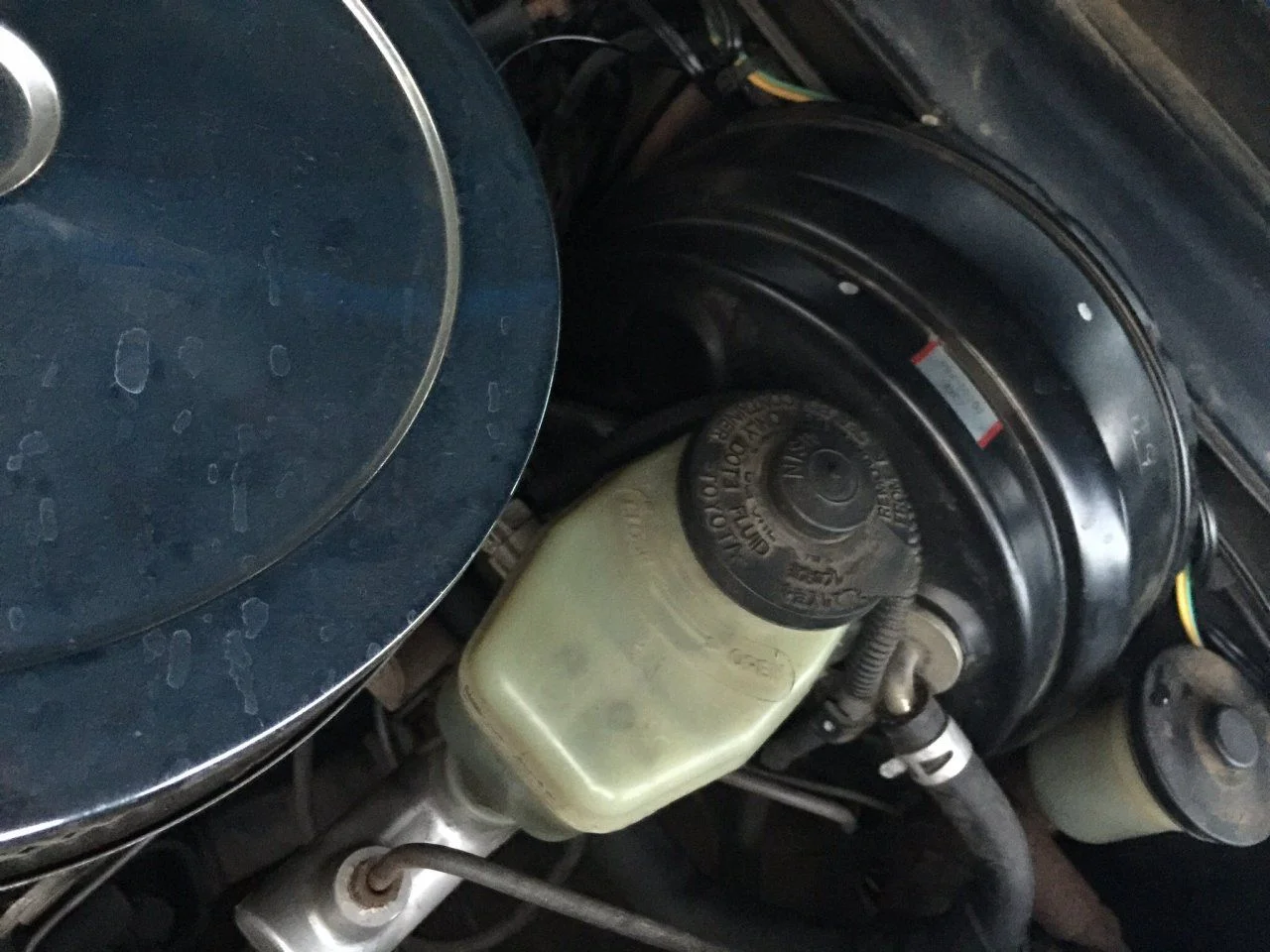

Fj80 power booster and master fit with less than 1/8 inch to spare

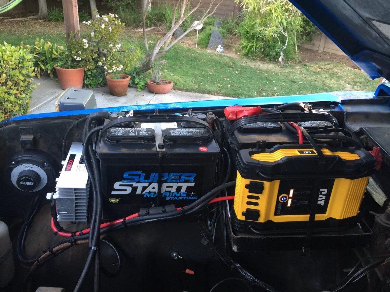

Looks like you removed the factory heater blower, what are you running for a heater?
Nice job on the battery box!
The piglet was missing so many parts blower included so I will cross the heater bridge here in the immediate future. Any suggestions?

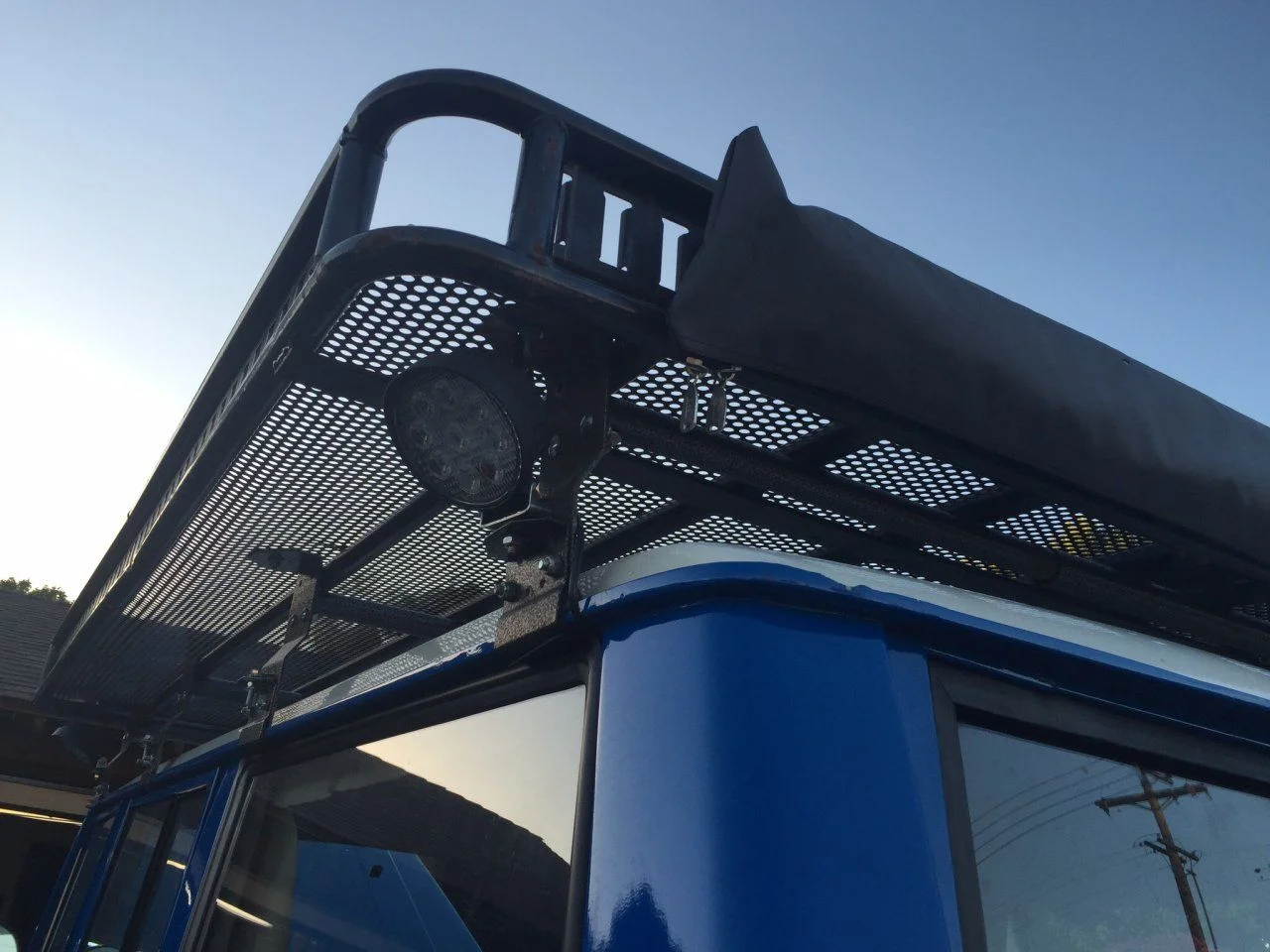

Like the placement of the LED lights below the rack. Well protected too.
Mind if I ask the entry point for the wire loom?? (I've thought about running over and up under the gutter thru a small 75 degree tube I weld on.

Wire goes up through the rubber holding the quarter panel window inthe very top upright corner. Thanks for the compliment
Ah jeesh now I see it in your pic. Nice clean run. I have my pile of lights-wire and relays ready to go... But it's a few more items down on the list.

Great looking camp vehicle! I'm up in Ventura and down in SD a bit. I'll hola when I'm around. I am wondering why you replaced with the 80 brake booster and master? Did yours fail or is it better somehow? I have read that is what people are using.
The fj80 pushes more brake fluid volumn and is set up just right for your new disk brakes
