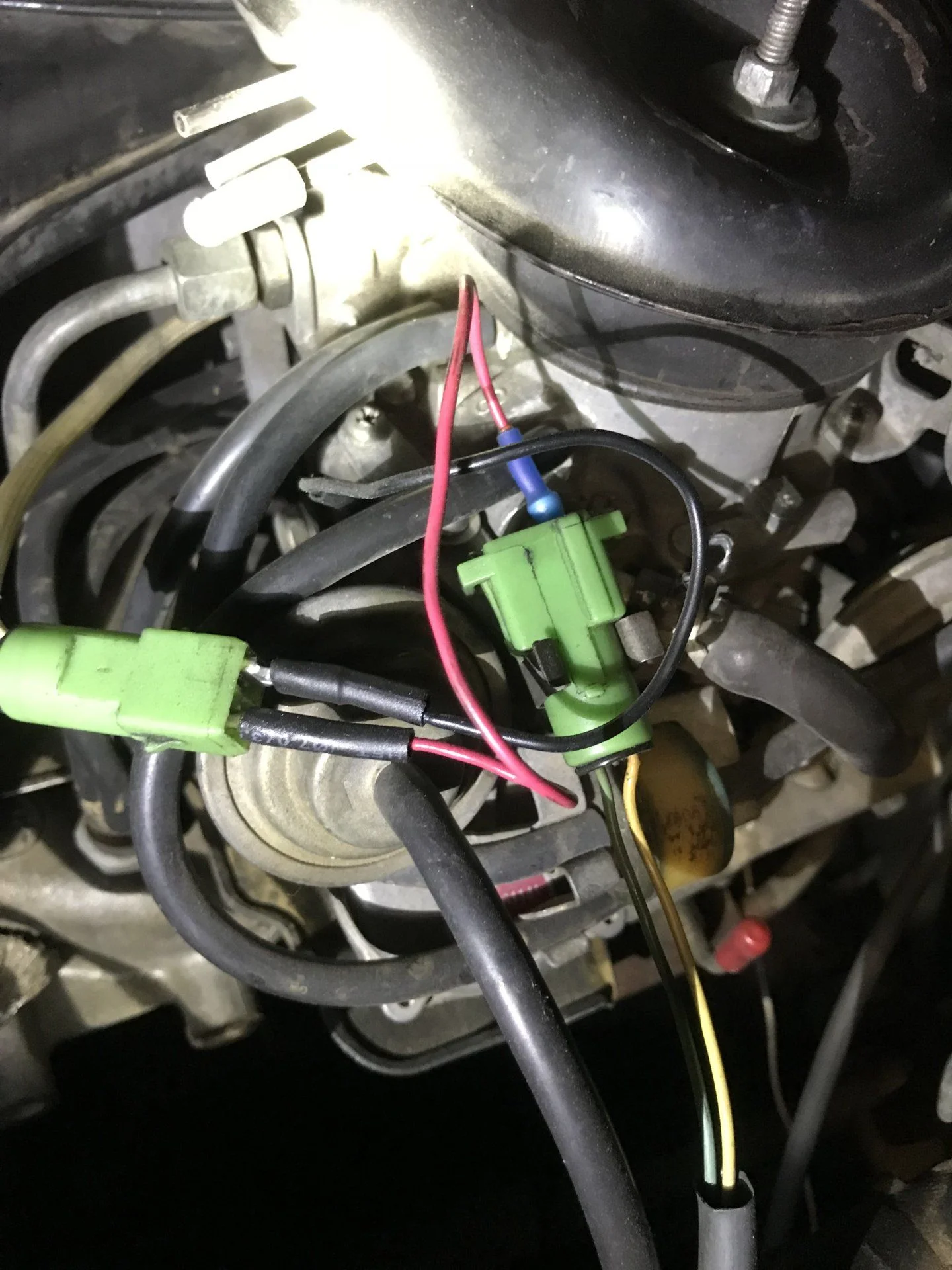

To run the ICS ground bypass, simply split the ICS plug, jumper the hot side across to the ICS and then run a jumper from the ground side of the ICS (on the actual solenoid side of the harness, not the truck side) to a screw on the carb body. Photo here:
Not the greatest shot but hopefully you get the idea. HTH.
