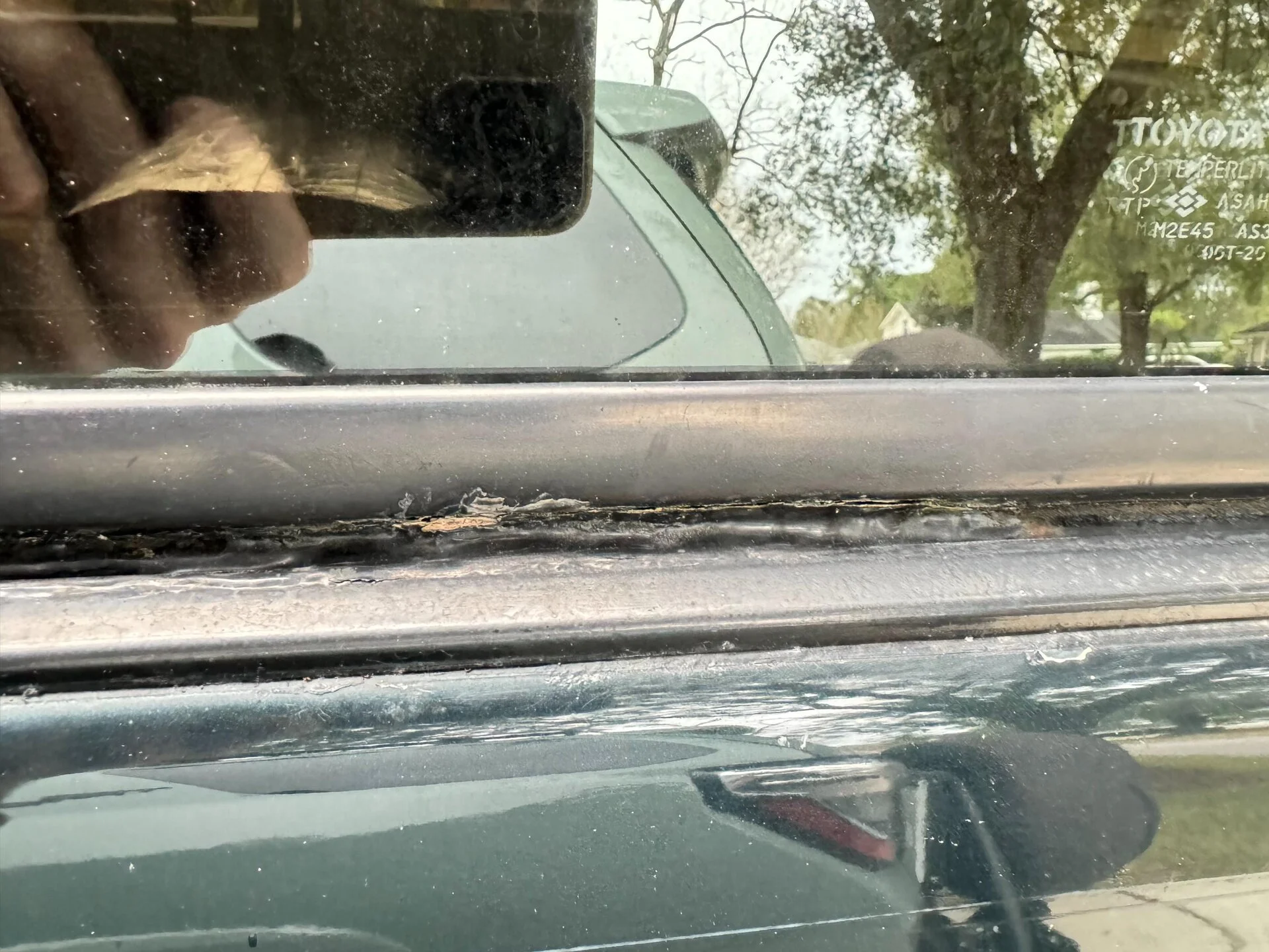

Thanks for the great advice everyone. I didn't understand the sunroof was draining into the rocker panel area and potentially clogged there. I also didn't know the rear windows had drains. I actually have a repair from the PO that I assumed was covering some rust but I may need to look at this more closely. Unfortunately, it's not silicon in the picture. It's a fairly hard material between the window seal and the belt molding.
if i had to guess, that "fix" was an attempt to prevent water getting into the quarter panel. those belt trim pieces snap into holes in the body, sealed by a gasket. there are 3 or 4 of them. well those gaskets get old and let some water in.
but the bigger culprit is out of the picture. the L shaped louvers. those are also held on by clips and a screw, with similar gaskets that age. mine was leaking pretty significantly from there and getting the jack holder very wet. lots of threads on this subject too.
Thanks, I didn't notice a gasket in the parts picture but will go back and check again. It's raining now so I should be able to easily the spare jack compartment for water as well.

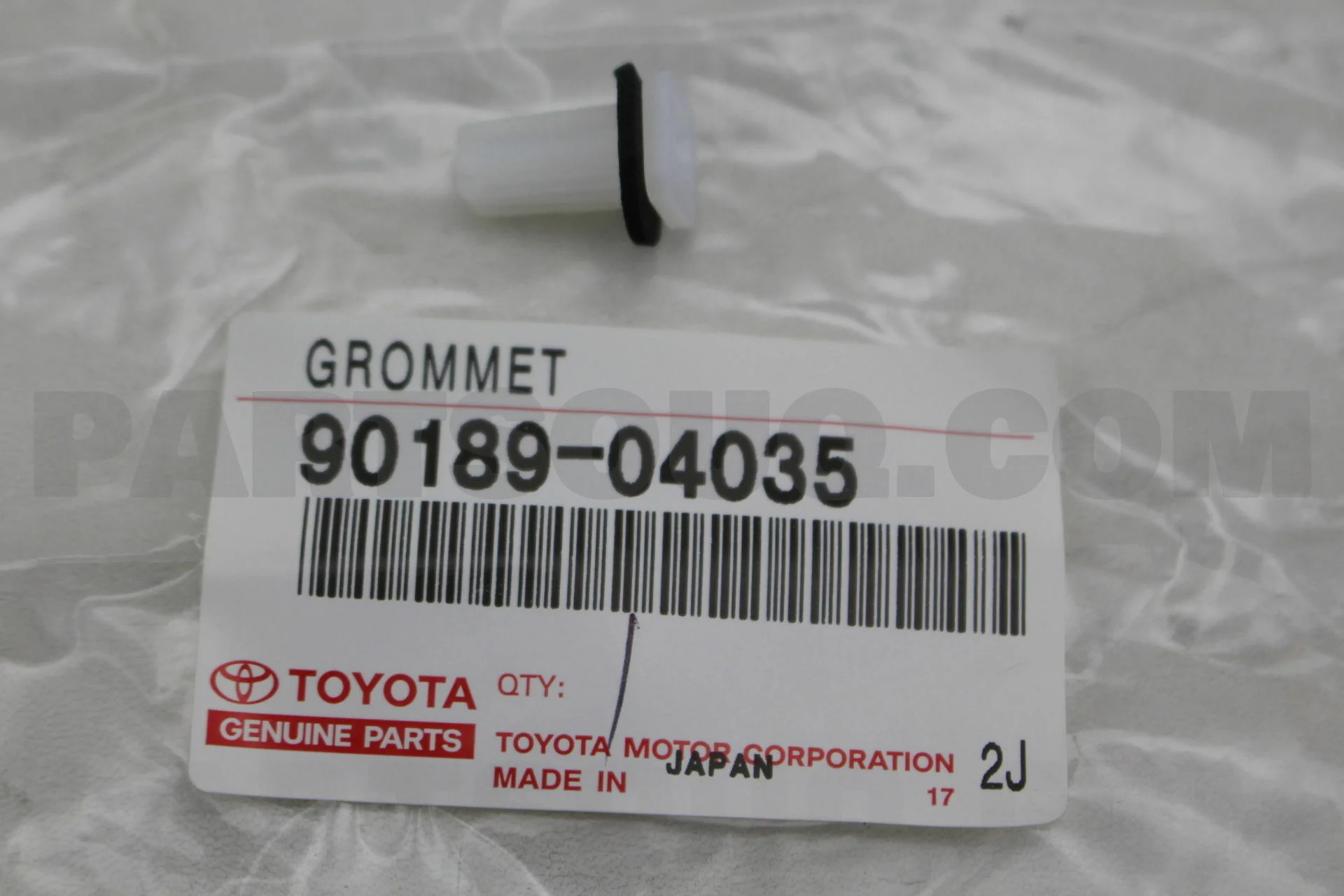

On the rear louver gasket: I found some threads saying it wasn't available for sale separately but I did end up finding what appears to be what is needed. Partsouq didn't have it but my local dealer's website allowed me to order it so we'll see. It was $10 for all four.
Thanks to everyone on this thread. You're correct that I actually have multiple leaks based on what I am seeing.
9018904035, 90189-04035

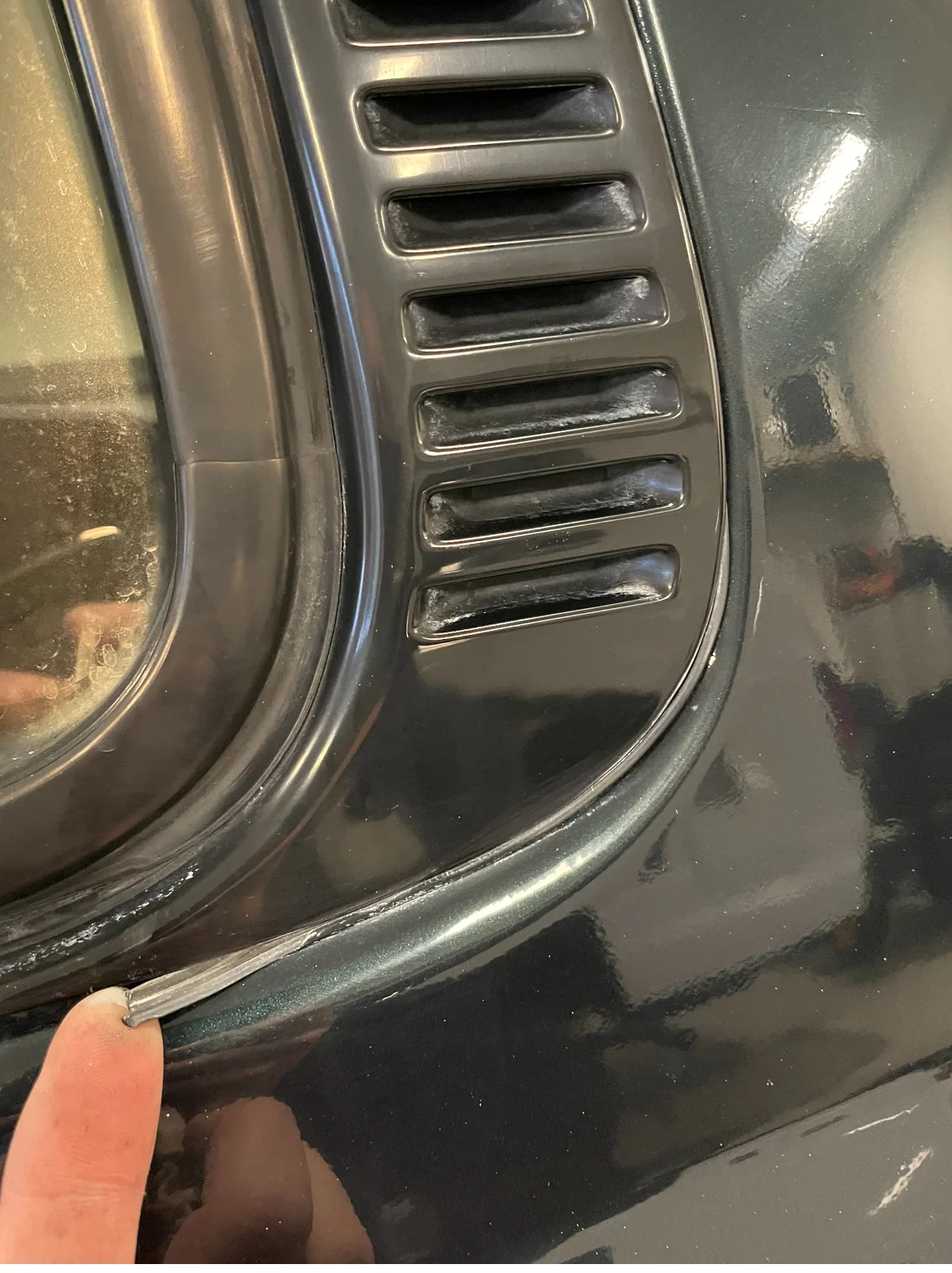

A hopefully helpful note about the louvered vent covers:
I replaced mine last year and it was a bit of a pain. I had to order new ones and the rubber gasket along the edges was so poorly attached that it almost entirely came off as I tried to get the rear quarter window weatherstripping to overlap. I ended up having to use black rubber weatherstripping cement to reattach the louver gasket. Once that set up I was able to get it all back together but it was painstakingly slow. I had to use a lot of silicone grease and a couple of plastic trim tools to get the rear quarter window weatherstripping positioned properly.
So, there’s a gasket around the bolts that I have on order. Is there is also a gasket needed around the vent itself? I think that’s what you’re describing.
Sounds like sealing the holes through the interior with gaskets / sealant won’t be enough?
what he is describing is the rubber rim along the leading edge of the louver. it was glued/taped on originally, but looking at it wrong and it will detach. i dont think it is available without ordering the whole louver.
when i R&R'd my drivers side louver recently, i decided i'd try with what i had on hand. 3m weather strip caulk was what i used. rolled small donuts for all the securing clips and nuts. and rolled long thing strips to re-secure the rubber rim piece all the way around.
re-installing it was a delicate procedure to keep that piece attached while trying to get it under the window gasket. old hotel key cards and soapy water were my tools. i was mostly successful.

What I’m referring to is the plastic louvered vent cover has a rubber edge/gasket/ weatherstripping. It doesn’t seal out all water but it certainly cuts down on it.
