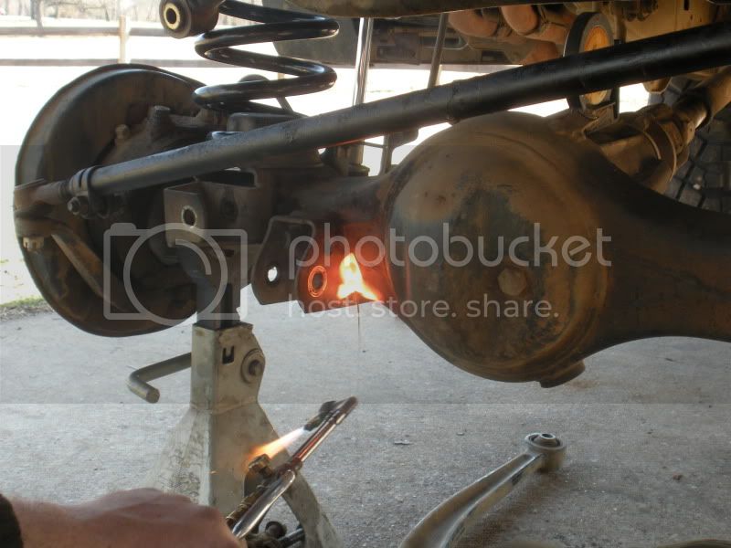

Radius Arm Flip
Hopefully the Tom.Korn will have some more testing results for us shortly
Of course it's going to drive better - his caster was way the heck out. There isn't a caster solution off the shelf readily available in the states for the amount of lift he has.
I can already tell you that the flip does everything that I wanted it to accomplish. That is:
- Make my lifted (8"+) rig drive like stock
- Move axle back to center of wheel well
- Retain Toyota factory bushings (good quality)

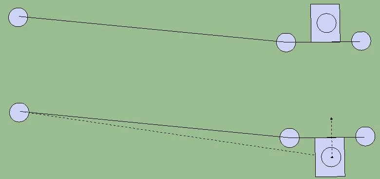

Hold up now, I think Sean's on to something here.
After reading Sean's post, this was bugging me, so I went out (in the rain!) and took some actual measurements of my truck.
Between the frame mount and the rear axle mount, the arm is 28" long (assuming you followed a straight line). From the rear axle mount to the front axle mount is 7.5". There is a 3" drop between the frame mount and the axle mounts (on my truck, with a 3.5" lift).
Now the axle tube is centered between the two mounts, with the bottom of the tube even with the center of the two axle mounts. That puts the center of the axle just about 2" above the frame mounts.
For simplicity, I rounded all those off, but they should be accurate within 1/4" (close enough for rock and roll).
So I plugged all those into Google Sketchup, and here's what I came up with (using Google Sketchup's handy measuring tool).
Stock, the center of the axle is 1" below the frame mount. The distance from the frame mount to the center of the axle is 32". For those of you who remember their high school geometry (or cheat), that puts the total angle that the arm is at (relative between the frame mount and the center of the axle) at 1.79 degrees.
Okay, on to the flip. By doing the flip you're dropping the axle (in relation to the two axle mounts) by 4". Once again using Google's handy measuring tool, I found that the distance between the frame mount and the center of the axle is just a hair shy of 32.5".
Now if you are just moving the axle in relation to the arm (dropping it by 4", or 5" lower in relation to the frame mount) that would put the angle at......8.85 degrees. Granted this assumes that the axle physically moved 4" down (which it wouldn't due to the spring rate).
Assuming that the axle stays in the same location (1" below the frame mount) regardless of the flip (which it would, unless you changed the spring rate), the angle difference is much smaller at only 1.76 degrees (.03 degrees flatter if than stock if you've been keeping track).
So...is half an inch significant enough that it changes the way the vehicle handles? Probably not. But flipping the arms does actually both lengthen and flatten the angle of the arms. (Well the flip has nothing to do with it, but rather moving the axle side mounts to the top of the axle.)

Thanks for all of the support/comments! I'll be updating this thread on occasion, and anyone else that tackles the flip is welcome to post their progress/results in here as well.
