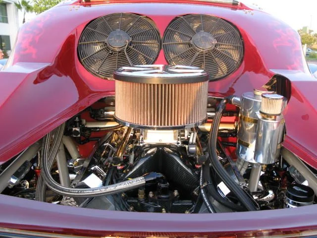

well let me be the first to say bad idea. the air that is going down the side will be pushed out from the side as soon as it hits the front of the fj. you will have to build something that sticks out from the side to direct the air flow inward like a scoop. putting big enough fans on will work but does take alot of amps. heres a picture of what i did. i am cooling down a big motor also. dry sump of course. if you look at the second picture you can see the radiator just behind the seats it does get air that way also and it helps. you can even see the scoop on the inside on the roof look hard

don’t think just a scoop on each side would do it either as the height of the scoop will be the maximum intake, would need fins ranging in height too see each slot get a portion of air, but that’s still going to limit air flow across the radiator.
