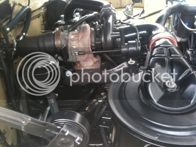

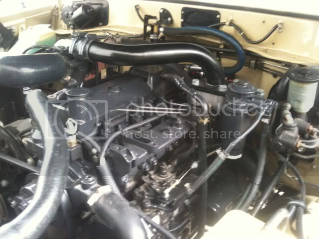

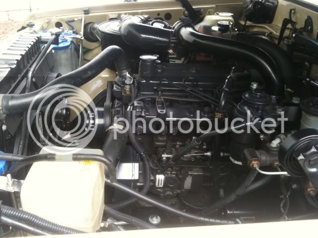

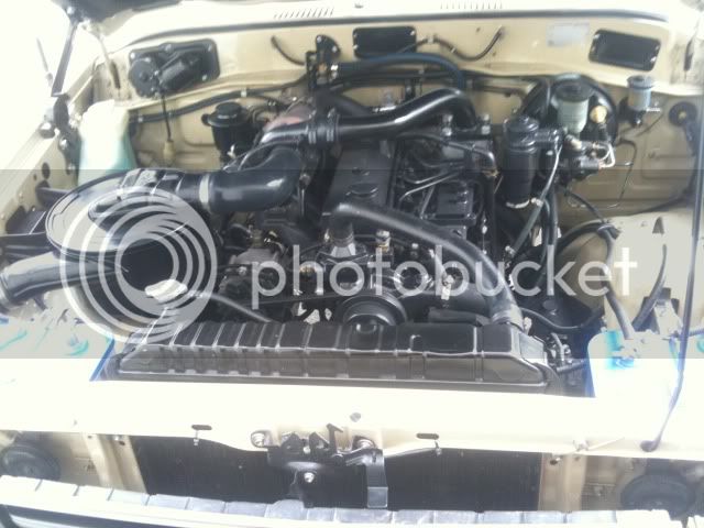

So here are some pics of the engine bay:
Notes about the engine and install:
- Got to reuse my bj60 air cleaner which made me happy, other installs with this engine have a conical air filter on the end so at least I'm getting some cold air!
-Exhaust and intake manifold are ceramic coated black. Looks really good. Just wish i could have ceramic coated the turbo!
-Powergate solid state dual battery rectifier is installed and working awesome.
-Tons of room in the engine bay now, especially with the electric fan. The diesel runs so cool though i haven't seen it kick on yet.
-all my gauges work perfectly still.
-The diesel literally has one wire to make it run, super simple.
There was an electric coolant heater between the oil cooler and heater control valve, however it did not allow enough coolant flow and the heater wouldn't work... there was no hot air. So I'm entertaining the idea of a lower hose heater. Scott at Eco Offroad who also does 3.3 conversions says he runs fine without any heater in the winters. I do have an intake grid heater but a coolant heater would be nice to keep this baby running as long as possible.
Engine Performance:
-24 mpg on first tank. I am obviously extremely happy with that. Its about 2.5 times the mpg it was getting before. Thats with me driving it around like crazy too. With more of a break in and me driving it normally i can't wait to see how it goes.
- The engine sounds awesome. I have no sound deadening, just a linexed floor, and its not much louder than the 2F. It vibrates a bit more obviously, so i will add some sound dampening behind the dash, but the engine is on some liquid filled engine mounts so its not too bad.
- even with less HP than the 2f, there is a significant difference. It is noticeably perkier and unlike the carb drives great at every altitude. It pulls up every hill.

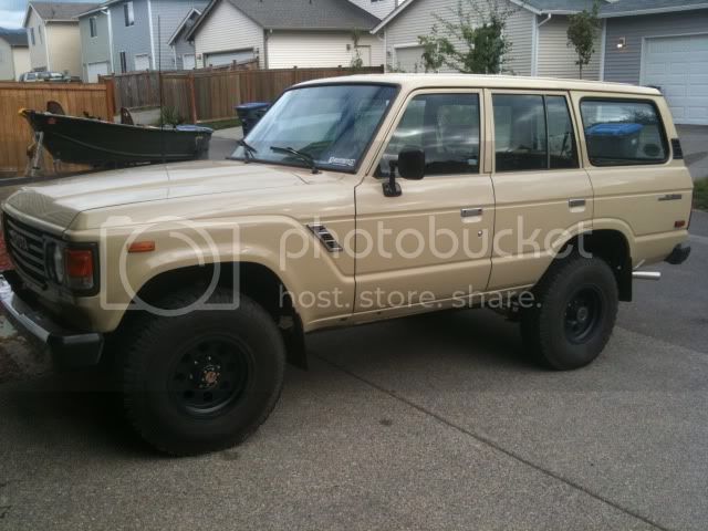

Some overall pics, add a leafs going in this week to fix the stink bug, also have an alloy art roof rack going on as soon as i can make it to seattle!
