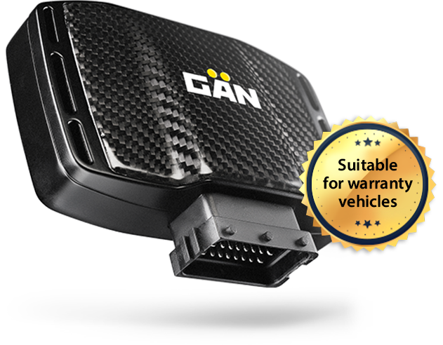

Has anyone used or tired this on their GX?
I didn't think there was any type of "chip" for GX's. It looks very compelling but I'm sure the numbers are a little inflated.
Looking at the installation, it's just an OBDII dongle. That being the case I would need a OBDII splitter so I could still have my MXLink attached also, but my gut feeling is when driving I can have one OR the other, but not both running at the same time. My reasoning is that I can't have two systems on my MXLink running at the same time, like my engine temps AND my tire pressure/temps.
The OBD based tuners I have used in the past on other vehicles plug into the OBD port to upload the tune to the ECU and could be used to monitor the engine, but do not need to stay connected all the time unless you want them to do monitoring. Some had pretty sophisticated data logging.
