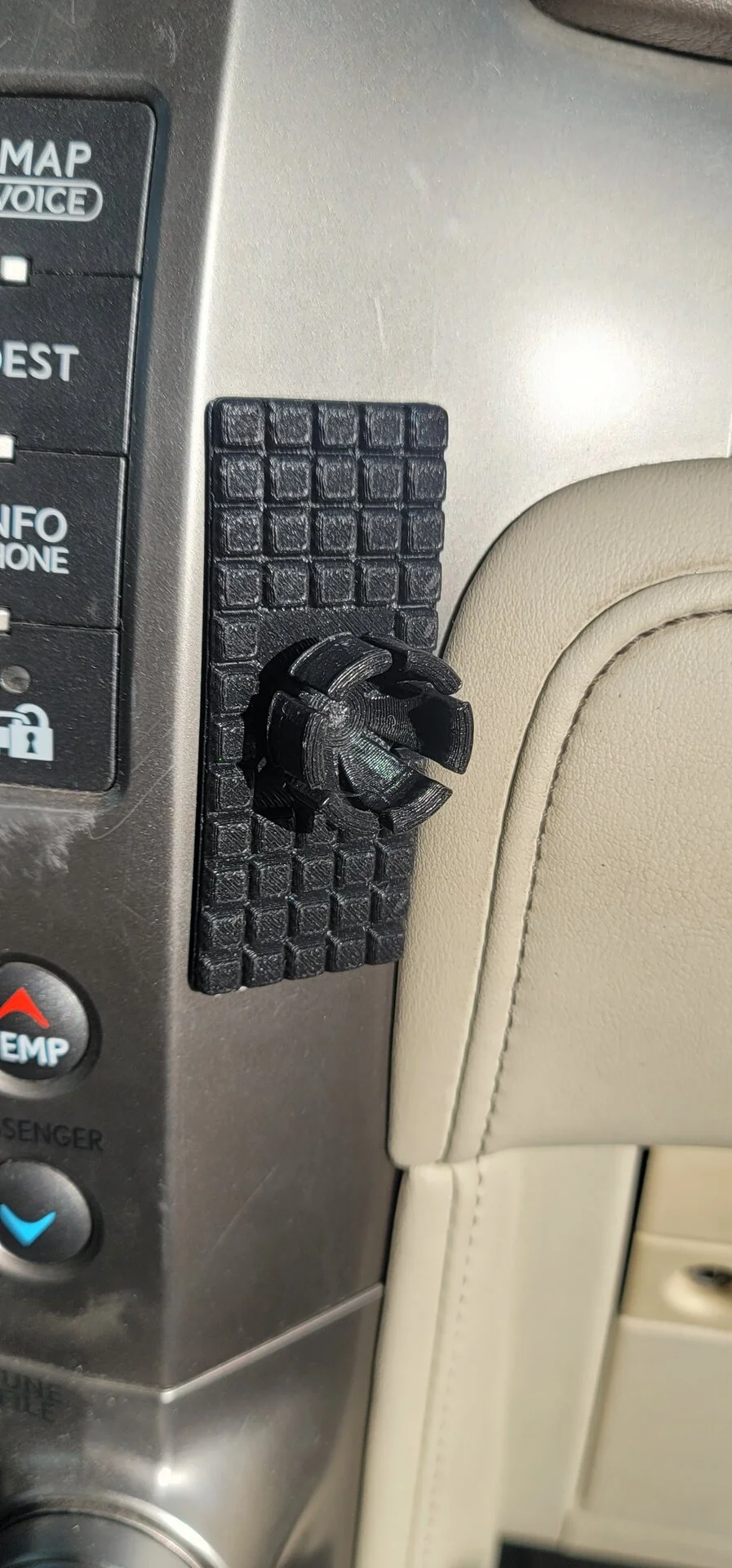

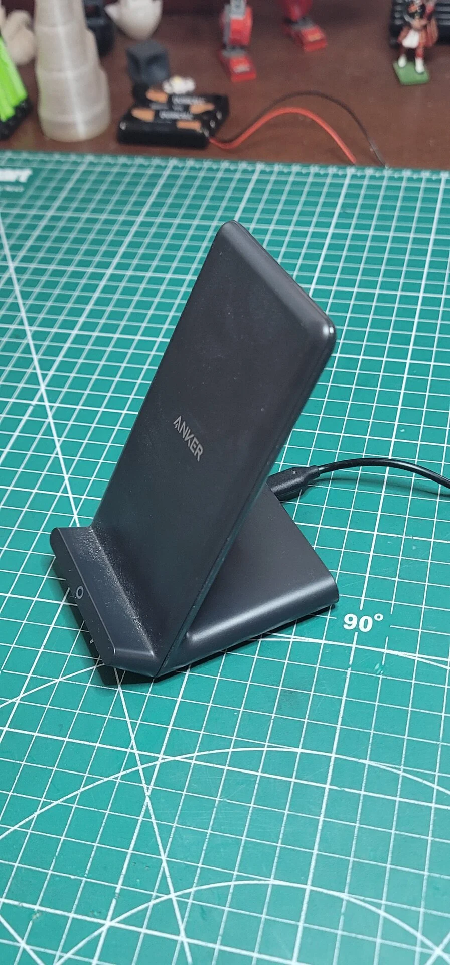

Had an old desk wireless phone charger that I decided to make into a second car charger for my wife's phone when we're on road trips. There really isn't a good place for a second phone holder and charger for her phone.
Here is what I had:
I designed it in SoildWorks. Gutted the old charger above of it's electronics, tossed the case and all the plastic. Reconfigured the electronics a wee bit to fit in the redesigned new holder.
Here is how it looks now. The first pic is of the ball socket for universal positioning. The waffle pattern is so it will configure to the compound curves of the dash. The sun makes it look much more course than it really is. In person, it looks really good.
This is the phone charger/holder mounted to the ball socket.
