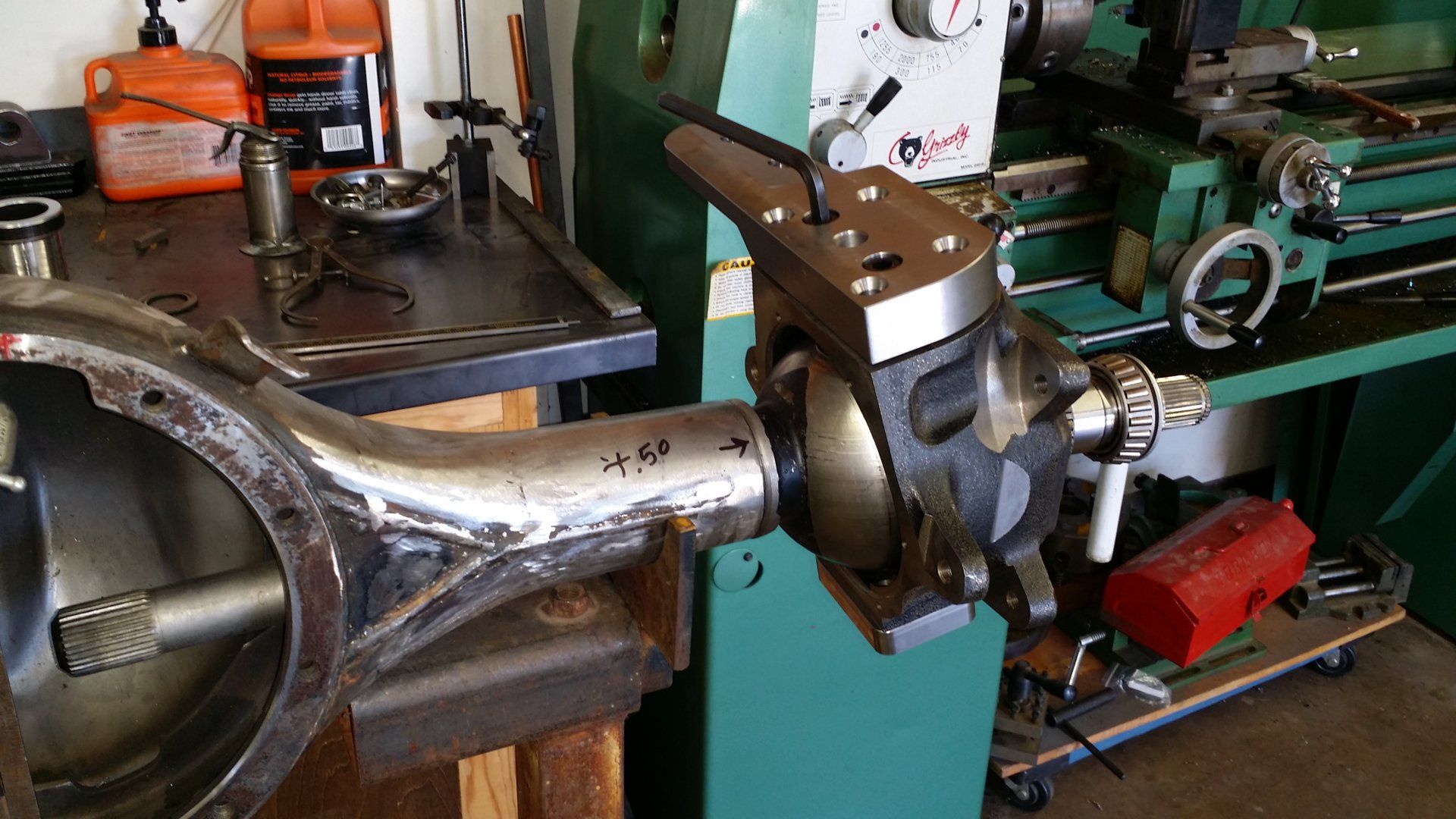

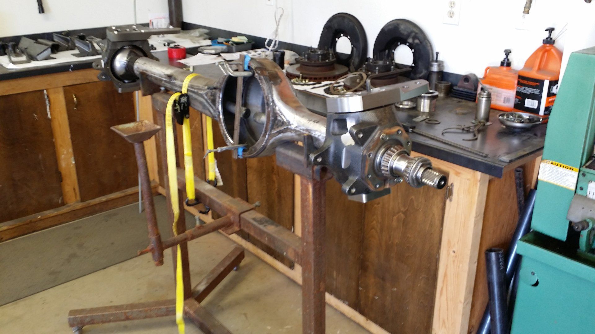

Hybrid 80/62 front axle. Took a back seat to other projects. Third is in, finishing is on the 'to-do' list for winter.

2x high pinion third is no bueno.
With the 80/60 axle, what are you doing? Do you take the 60 core and housing and put that onto the 80 shafts? It seems to be a pretty big fabrication job.
Pretty easy mod actually. I just wanted to keep the 'breakable' stuff OEM Toyota. @JohnnyC is on point, 60 and 80 axles are wider than 40 axles.

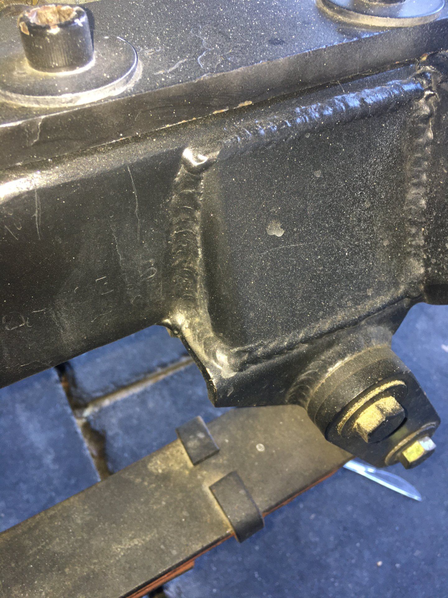

Easy peezi. Outboarding is simply moving the spring and shackle hangers 'outside' the frame rails. You can build your own brackets or Ruff Stuff has some really nice ones at a very reasonable price. If you are contemplating going to a longer spring (i.e.FJ60) this would be the time to do it.

You need to add metal to the side of the frame where the springs will attach. the short side of 60 series and 40 series axles are the same and this puts the differential over the frame in the way of the stock spring location.
