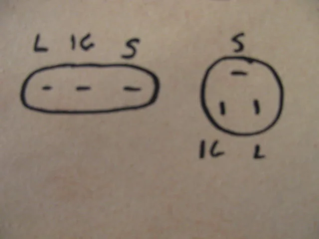

anyone know what this plug attaches to? it was on both the 79 and the 70 but i can not find anything it attaches to. near the alternator...

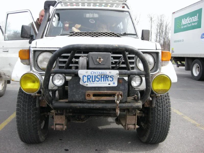

Those front shackles look very beefy on the fron of your white 7x series are they home made
Also looking at your carpet pics your have one of those very cool center consols,, prados come with all the cool int gear dammit
yep, i made those years ago and they have been on a variety of trucks. the trucks get retired but the shackles live on.

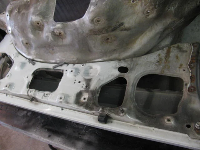

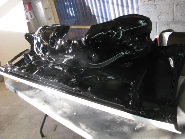

i decided to paint the interior fenders rattle can black. cheap, looks okay.

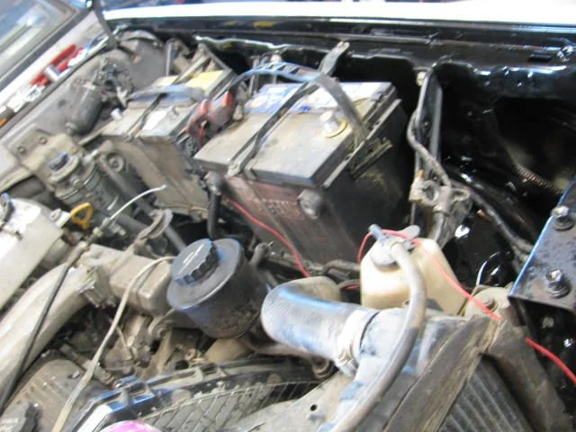

fender installed with dual batteries trays
batteries and wiring almost completed on LH side...

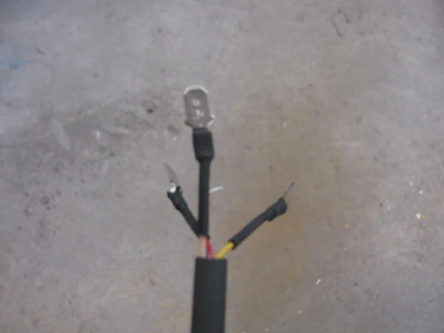

at $600 for a new 12V alternator i decided to make an adapter from oval to round plugs.
a call to my supplier in Calgary and he gave me the routing to make.
spade plugs and shrink wrap.
done ... and it works.

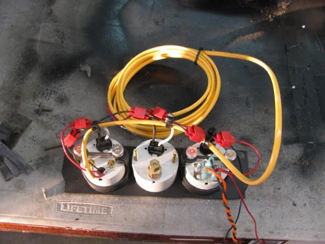

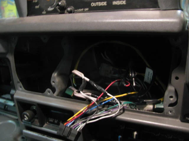

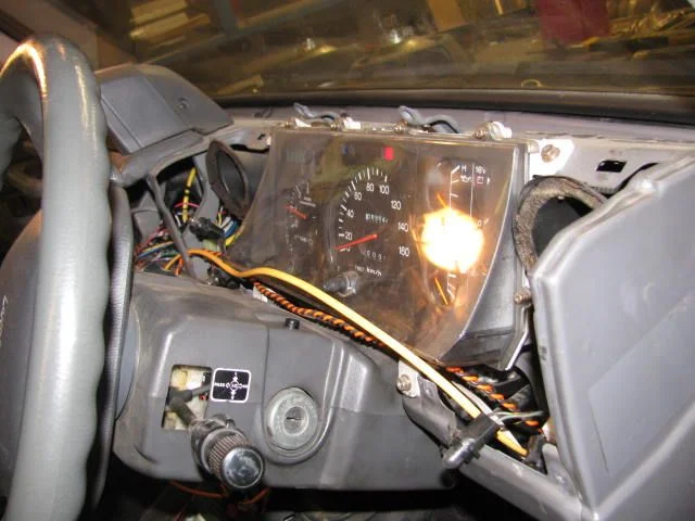

next up, the gauges for the interior.
i like to keep the wires away from moving parts so i pull the 6 screws and run them under the dash pod. safe and out of the way.
