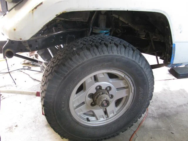

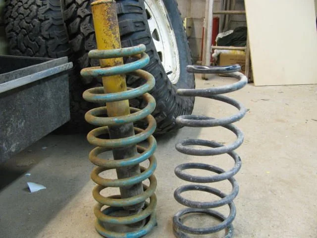

the lifted vs the stock springs

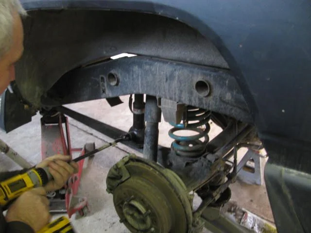

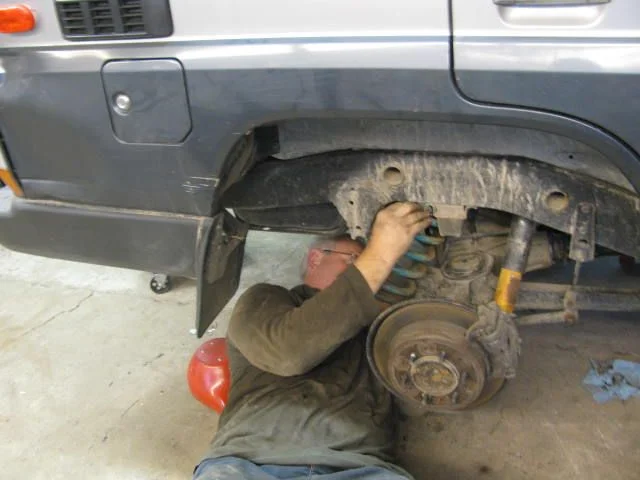

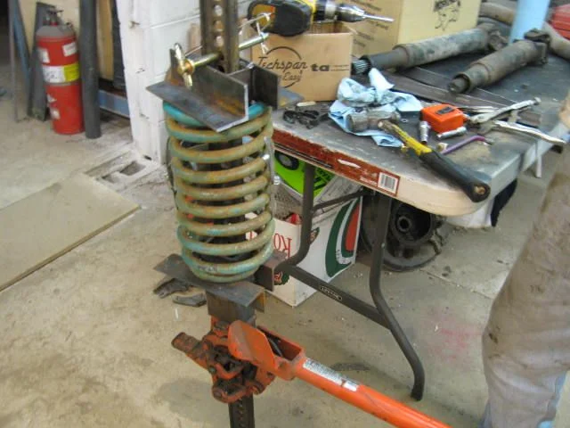

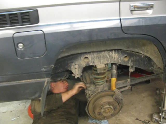

taking the old out is no big issue, jack stands under the body, remover the tire, remove the shock, twist and out it comes... watch your fingers!

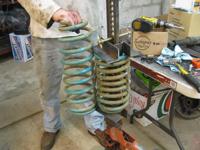

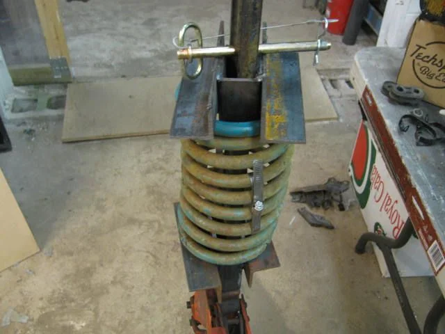

when it is late at night and you don't have coil spring compressor you need to get inventive.
Rusty designed this idea and it works like a charm.
but
no matter what KEEP YOUR FINGERS AWAY from ANY pinch points just in case the retainers let loose. YOU WILL LOOSE A FINGER(S) if they are caught.
the springs slipped right in, put the shock on, put the tire on, put the weight of the body back on the spring and cut the retainers. done.
old spring out

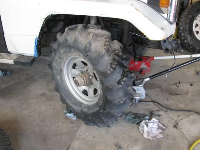

even compressed the LH side rear needed a hand to get the spring in. i love bottle jacks but hate the hand cranking so a modified crank and a 1/2" cordless drill and you have a speed bottle jack.

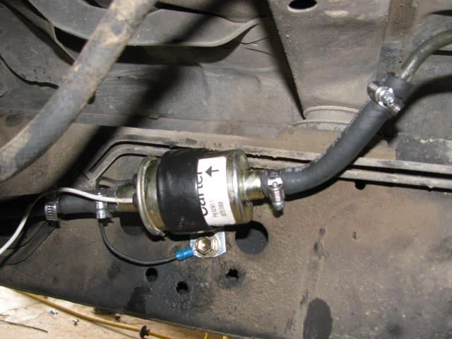

one of the best additions to a PZ HZ @LTE is a feeder pump. it really makes a difference to starting, power ... as long as you don't mind the purr of the pump.

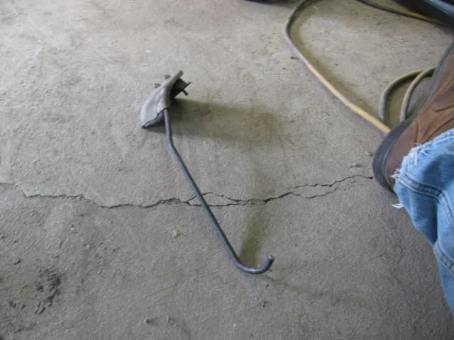

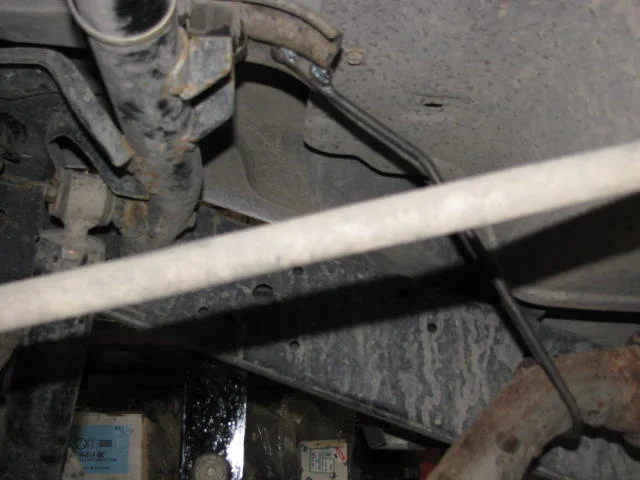

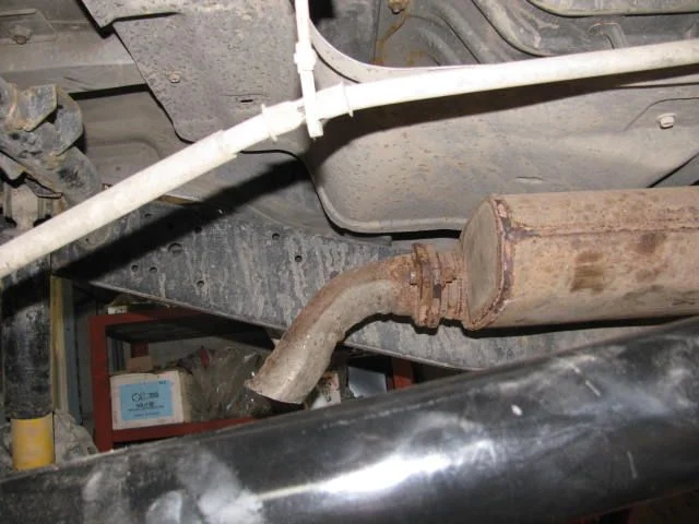

a poor mans exhaust dump. the system i had on the PZJ70 was a 2 1/2" aluminized exhaust with a steel muffler. these systems last forever and since the old system was only 2 years old i wasn't ready to pitch the system. a dump and a hanger and all is well.

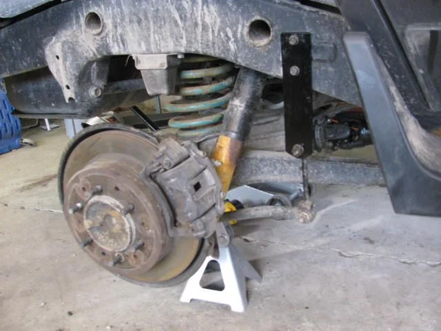

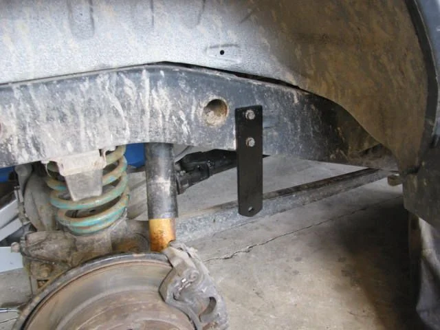

Rusty's answer to the swap bar drop for the rear. i can attest, this works well.
Rusty's exhaust hanger using the factory mounting plate and locations.
installed
the sway bar mounts installed

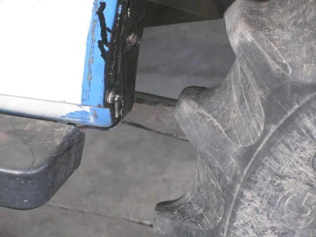

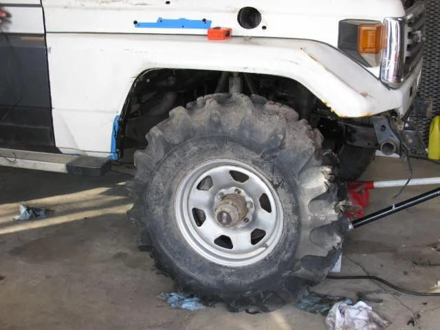

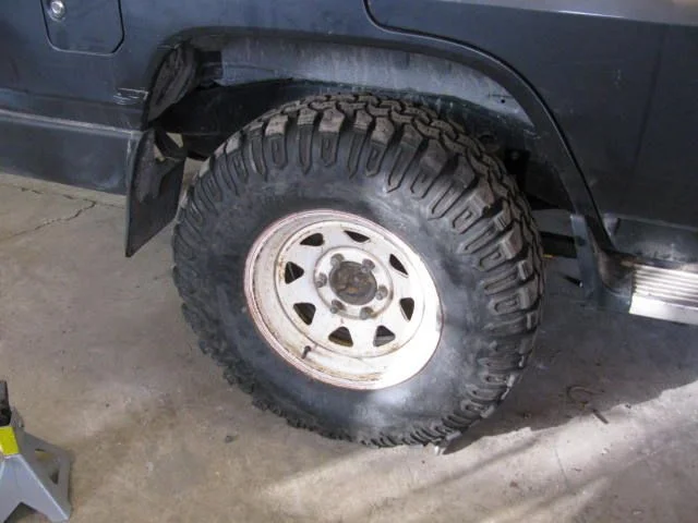

we decided to test fit the off road tires i run, 36" tractor tires on factory rims.
tons of clearence all around.
they are my bitch'n babies for off road fun.

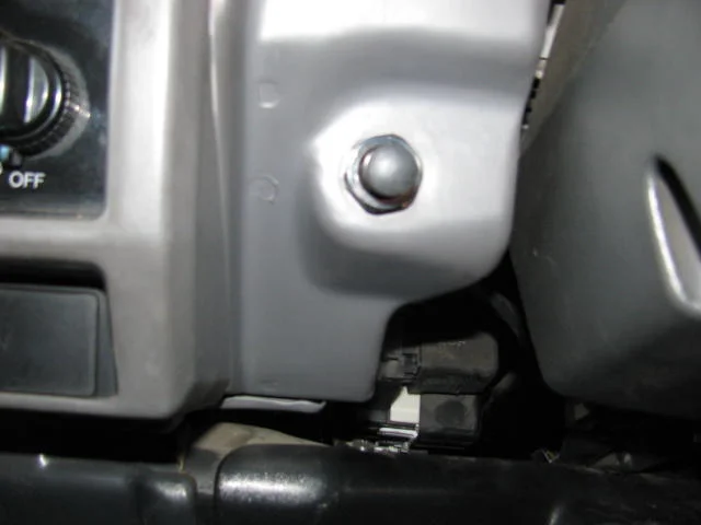

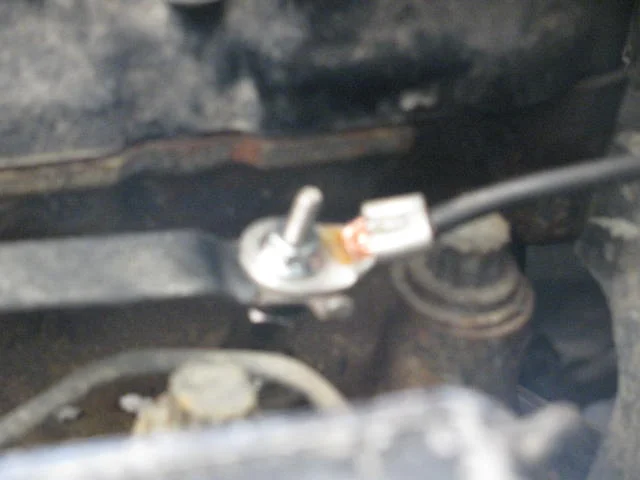

manual glow system
5 seconds and away it goes, nice thing is you can reactivate while running to clear that pesky start up burp.

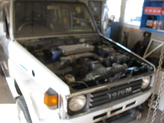

the engine installed, the front clip installed and ready to rock and roll.

cheers guys. edit: that sure is a crappy shot, sheesh.

looking good Wayne, that spring compresion trick is a good one to remember.:beer: Rusty.
thanks
i was originally going to fab up a threaded rod thru the middle of the spring with brackets at each end,
while I was rooting thru the scrap metal bin I found the 2"x3" (I believe) rectangular tube and thats when inspiration hit
my dad got hit in the face (and lost a tooth) way back in the day trying to compress a McPhearson strut for an Audi....
that (Audi) strut was a tiny little ball point pen of a spring compared to the coils on the cruiser.....
