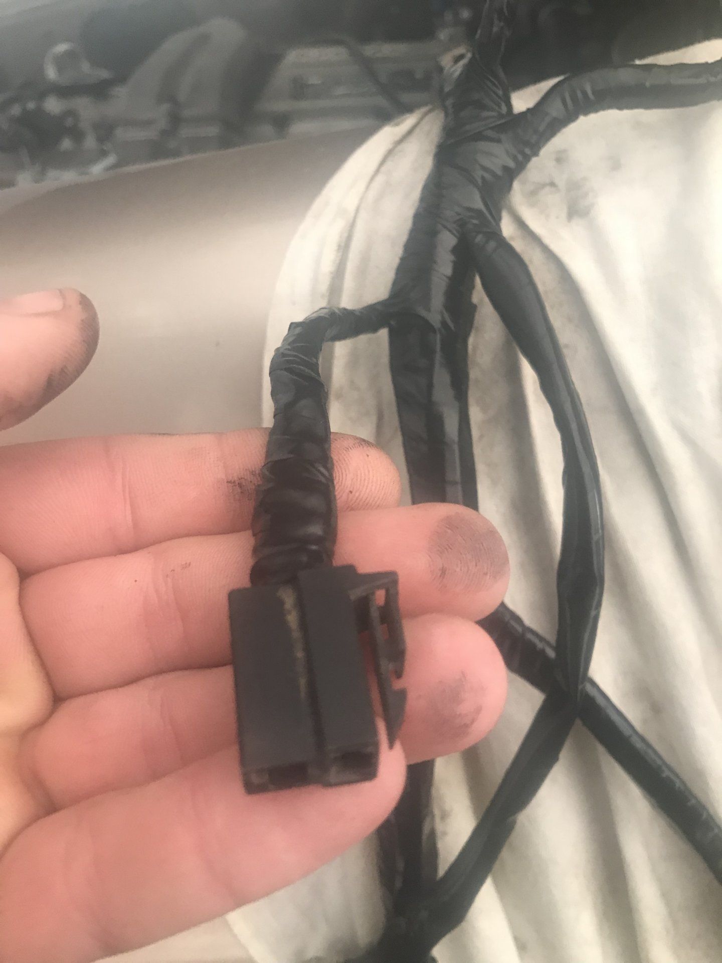

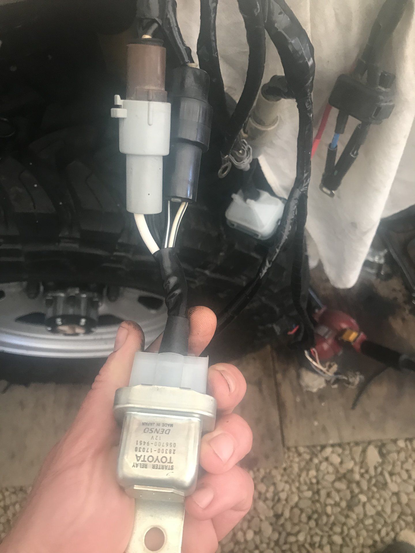

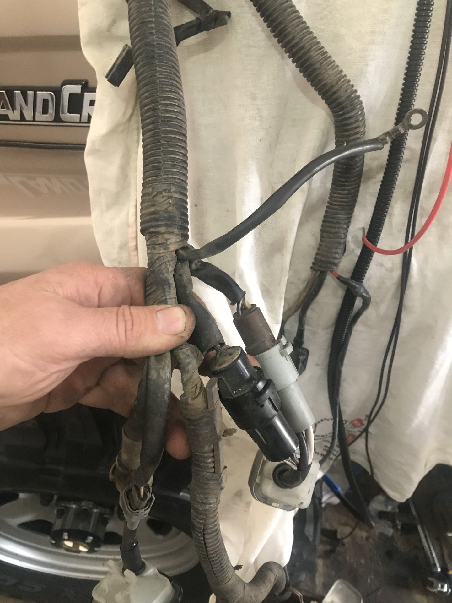

What is this thing, I'm 99% sure I dont have one on my Hz.
,View attachment 1955213

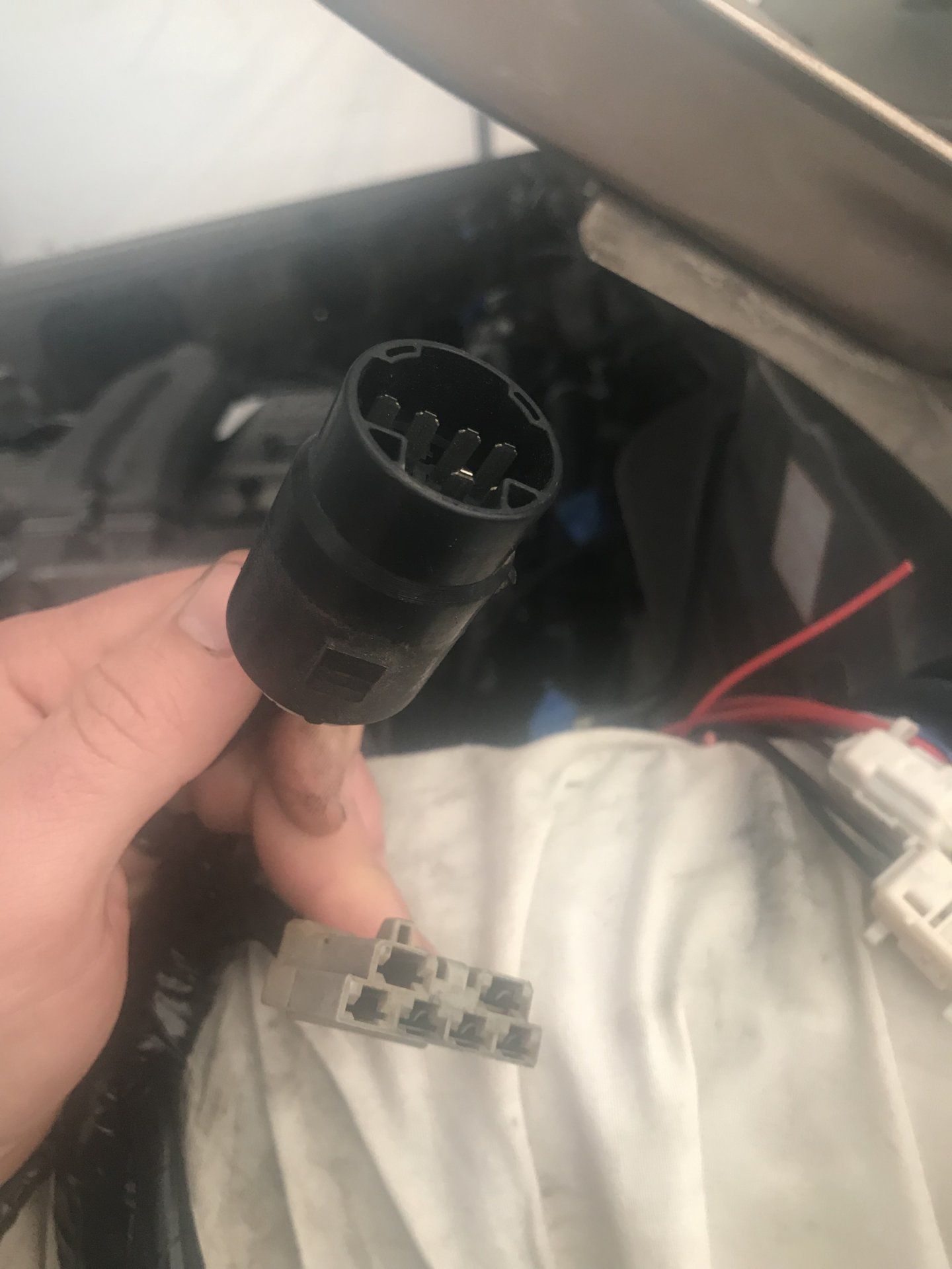

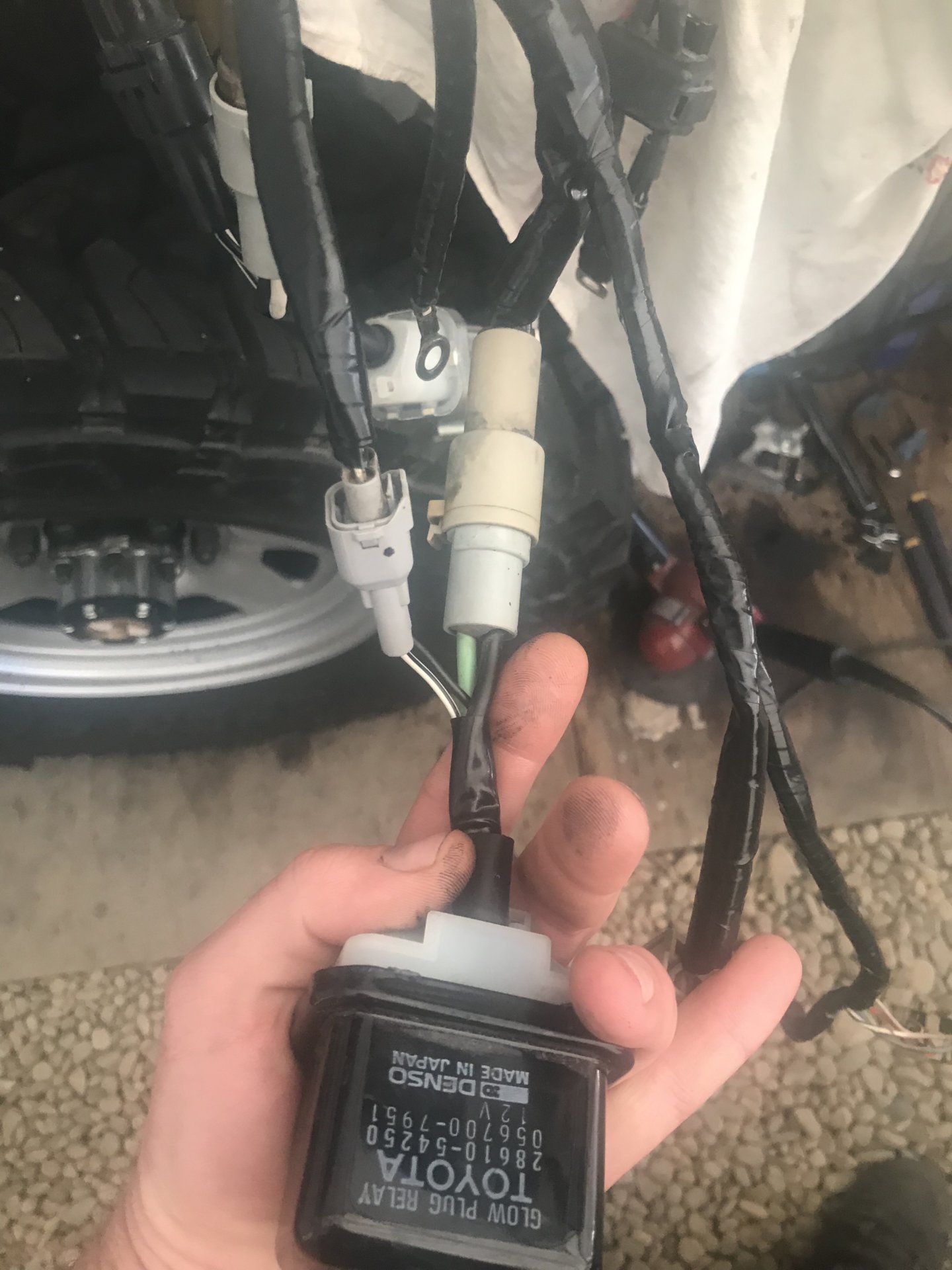

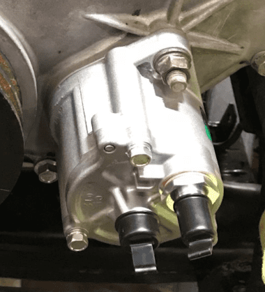

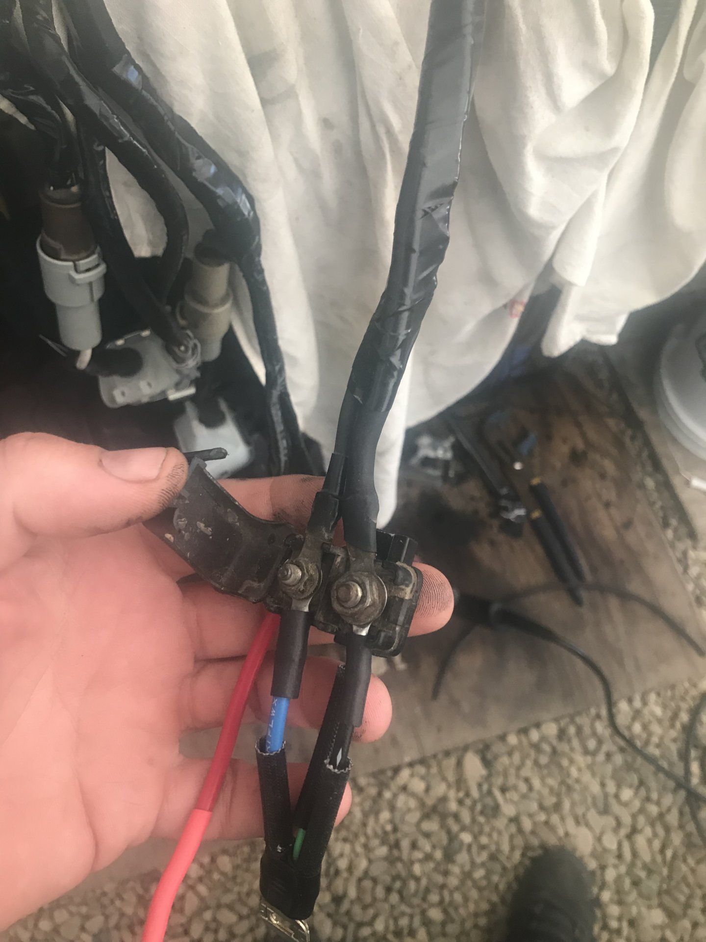

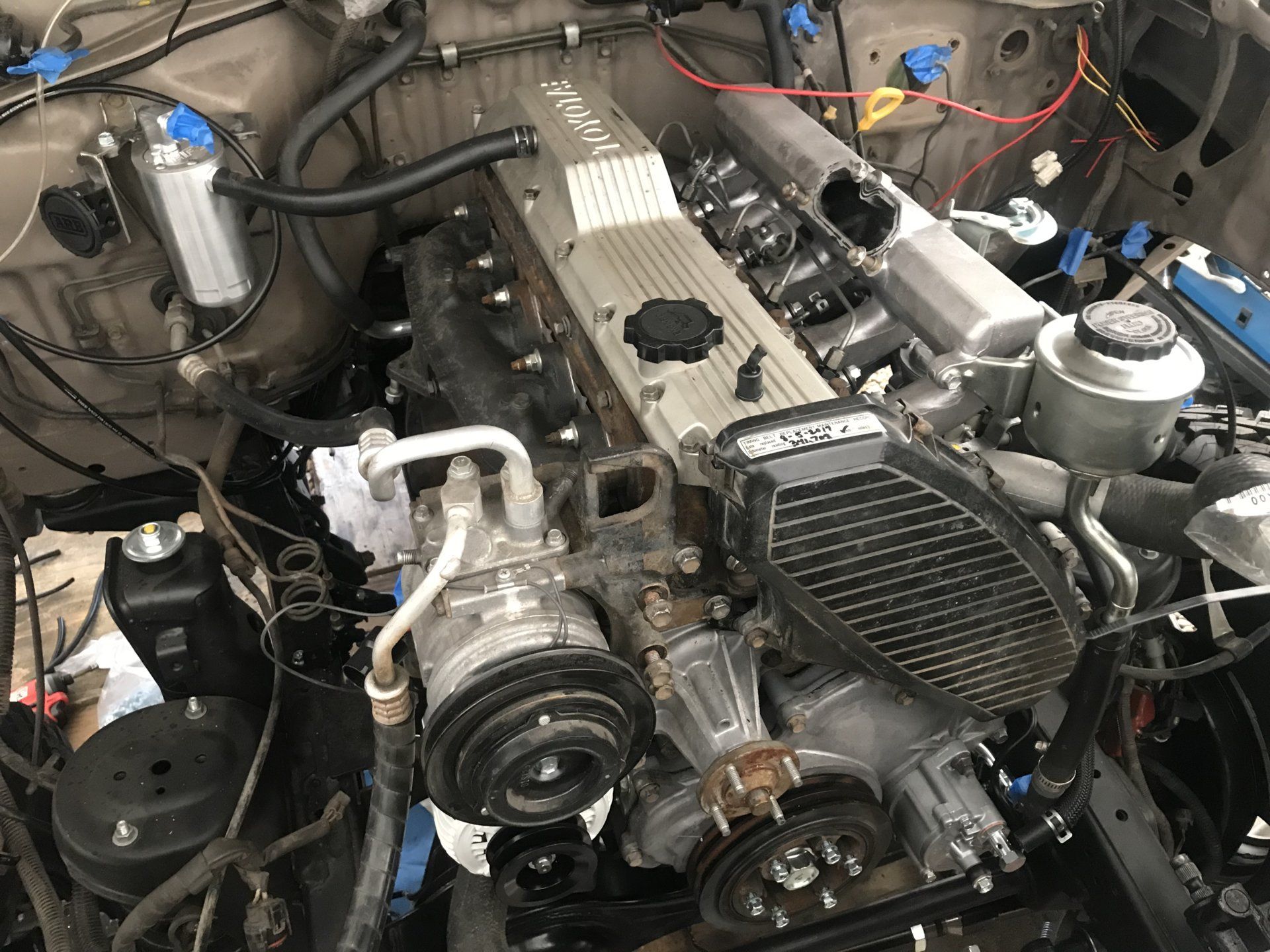

@SNLC thanks, what is the third piece that looks like a black plug go to? Mine is got all cinched and can't tell where that connected to.
no its not, started life as a 1HZ now 1HDFT
