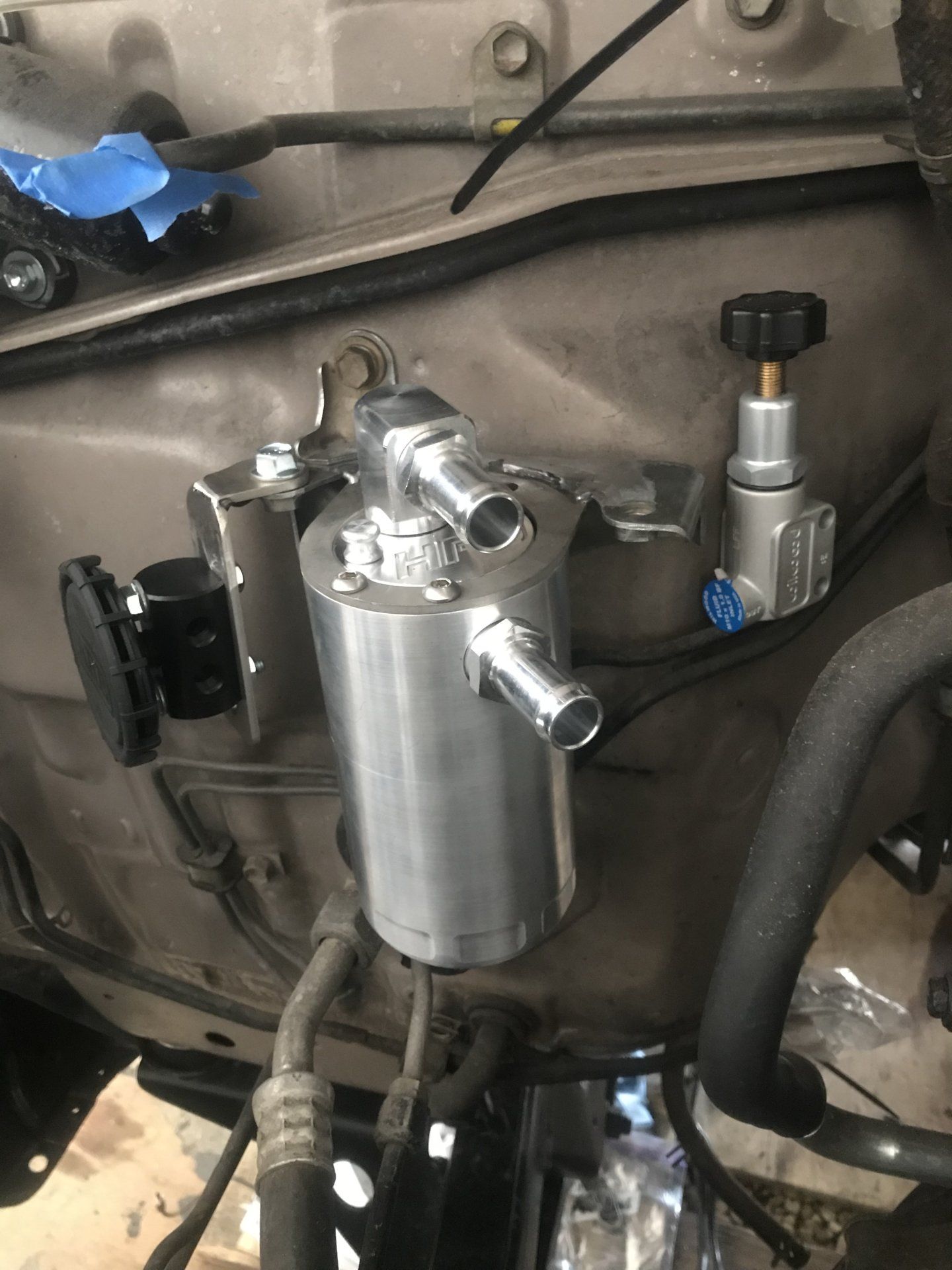

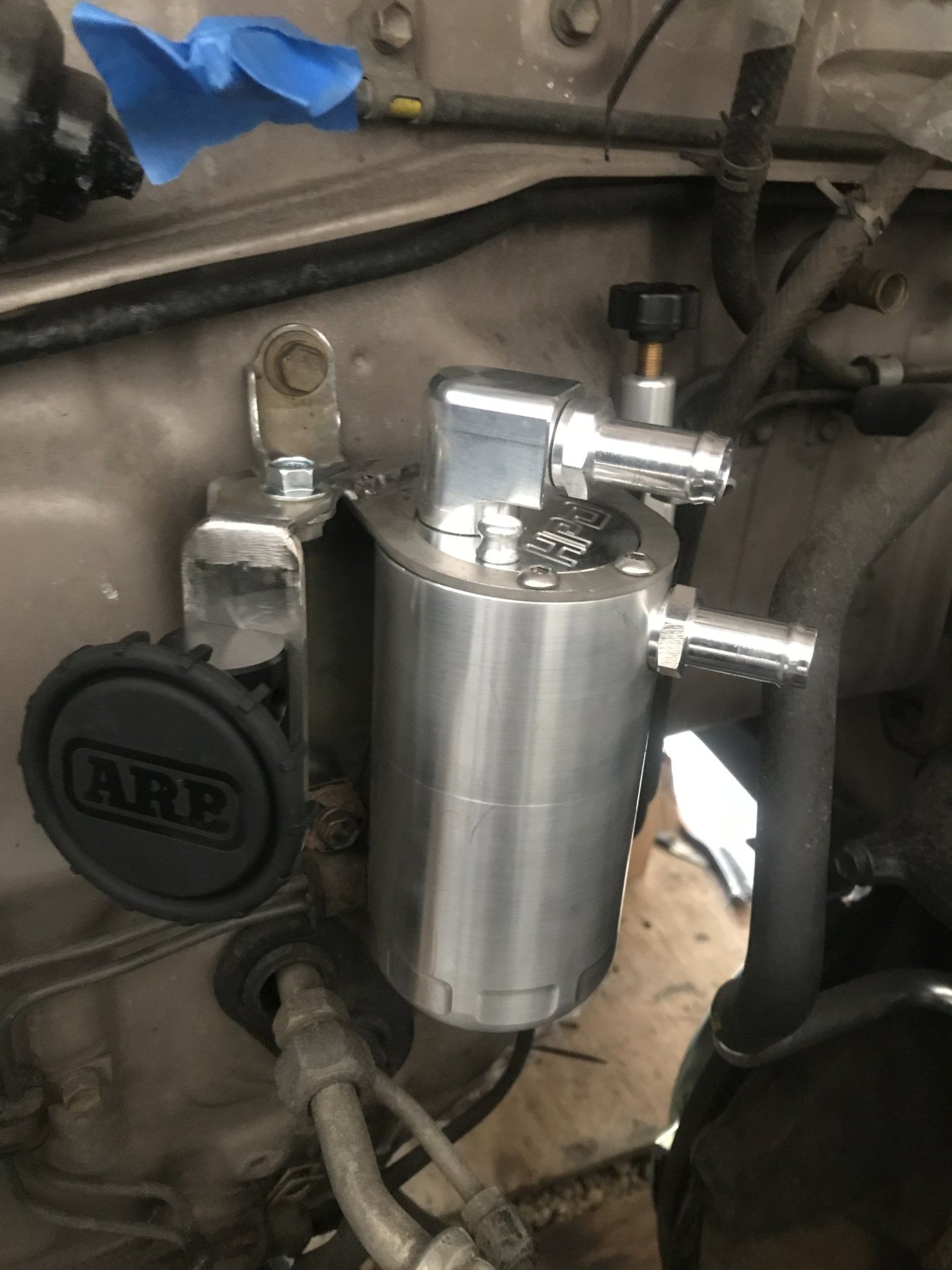

Still got to build a bracket for the proportioning valve but it is getting there.

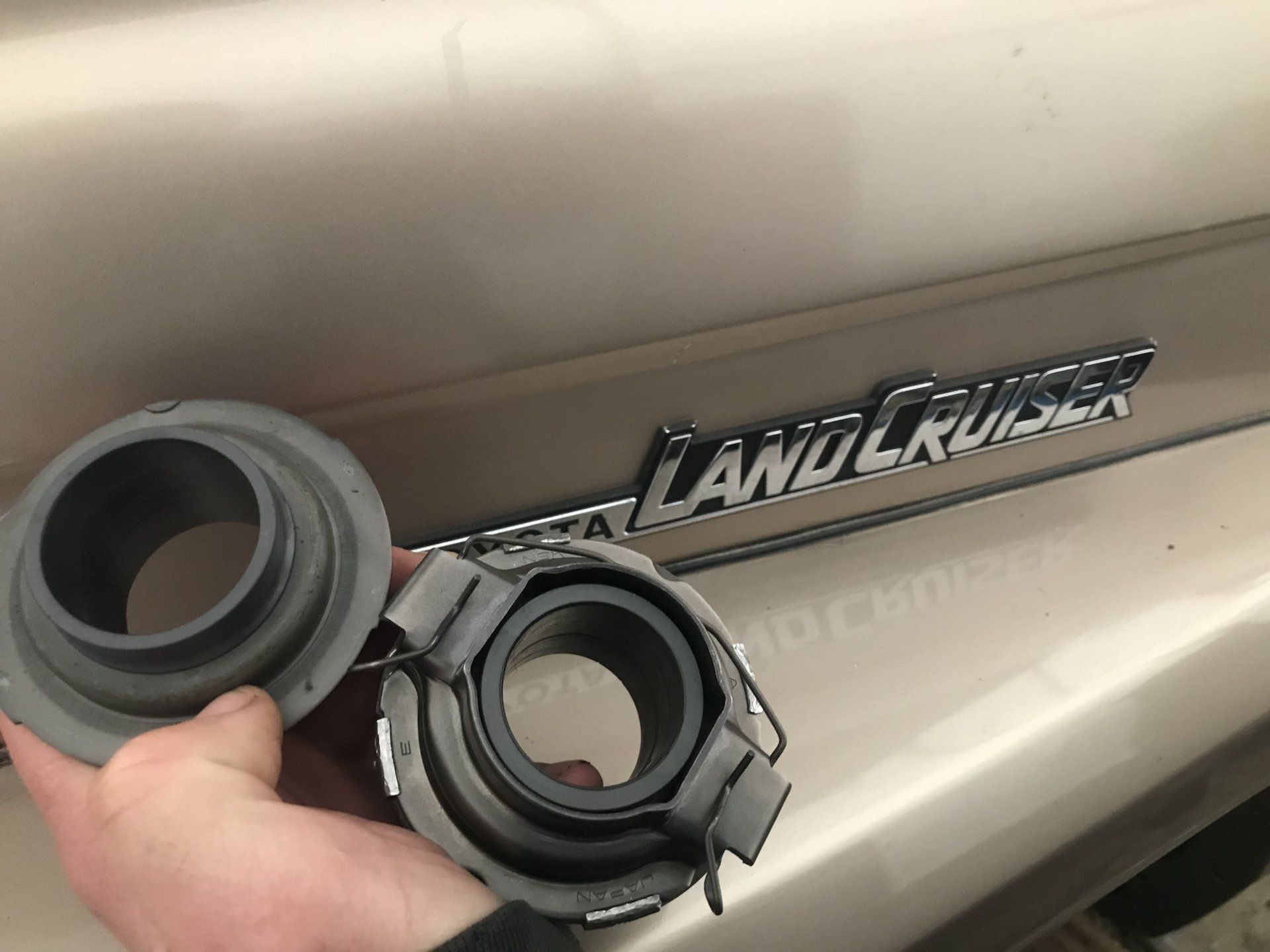

Hi there, have recently replaced mine, it's the one on the right, My truck is 1991 jdm PZJ70, with a solid flywheel replacement, I,ve had 2 PZJ70s and done them both. Ive a spare in the workshop if you like dimensions. Great refurbishment thread !

Yes, please share the part #. Yes what is the length from fork contact surface to the clutch side of the bearing?

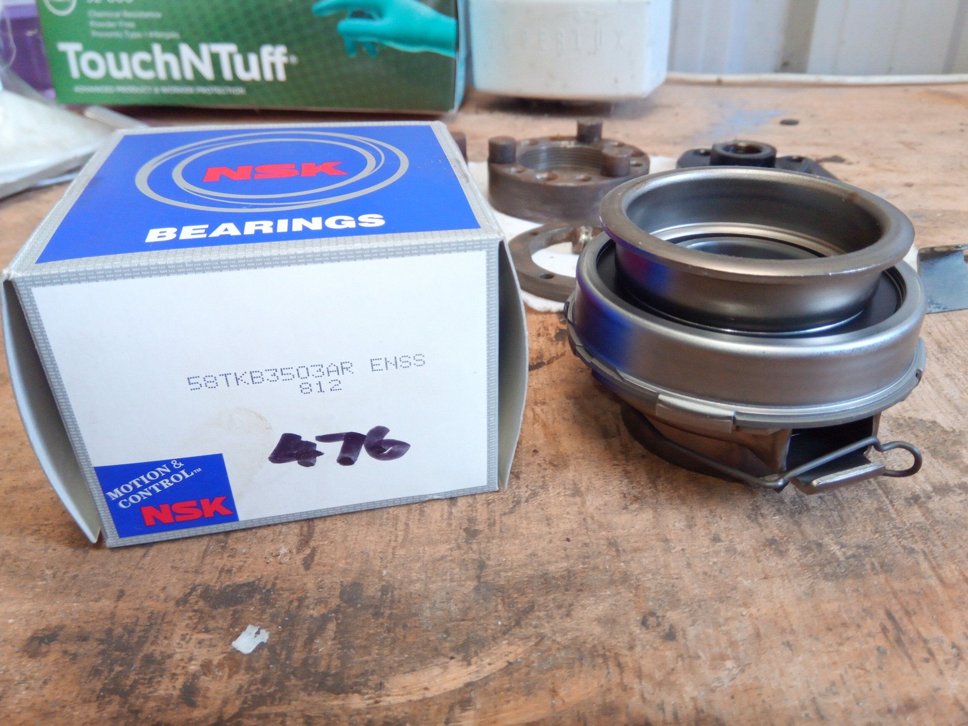

Hi there, from fork contact surface to the clutch side of the bearing is 46.2mm. P/N on box is 58TKB35003AR ENSS 812 no sure if it's true to label tho, here's some photos
Hi there, from fork contact surface to the clutch side of the bearing is 46.2mm. P/N on box is 58TKB35003AR ENSS 812 no sure if it's true to label tho, here's some photosView attachment 1943495View attachment 1943498
From my measurements that is the same length as the stock 1PZ t/o bearing.
Don’t you need to make up the difference in thickness between the single mass and duel mass flywheels?

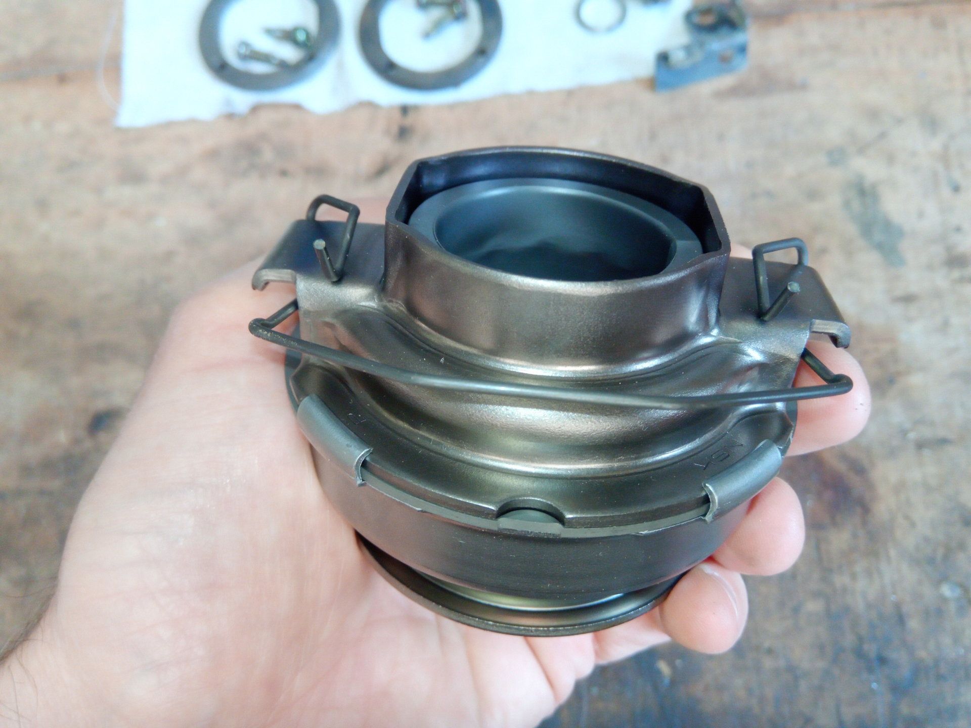

As mentioned earlier in the thread, I sourced all my parts from a thread on an Aussie forum where the guy who did it have all the details including the part number for the throw out bearing. I bought that bearing, I believe it is from a Coaster bus. It is the same length as a 1HDT H151 but obviously has a larger ID than a R151. It is also the same as an OEM t/o bearing I have for a 1HDT h151. It is longer than a t/o bearing I have for a 1FZ h151. I also have the old t/o bearing from the 1PZ as well as a new OEM one from a 2007+ HZJ76 with the R151, it is a touch longer than the 1PZ one. I have taken a rough measurement and came up with needing to be 5mm longer than the 1PZ one.

Honestly I think I had-have the t/o bearing worked out. The picture I posted of the t/o bearing above is about 7mm longer than the 1PZ one, has the right ID and is OEM.
