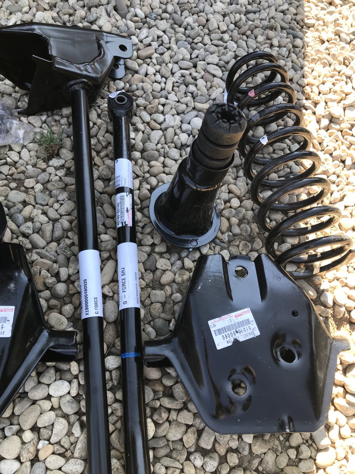

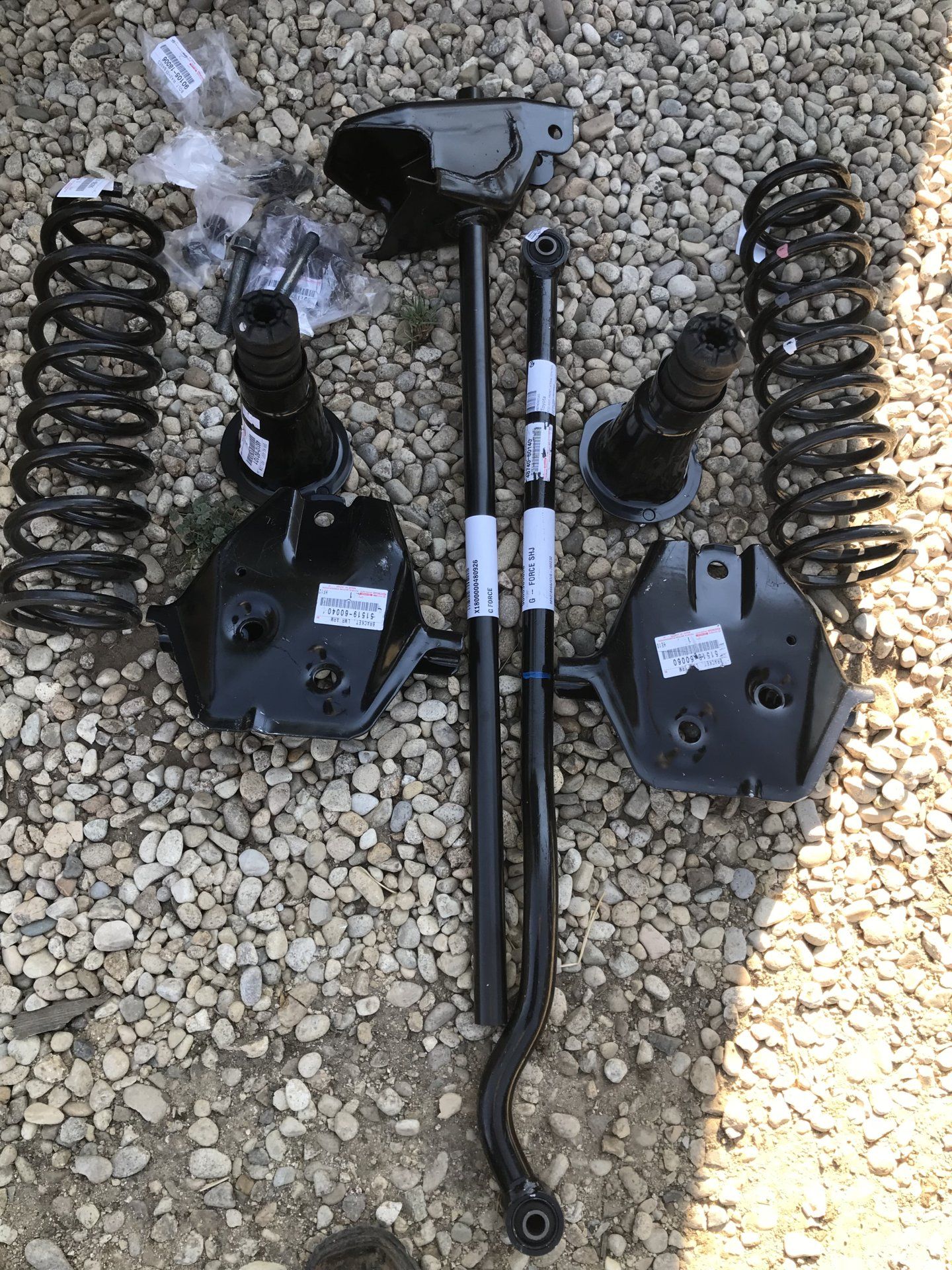

So in the last couple days I have ordered everything to convert the front axle to coil springs. After doing some research I determined 80-series parts would likely fit and work but the 70-series coil springs are a smaller diameter and so is the frame mount for the coil springs. I have confirmed the 70 to 80 series radius arms are the same. As a result I have decided to use almost all 70-series parts in the conversion to minimize any clearance issues I may encounter.
Everything is ordered and coming from Toyota, all the frame bracketry, panhard, coil springs, bump stops and more. I will be using some 2nd hand 80-series radius arms. I will scab off mounts from an 80-series housing and weld to my 70 housing.

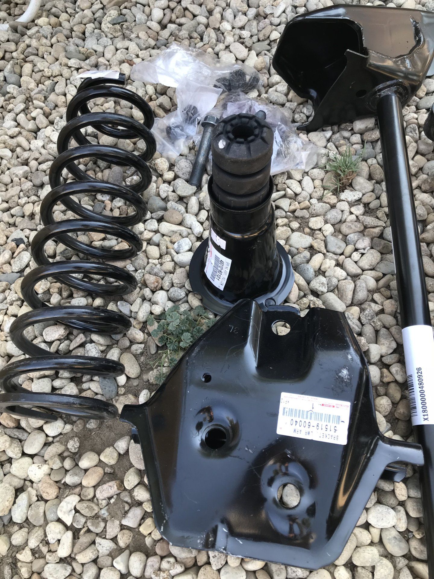

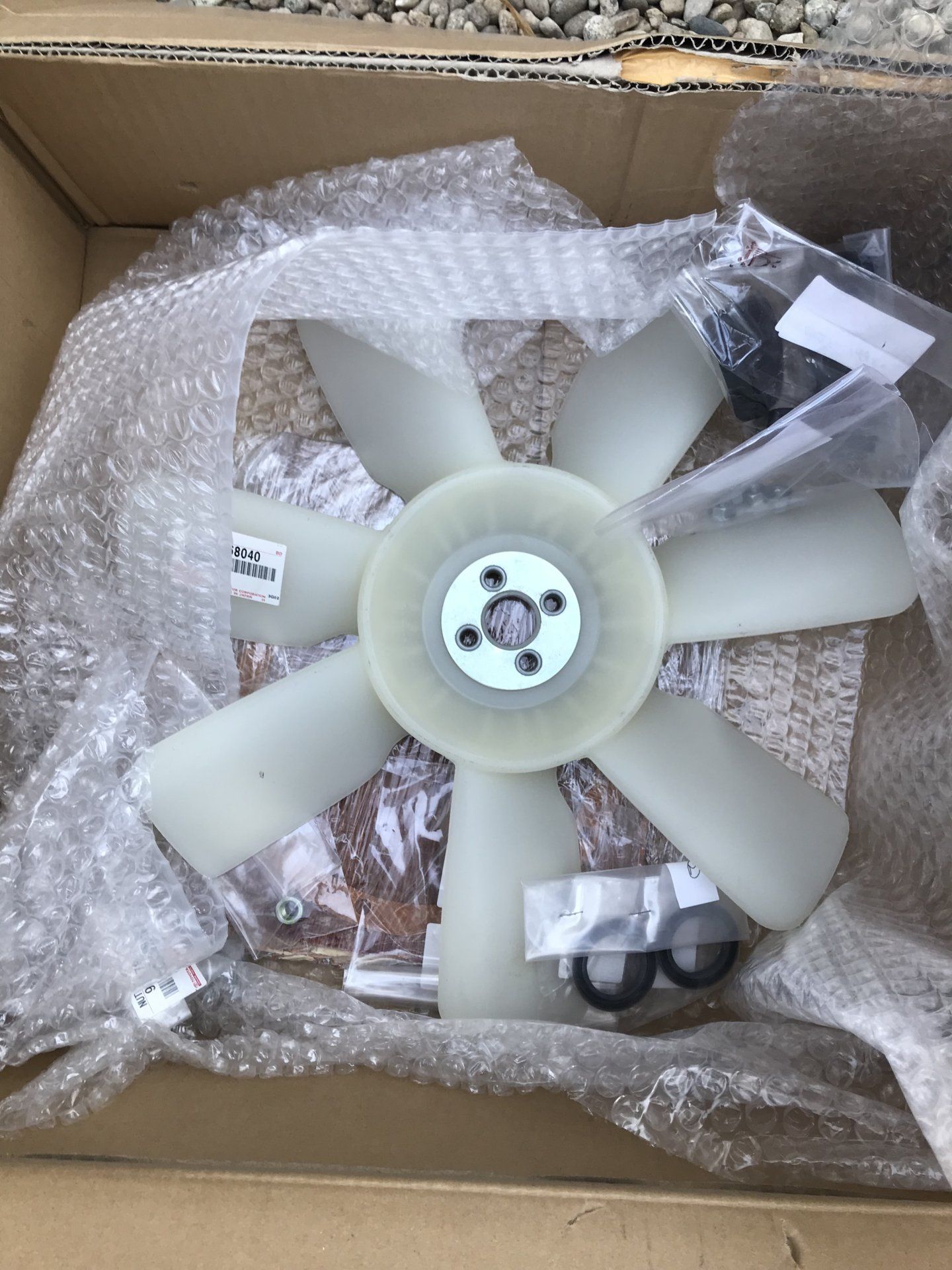

First round of goodies has shown up for the suspension conversion!
And a few other items as well...

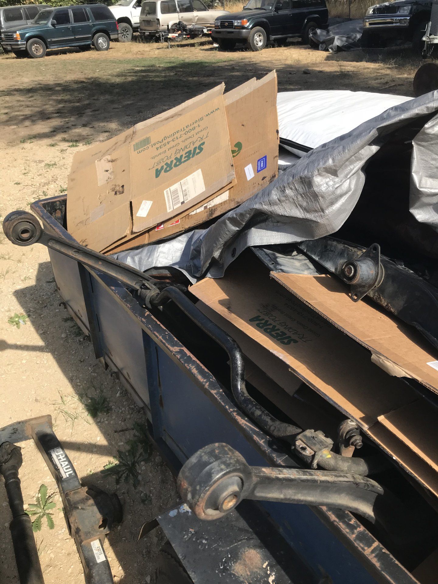

The last of the goodies I need for the coil spring conversion showed up today from Japan.
Oh ya and buried in here are the radius arms and front 80-series housing I need.

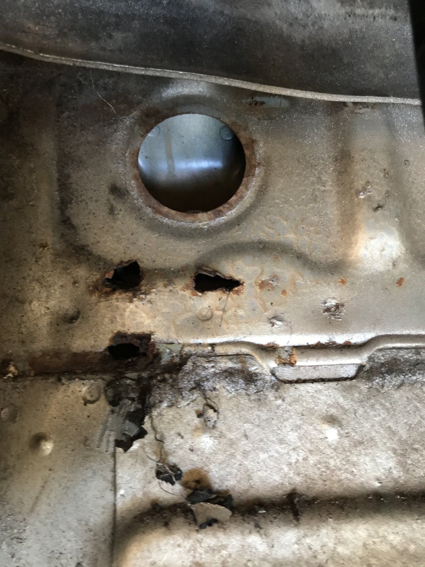

In my opinion this is very common on ALL models of Land Cruisers. None of this was evident when I bought the truck and also in my opinion this is very minor.
I think these are two of the most common spots to find corrosion on a 70-series. Front body mount in front floor footwell and in the seams of the rear floor support/crossmember.
This spot will take the most work to repair.

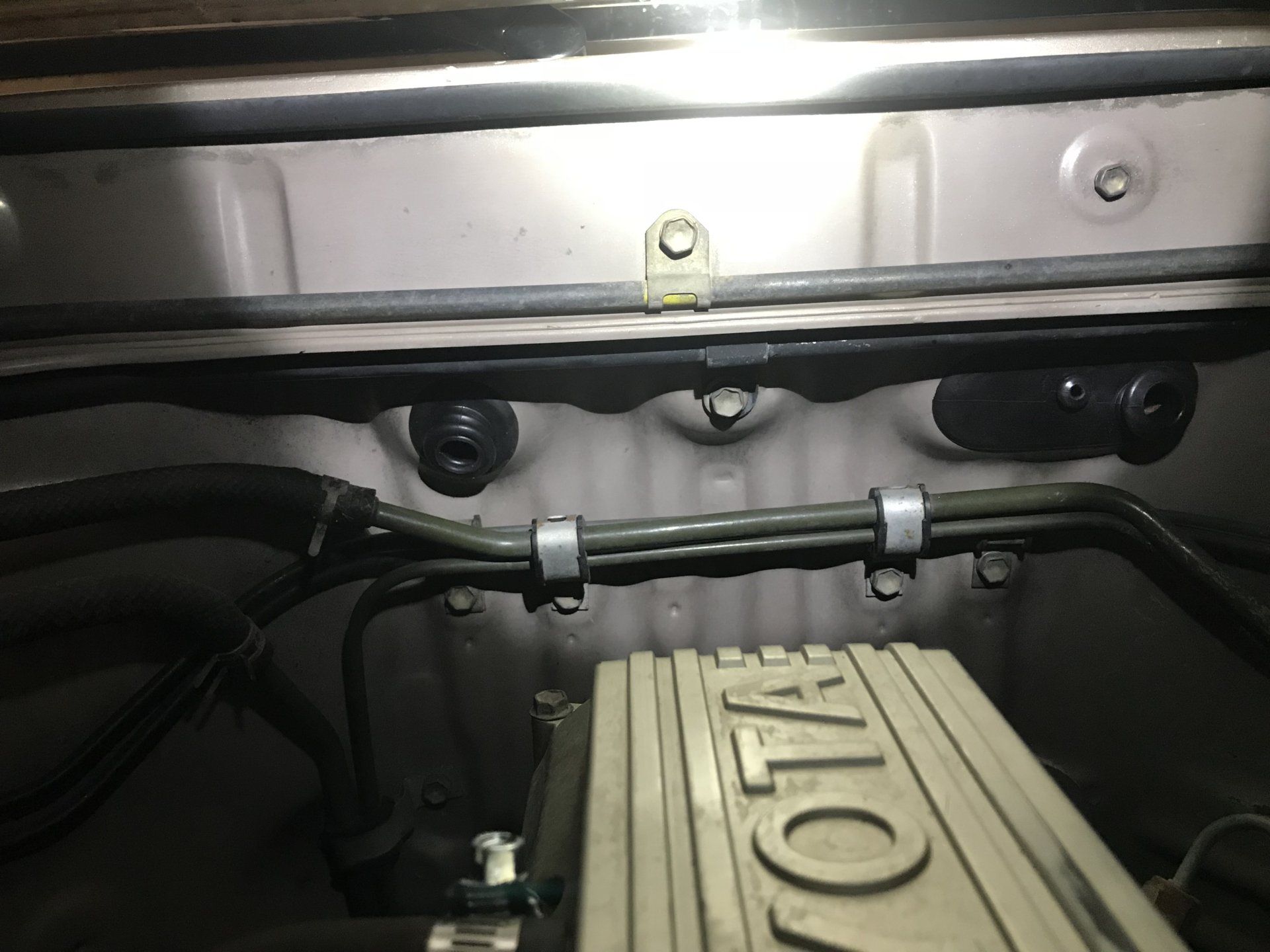

This is RHS footwell body mount. Old crappy repair I am cutting out and fixing right.
The floor pan joins the firewall here and there is a seam. On top of this the body mount collects dirt and obviously that is bad. This spot I am also cutting out.

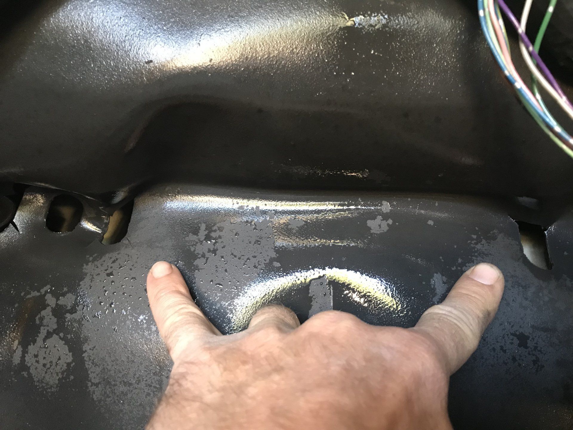

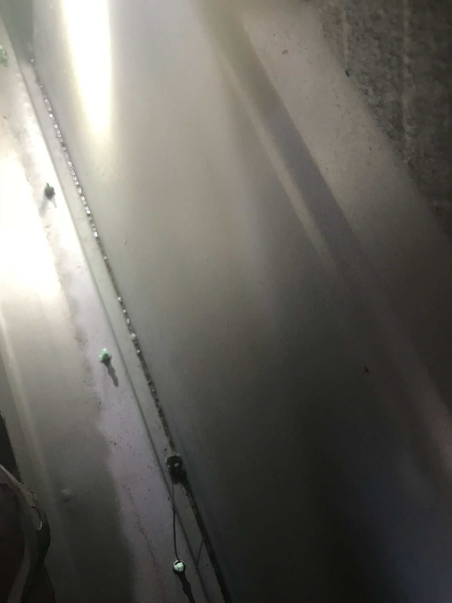

Inside rear fenders is good. To prevent future rust in these kind of locations though I am going to seal it all up with POR15.

Inside the doors is also good with no rust.

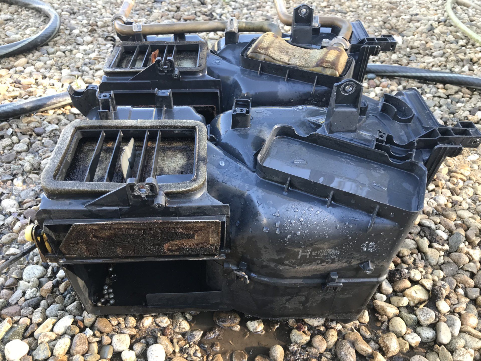

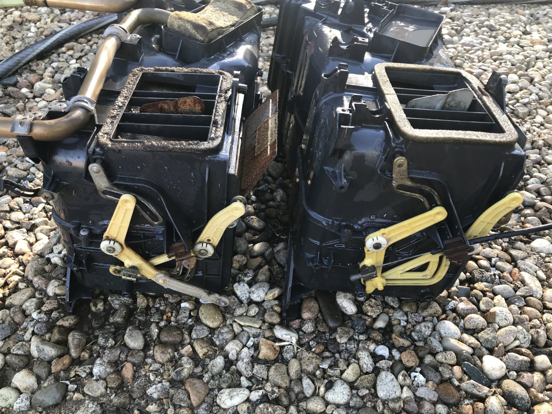

Oh ya and for those following this build for awhile, the rust repairs and POR15 treatment I am doing for free. That is also the case with the heater. In my opinion the truck should be at a certain level that meets my standards for a sale. So the new owner does have to pay for these things.

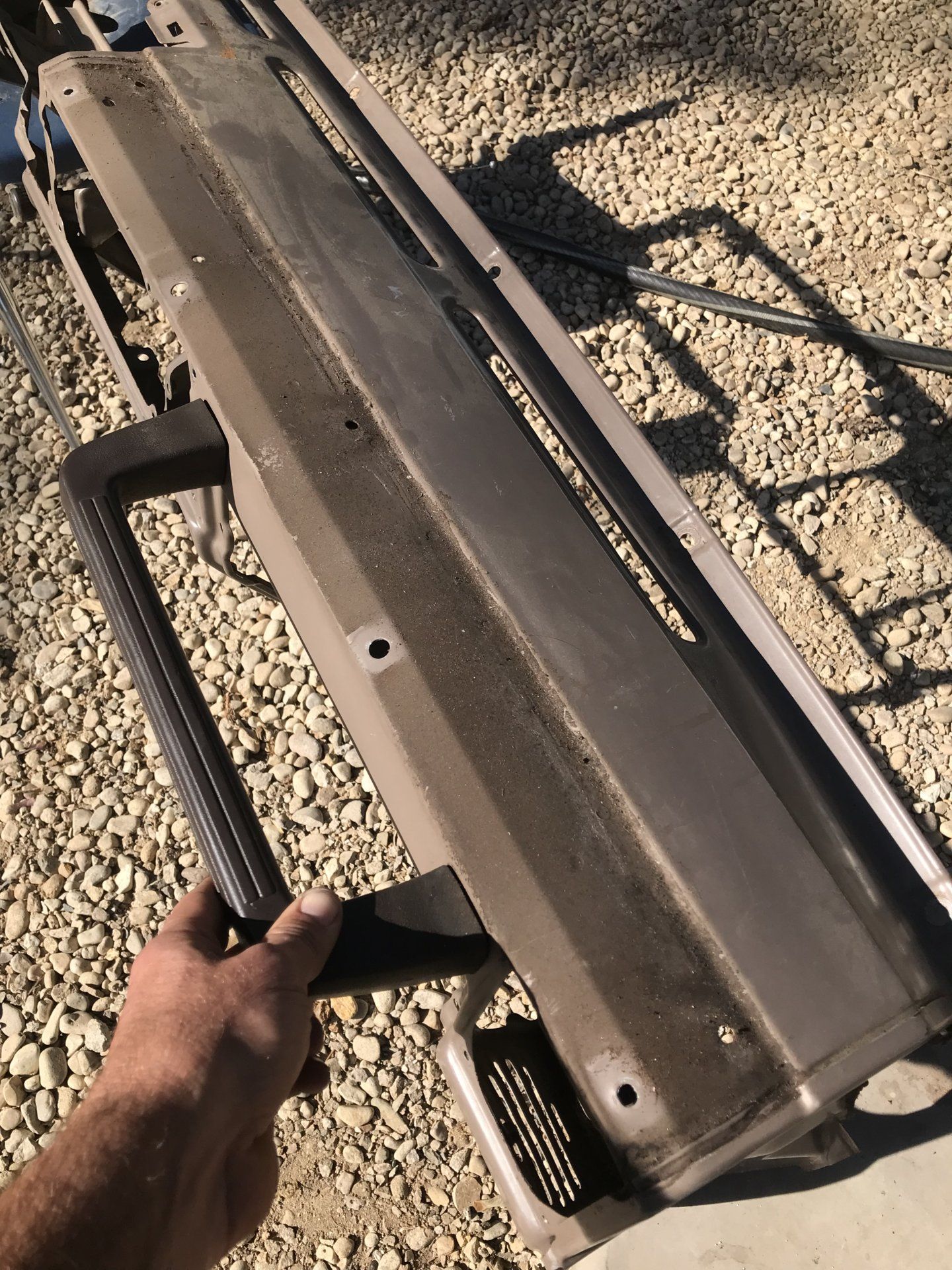

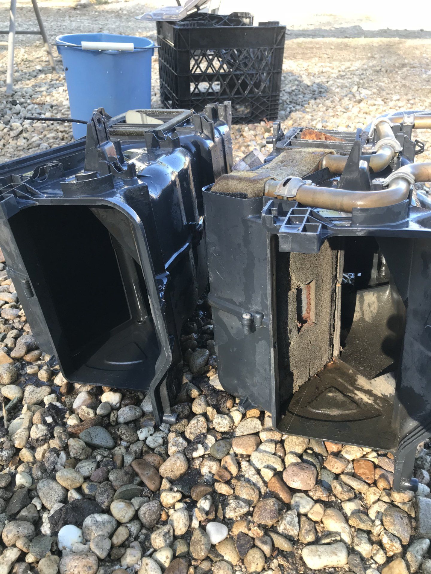

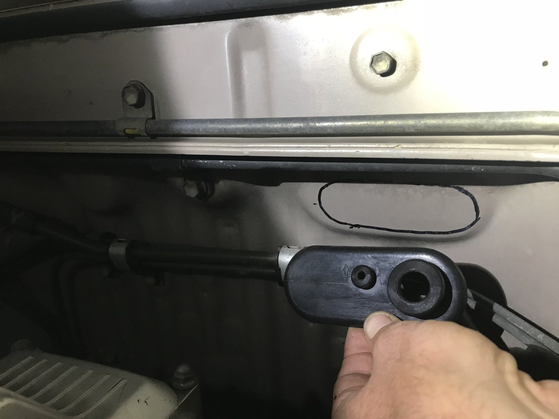

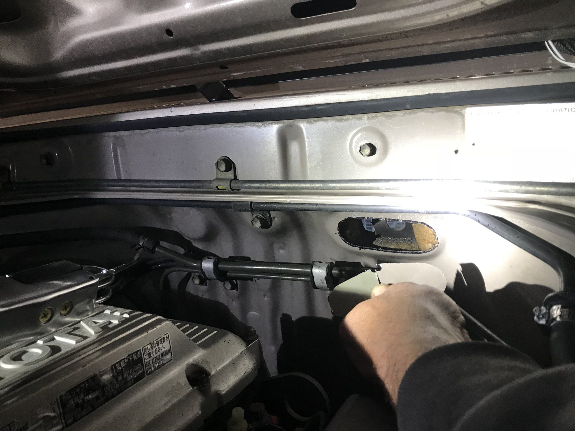

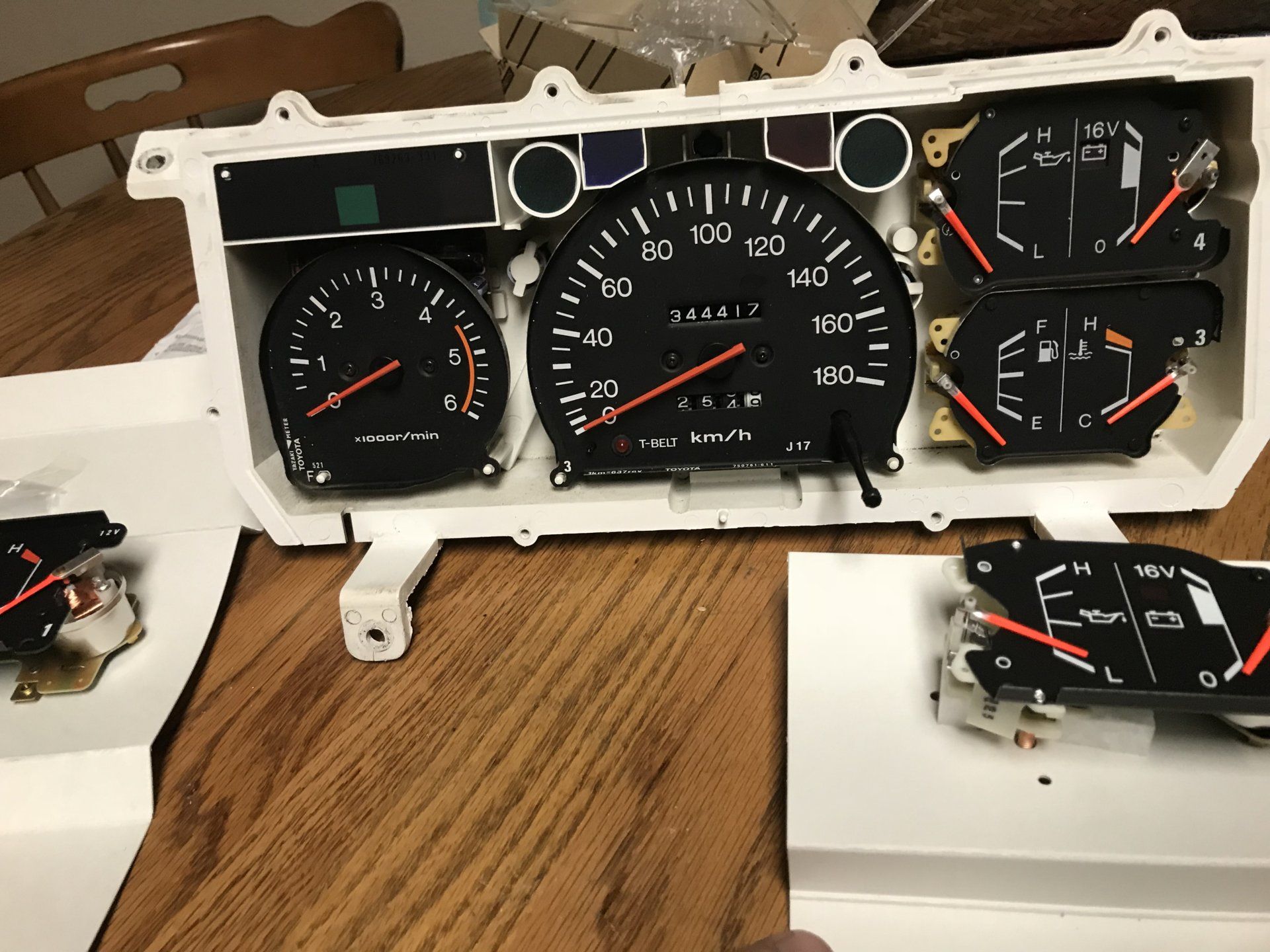

I have gone much deeper into the dash, going deeper today.

The entire inside of the truck got scrubbed down yesterday with Simple Green, three times! Good and clean, ready to start POR15 prep.

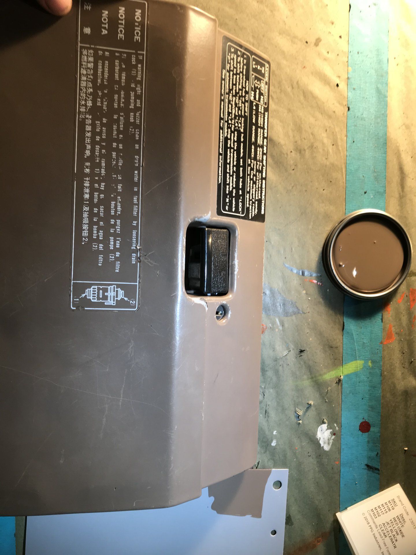

At the paint shop, just had them mix me up three cans for the dash. Going to re-paint the big piece and the glove box while I am at it.

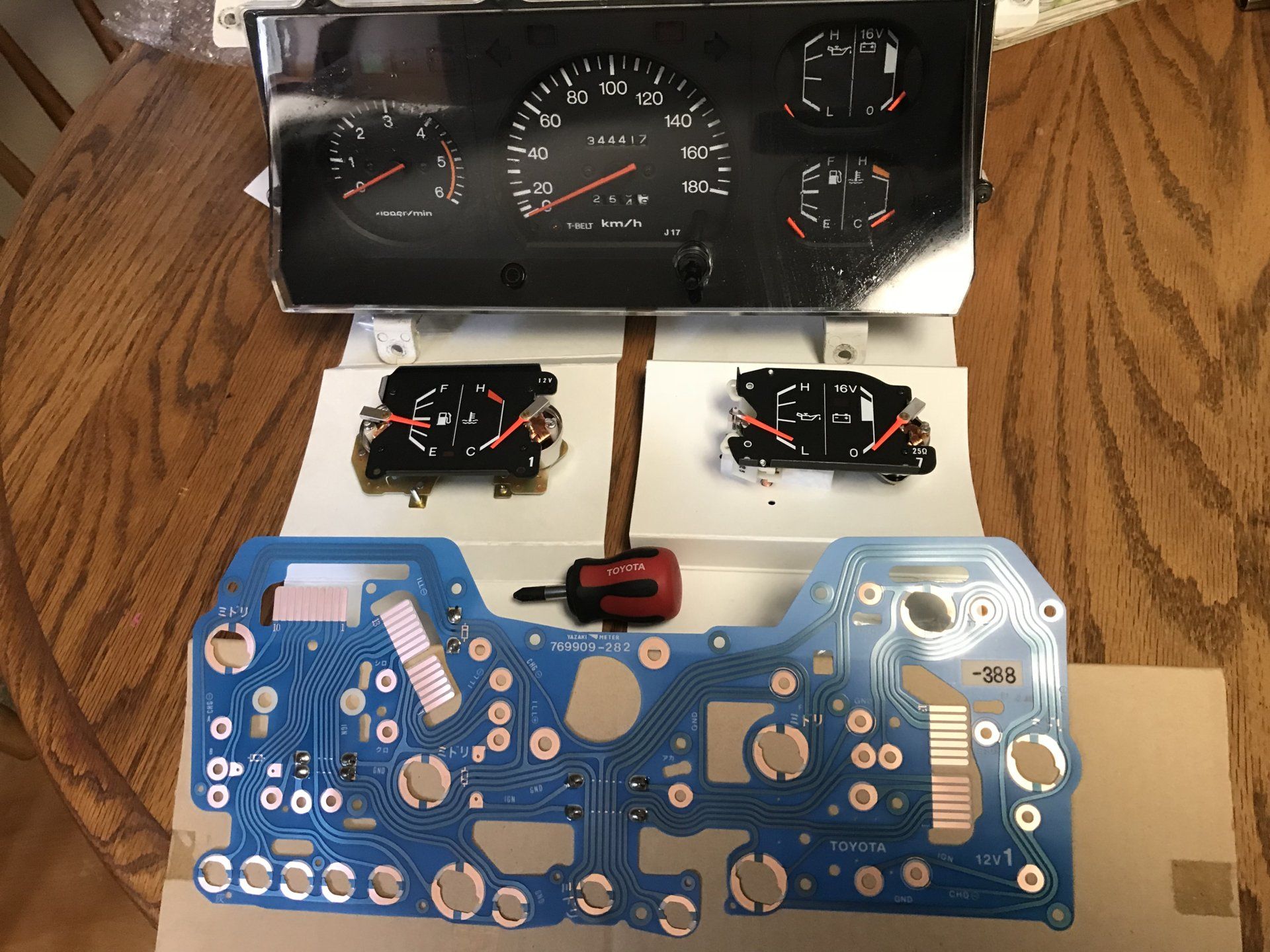

You are not installing AC as well while you have it all apart? What was wrong with original gauge cluster?
