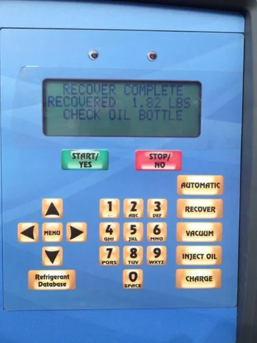

I started the process of fixing the intermittent A/C. I have a new expansion valve and dryer to install. I recovered a FULL charge of refrigerant so my issue is NOT a leak.

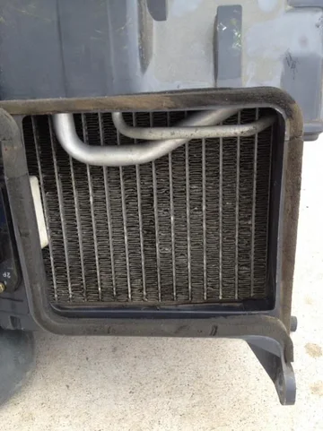

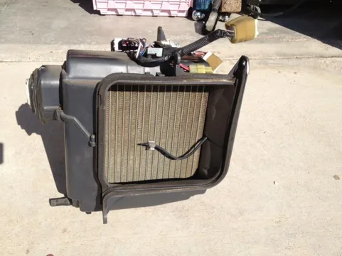

Thanks to alia176 I have started the reconditioning of my A/C system. His posts here on MUD are a real help. I got my evaporator out with no problem in about 15 minutes.

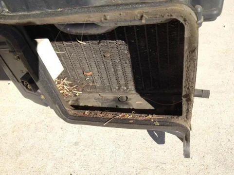

The evaporator core is so nasty! Not just leaves and debris, but coated with an oily lint like substance. I have no idea how air passed through it at all.
I am currently soaking the core in boiling hot water and dawn dish soap to loosen the crap. I have blown the core out twice with compressed air and this process seems to be SLOWLY getting rid of all of the crud.
FYI the core is laying down so the inlet and outlet are above water. I have been extremely careful to not let any water inside the core. Openings are capped and taped.
The core is very fragile. Be patient.
Everything is cleaned as well as I could. If money was no object I would replace the evaporator. The greasy lint mess was a PITA to remove. Super hot water, dawn detergent and compressed air got most of the mess. After everything was back together I ran the blower fan and it smells 1000% better than before. Increased air flow too. New expansion valve and receiver/dryer also installed. All that remains is a good leak test and recharge.

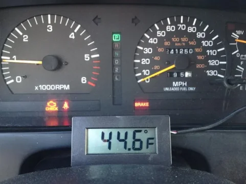

55.4 degree differential! THAT'S WHAT I'M

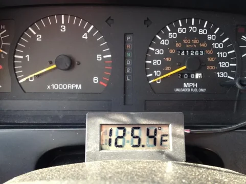

TALKING ABOUT! This pic was taken at 6:40 am, the outside temp was already 100 degrees.
We'll see how well the A/C works when I get in the car after work. It's typically 130 degrees in the car at 5:00 pm.
UPDATE:
When I got in the car at 5pm the ambient temperature was 107. I have a digital thermometer in an air vent. Here are the pics of the temp when I got in the car and after driving for 25 minutes. Needless to say I am very pleased with the results. ;)
