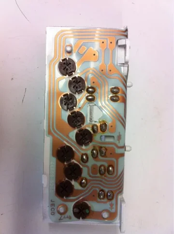

Climate control lamps:
Gear indicator lamps. PRNDL:

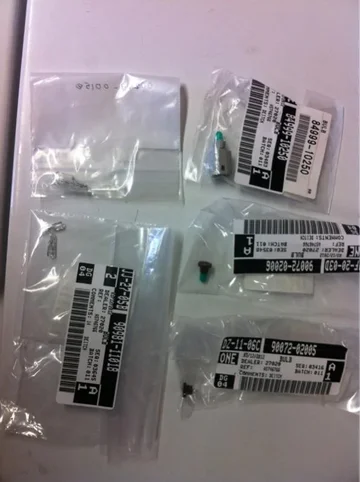

Goodies from dealership:
Fan shroud. Steering column surround. Dash light bulbs. Clock-spring contact. Throttle cable. Plug wires...
Those are older pick tags that the Parts Distribution Centers used..I thought they were all phased out already.
Where are you located if you don't mind that I ask?
Las Vegas (Henderson) Nevada.

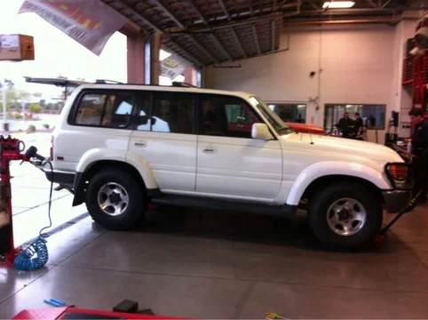

I went to Discount Tire today and got all five of my Falken Rocky Mountain ATS tires mounted. (285/75-16). Based on comments posted in the Falken Rocky Mountain ATS tire thread in the 80 section, I had them filled to 50 PSI. The first thing thing I noticed was how quite they are compared to the 265 Michelins they replaced. Slighly more effort required to turn from stop or very slow speed but nothing major. It was pouring rain the the vehicle felt very confident at all speeds.

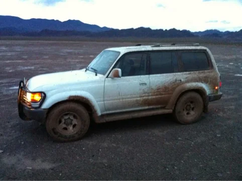

I met my son at the dry lake for some fun in the mud too.

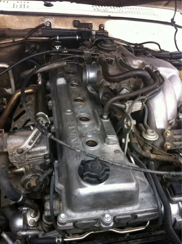

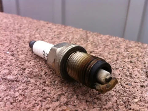

Here's what actually happened today:
1) hood struts replaced. I can now work under the hood without a prop rod nor fear of being bashed in the head.
2,3,4,5) All ignition components were replaced. Good news: Removed all factory parts. Bad news: I believe the where the original 1994 parts. (Plug wires were dated 1994)
I made sure the valve cover and surrounding areas were all clean and free of debris before removing the old wires. I also vacuumed the plug holes before removing the old spark plugs. Thank god I have the special spark plug tool. It's a long way down to the plug.
I did not get around to doing the engine flush but instead installed the new fan shroud. (Mysteriously missing when I got the car.) 110F+ temps coming soon to Southern Nevada. I removed the fan/clutch and was shocked on how grungy, caked with deposits, the clutch was. I separated the clutch from the fan and cleaned both in the solvent tank.
I also removed the battery and battery box to make installing the fan shroud easier so I cleaned that too. No battery hold down present... WTF?
I was going to replace the throttle cable but the factory replacement I have is not the correct part. ;(
As the sun was setting, I replaced all three wiper blades and topped off the washer fluid.

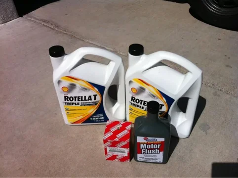

Finally... Today I completed the engine flush and oil/filter change.

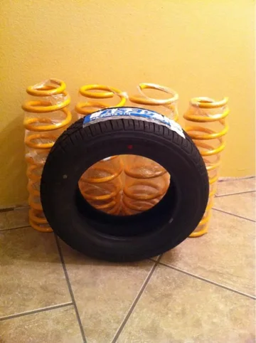

EXCITED! My TJM lift kit from TOYtech lifts was delivered today.
The springs are F'in huge! Here's a shot compared to a new Yokohama 165/60R12 tire. (Big tires for our classic mini)
I can't imagine what 6" lift springs look like.

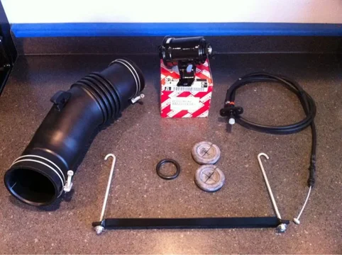

New OEM parts: intake hose and clamps, throttle cable, fuel filter, battery hold down, battery box/cable grommets, oil fill seal. Getting there little by little.
