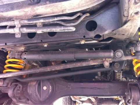

I just installed the last piece of theTJM 2.5" lift kit: the steering damper. It wasn't too bad. It took two different pullers to get both ends of the old one free. (anti-seize on the new hardware.) Quick test drive confirms what other MUD threads have said. New damper helped to remove some of the vague steering feeling.

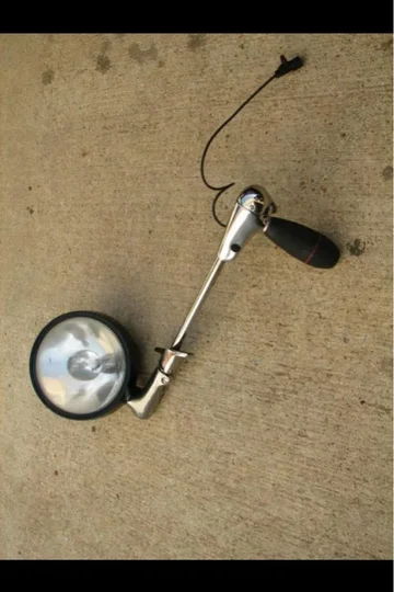

My latest E-Bay score! I'll be installing it as soon as I get the correct mounting kit.
The e-Bay spot light arrived as did the new mounting kit from Unity. Maybe this weekend I'll get it installed.

Started the spot light install tonight. I bought a new mounting kit from Unity specific to the Land Cruiser. (#27) The kit came with excellent instructions, all necessary mounting hardware and drilling templates.
I used the correct template to center punch the two mounting holes. And then I drilled the two 1/8" mounting holes per the instructions.
After drilling the two mounting holes, attach the exterior mount. The mounting kit includes a drill guide that is used to aim/hold the 1/2" bit used to drill the main hole.
After drilling the large hole through the external sheet metal I removed the mounting bracket to inspect the internals of the A-pillar.
I was aware there was a wiring harness and sun roof drain in the A-pillar that I did not want to damage. After drilling the first 1/2" hole I could see that a black tube was in the direct path of where I needed to drill. I used two small screw drivers to move the tube out of the way while I stuffed blue shop towels in the A-pillar to hold the tube out of the way. When I was satisfied the tube would not be hit, I reinstalled the mounting bracket/drill guide. Before drilling through the interior sheet metal I also lifted the headliner away from the inside of the A-pillar so that it would not get wrapped around the drill.
Here's a shot of all of the holes after drilling. I did clean up the large hole with a round file after this pic was taken. Main hole is oblong due to the angle held while drilling.

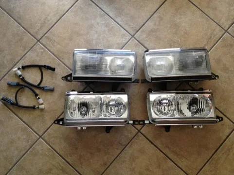

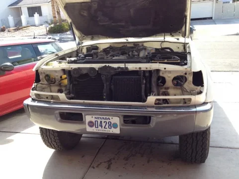

The headlight housing on the driver's side has been starred since I bought this car. The other night the low beam bulb went out on the passenger's side so it's time to finally install the DEPO housings I bought months ago.
Can you tell which lights are the new ones? ;)
Harness adapters from Innovative are nicely made.
Sylvania SILVERSTAR bulbs. I have used these stock wattage bulbs in other vehicles. They are very bright and white.
Test fit. Housings fit like OEM and the bulbs work perfectly.

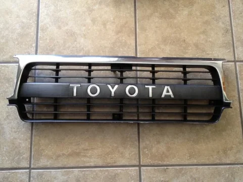

I think I may 'murder' the grill while I have it off. What are your thoughts? I like the look of black with chrome. I think I will use a satin finish not flat or gloss.
After about an hour of cleaning and scrubbing the grill is ready to be masked and painted.
