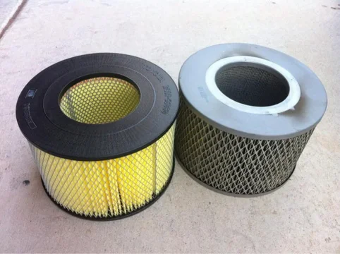

Don't forget to check the tuna can when changing the air filter.
I was following your previous thread, glad you went with the locked 94.
From noob to noob, welcome!
I have to agree Moonglow is superior. White is a distant second, but I digress.
Tuna can?
I did some wheeling with my son today. He in is jeep XJ and me in the cruiser. We both can appreciate lockers now. ;)
Tuna can?
Small canister underneath the air filter canister, it's held on with 2 clips.
Part of a cyclonic pre-filtration system (heavy stuff goes around the outside, falls into the tuna can, lighter stuff gets caught by the filter, and happy air goes into the engine)
There have been some interesting things found in these.
Not a bad thing to check at every filter change. Some check them at every oil change for good measure.

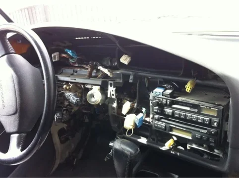

More time today to work on the Cruiser. I disassembled the dash today to install my CDL switch ;). While I was at it I checked all of the various dash bulbs and found several that were out. I also discovered a jumper in the socket that mates to the CDL switch. I will need to remove this when I install the switch. What is the purpose of this jumper? Do I need to do anything other than install the CDL switch to be able to engage the CDL at anytime? (NOTE: I created a separate thread for this question.)

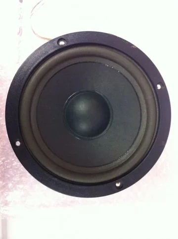

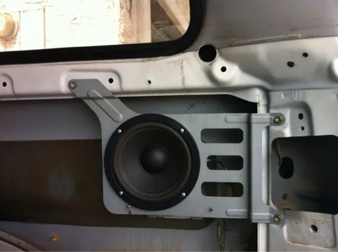

I also got my replacement subwoofer installed.
