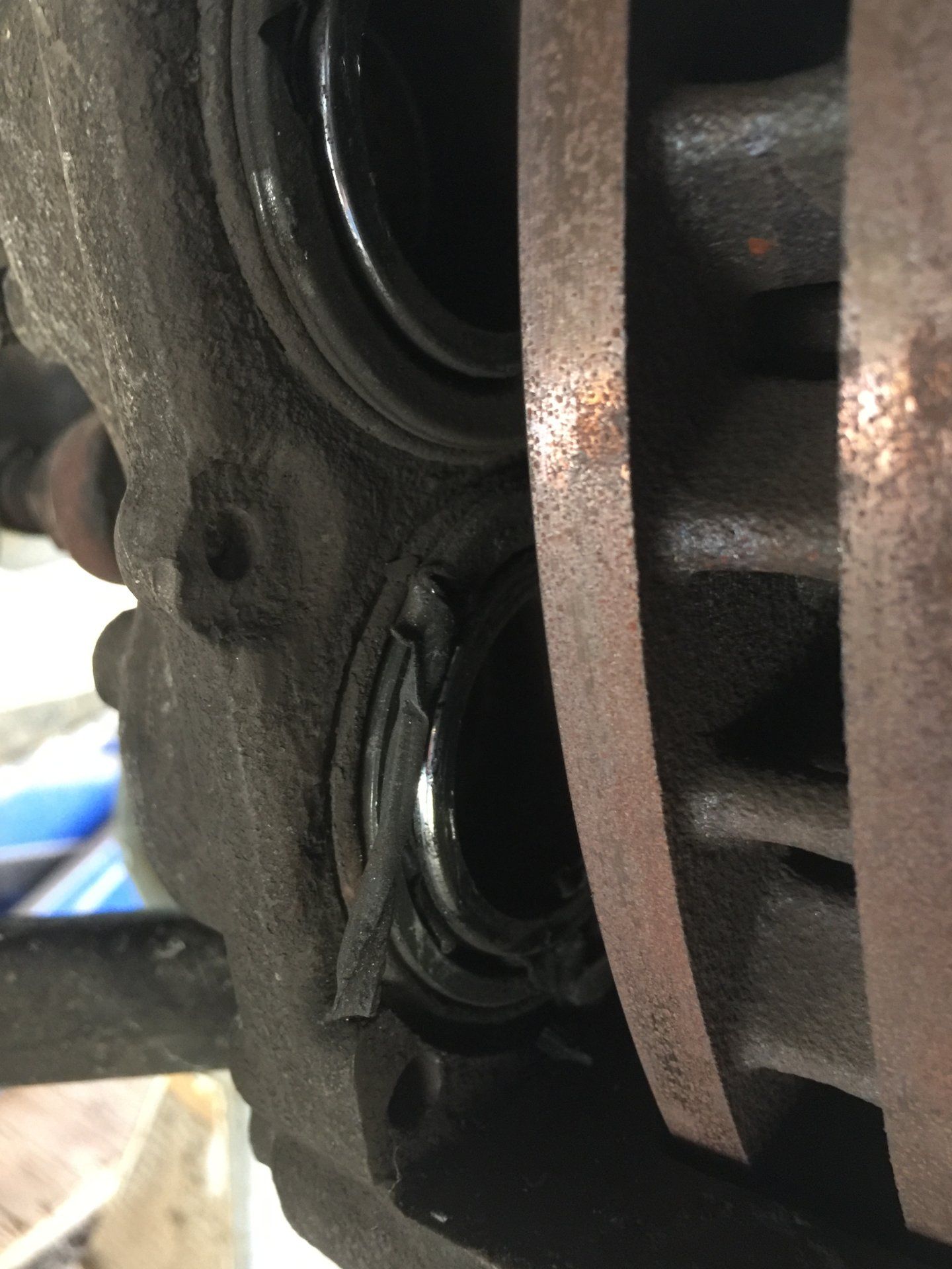

To inspect for a sticking caliper on multiple piston calipers, look at both the inner and outer pads on the same wheel. If the inner pad is more worn than the outer or vice versa, you may have a sticky piston in that caliper. On an 80, the front calipers have four pistons...two pistons on each side of the rotor (rears are just one piston on the inside). If, on a multiple piston set-up, you have a sticky piston on one side of the rotor and not on the other, the good side will "outpush" the bad side. When the force applied to both sides of the rotor is not equal, it becomes a break pad shoving match and rotor will get forced sideways toward the weaker side of the caliper every time the brakes are applied. The rotors don't like this and they will tell you so...especially in a 70-0 stop situation.

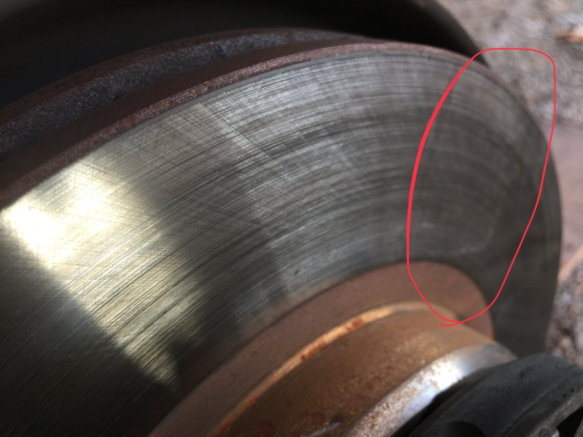

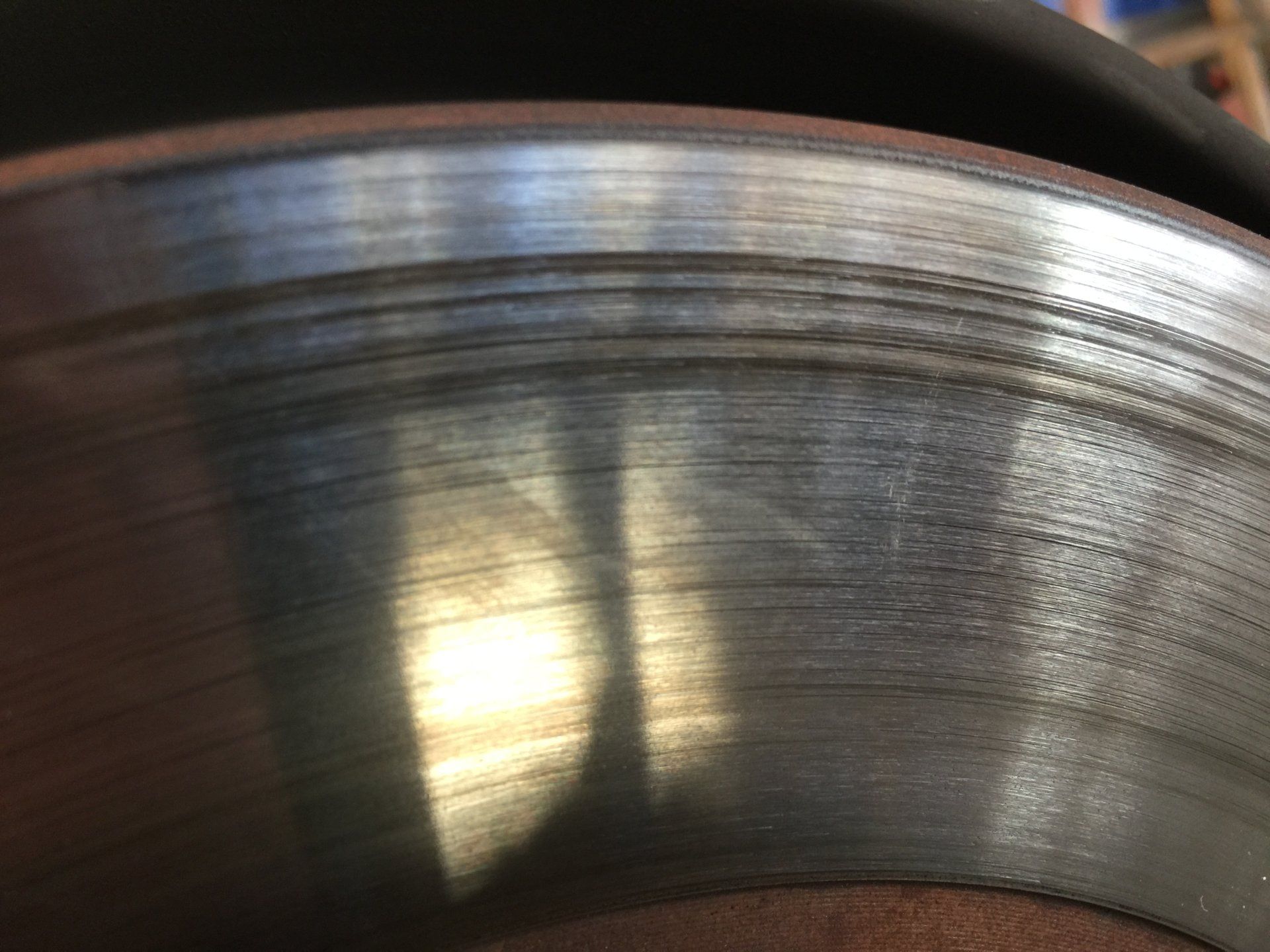

Just a quick update, Last Friday I finally got a chance to take a look and see whats going on. Big thank you to @Green Hell Mustang and @GLTHFJ60 for helping me look it over. It's comforting knowing that there others as crazy as me to work on a cruiser even when its 24°F
The previous rotors I had were confirmed they were Warped. My guess would be due to uneven pressure applied to the each caliper piston.
Current findings were a combination of things:
  • Stuck piston in the calipers on the both sides
  • Improper bedding.
  • Pad material transferred unevenly.
  • Pad Imprinting

Passenger Side Caliper
Passenger side Rotor
Driver Side Rotor with visible pad imprinting.
