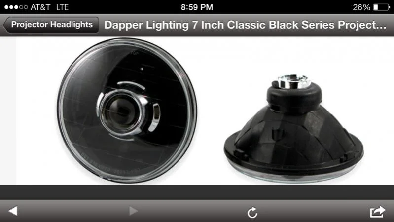

^^^ They come in black too!

Regarding the Dapper Lighting units, I find it hard to believe that they can fit a projector into a standard 7" semi-seal reflector, without compromising the performance.
Most of the good projectors are around 140mm in depth, so can't possibly fit.
Saw a lot of traffic from this site, thought I'd chime in on our kits. The projector is only about 112MM in length. We are using a 42/46MM projector which is pretty much the smallest around right now. We do have another projector that uses a larger projector but it protrudes outwards to give the "bug eye" effect.
http://www.dapperlighting.com/collections/projector-headlights/products/7-modern-projector-kit
The Classic model isn't the best performing projector on the market but is a significant upgrade from stock sealed beam headlights. We designed the kit to fit into 99.9% of vehicles without having to modify the brackets. A 140MM projector plus the HID bulb sticking out can cause owners to have to cut and drill the back of brackets. It may not be an issue with your vehicles.
Here is a decent comparison shot between sealed beam and our Classic kit.
Hopefully that clears some things up. Let me know if you guys have any questions.
