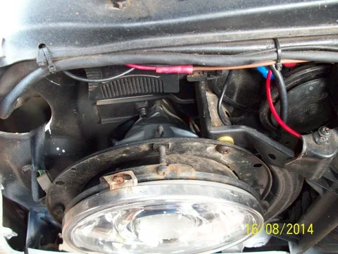

Well I have eventually got around to fitting the FX-R 3.0 projectors and Apollo 3.0 shrouds to my HJ60. This entailed 2 days work to fit them.
I had previously fitted a HID conversion kit to my standard semi-sealed units.
This improved the light output a great deal, but the low beam had a lot of light scatter and no distinct cut off.
I got a set of crystal light units with clear lenses. I used a heat gun to soften the adhesive and removed the glass lenses.
I then cut away the plastic reflector until the projector just sat clear of the inside of the glass lens.
I had to shorten the shroud so it fitted over the projector inside the housing.
Next I attached the projector to the housing with epoxy putty and refitted the lens using the heat gun and the original adhesive.

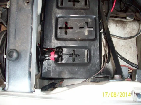

Fitting assembly to the car involved removing a lot of metal from behind the light area and the battery trays. I even had to space out the attach points with washers to clear the front side of the batteries. (See the attached pics.)
I am very pleased with the outcome. Great light and a sharp cut off on low beam.100_1652.webp 100_1651.webp 100_1648.webp 100_1660.webp 100_1647.webp
