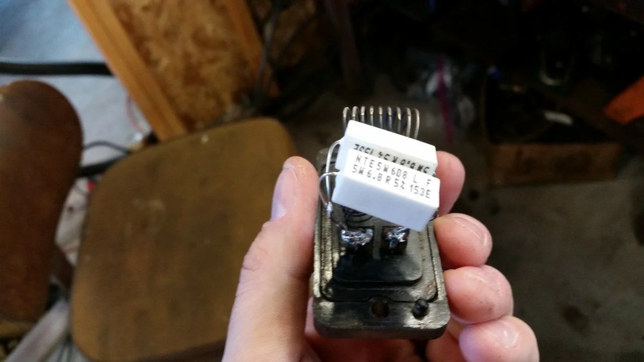

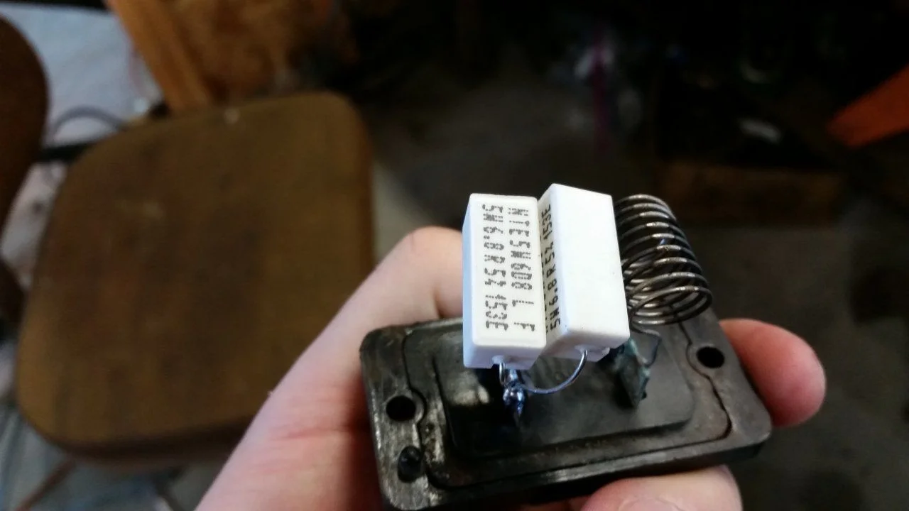

And I guess while I'm at it, I had a resistor fail on my low setting for my fan. No way am I paying $45 for a new one without first trying my hand with the soldering iron.
What I ended up buying was two 5W 6.8 Ohm resisters and wired them in parallel so that means I'm at 3.4 ohms + med and high which I did not take the time to measure. Suffice it to say my heater works much more effectively now at low RPM, though the fan isn't as quiet.
Total price:$2.16

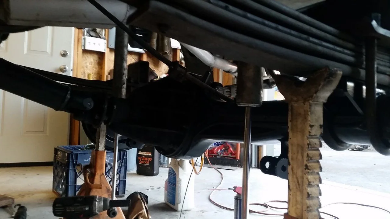

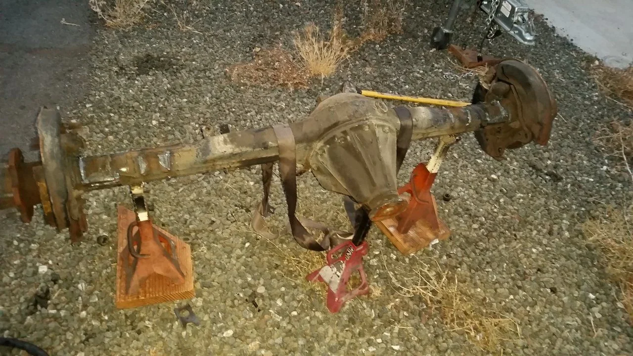

So it turns out my front axle has grown a bit in WMS. And I don't like wheel spacers. Or drum brakes. And let's be honest - full-floating hubs look bad ass.
Time for an FZJ-80 rear axle. I measured and I didn't need to recenter this thing at all. The pinion is only offset about 3.5" off center - which equates to about 6* of driveshaft angle. This is completely fine on a single-cardan style driveshaft.

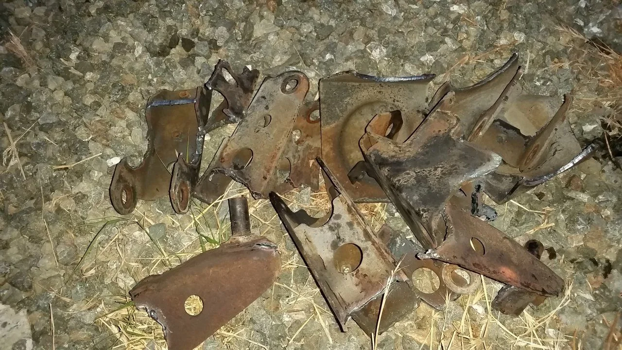

Pile of parts.
Grinding welds sucks. Seriously. I have a 7" grinder and it still took forever.
Perches burned in. My parts 9" tribute axle in the background.

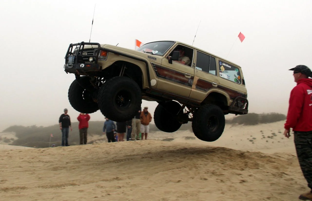

Just a FYI, cruiser axles and jumping sometimes doesn't end well..
Jim seems to do okay,
pismojim_2980-jpg.963977
But Stayner generally doesn't
(Can't find the pic of Bill Stayner's big with a very sad front axle..)
Toyota axles and jumping in general don't fair well. This I am fully aware of.
The air-out reference was really in jest. I don't really plan on airing this out.
