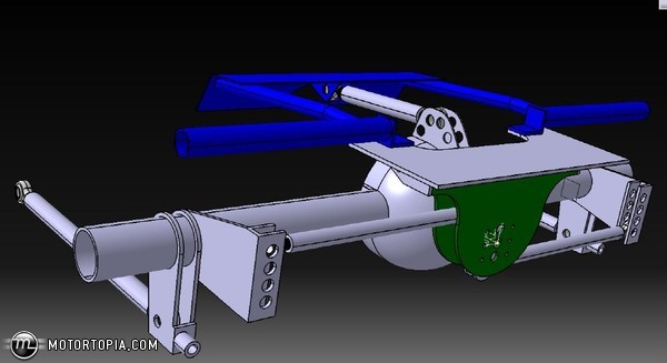

What is this link configuration called?
Out of curiosity, I swear.
Don't think I've ever seen anything like it.
Its common name is an a frame rear.
Rangies had them from day 1.
It was worked on as a bolt in version, and on this light rear ended no rear bar, no rear wheel carrier vehicle it worked, but on an 80, rear steer became an issue.
You will be able to go to this sort of set up for more flex, when you change our shocks to coil overs, half way down the arms :cool:
Have been wanting to try this type of set up at some point too, but travel may be more limited than a frame.

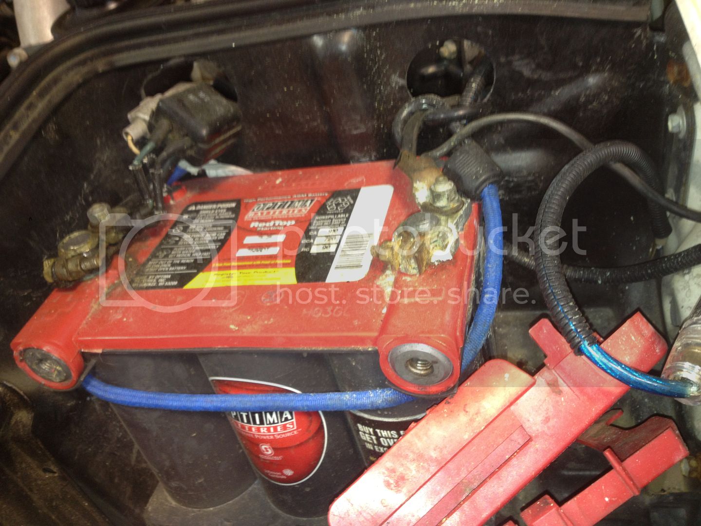

And replaced the P.O installed occy strap, with factory bracket on a die hard battery

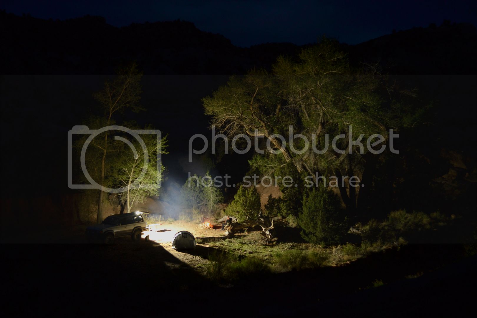

Then, it was time to head to Cruise Moab 2013, first night camping out of SNOWY on the Kokopelli Trail.

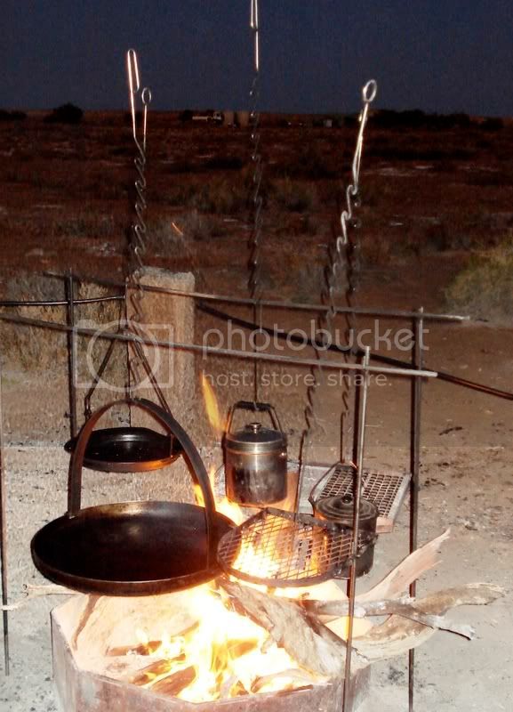

As for the cooking gear, some may have seen the expedition mounted stove thread, we use a very compact system we make here in Aus, which fits all the firesticks into a 2" pipe with a screw on cap, so no dirty bits, and the pot [camp oven bottom] , pan [camp oven top], griller[fits in same bag], camp oven [pot and lid combined] all fits into a little canvas bag.
Makes cooking on the fire pretty safe, no ash in your food, height adjustable for heat, no bending over the fire, smoke in your eyes, to get it cooked. I will have to get my table on the wheel carrier for the next trip too!

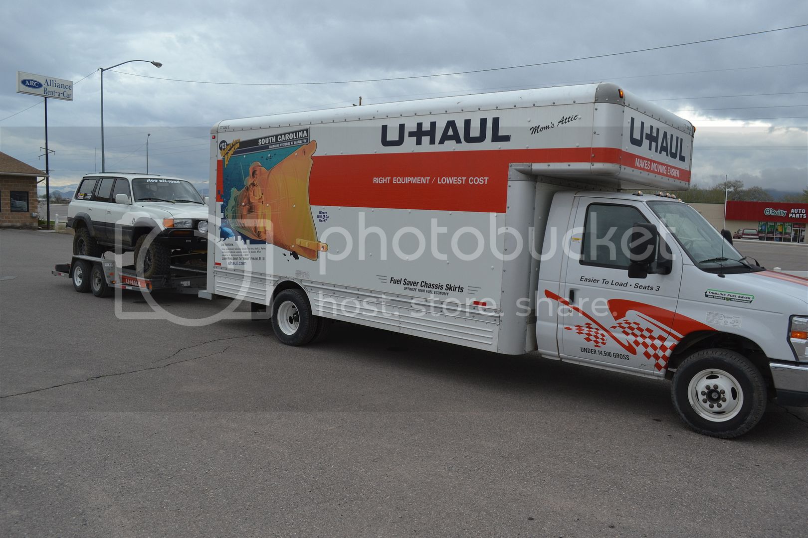

After our run around from Slee Offroad, to Moab, Arizona, camping in the Grand Canyon, to Vegas, and back to Slee, we managed to lose a part of the head gasket, which was obviously fairly important at the time, because it was stopping the water getting into the cylinders while it was there.
Once it was gone, we were managing to convert about 5 litres of water per 5 miles into steam, which was leaking out the exhaust pipe, while we limped into Ritchfield, and found a Uhaul dealer, who had a truck, and trailer.
So the last leg of this particular trip ended up with SNOWY being trailered the last 500 odd miles, on the last day, as we had a plane to catch from Slee to L.A, to meet our flight home to Australia.
The funny part was, the Uhaul climbed over some of the mountain passes along the way including Loveland pass towing SNOWY, faster than SNOWY would of gone over on its own.
