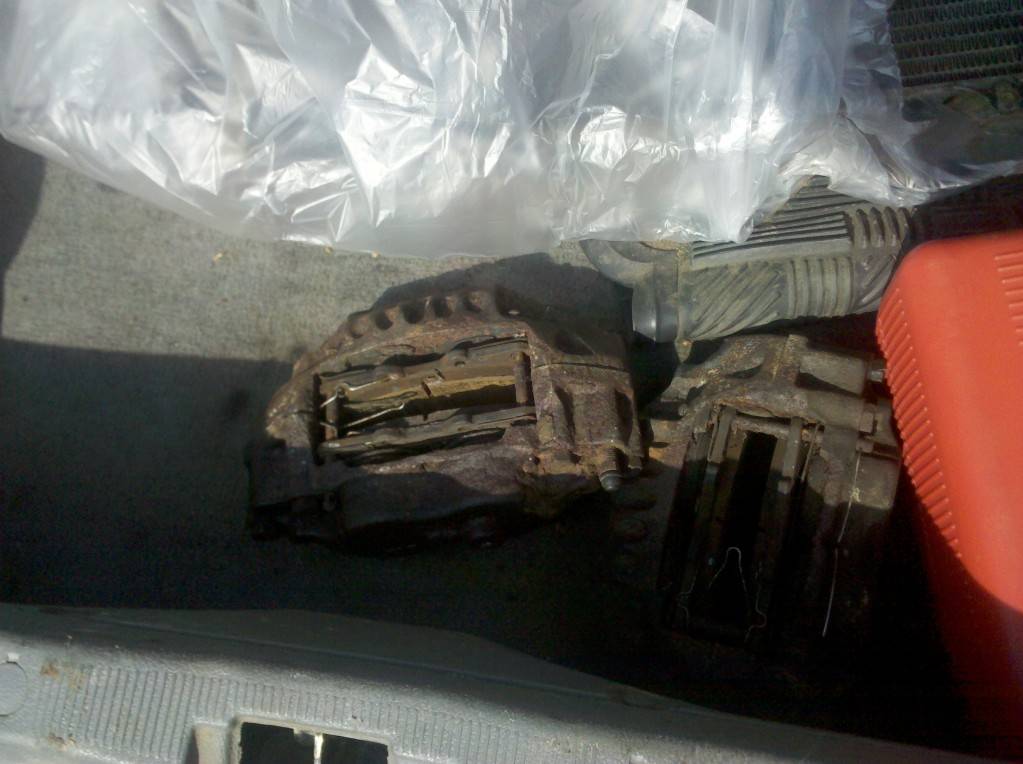

V6 Brake MC, dual diaphragm booster, and some v6 4big piston calipers.
This should help me stop mo-betta with the 33s(which are still not in stock:frown: )
a bit rusty, but i'll clean them up and see if they work. If not, core charge!

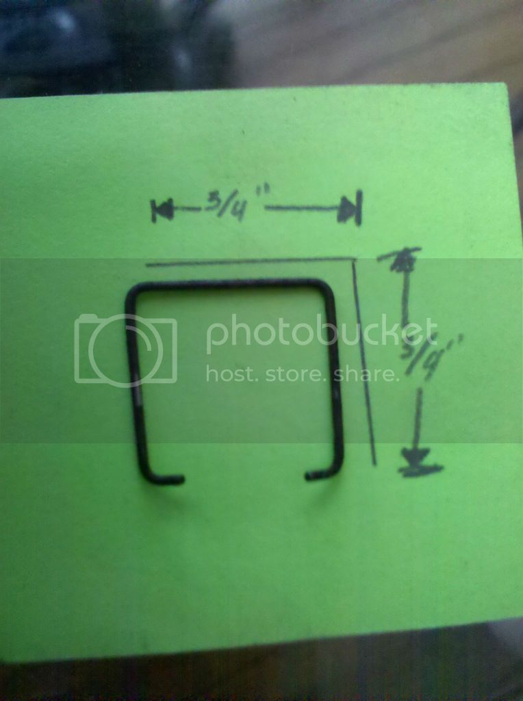

I've lost a few pieces, but these in particular
They are the little lock clips that hold the electrical connectors for the fuel injectors and some other connectors.
The parts stores look at me like i'm crazy when i ask for some.
Do i need to go through toyota to get these? They seem simple enough that it shouldn't be a Toyota only part.
I need 6 of them to hook the connectors back up. I'd rather not make them if i can buy them or use something else in their place.
