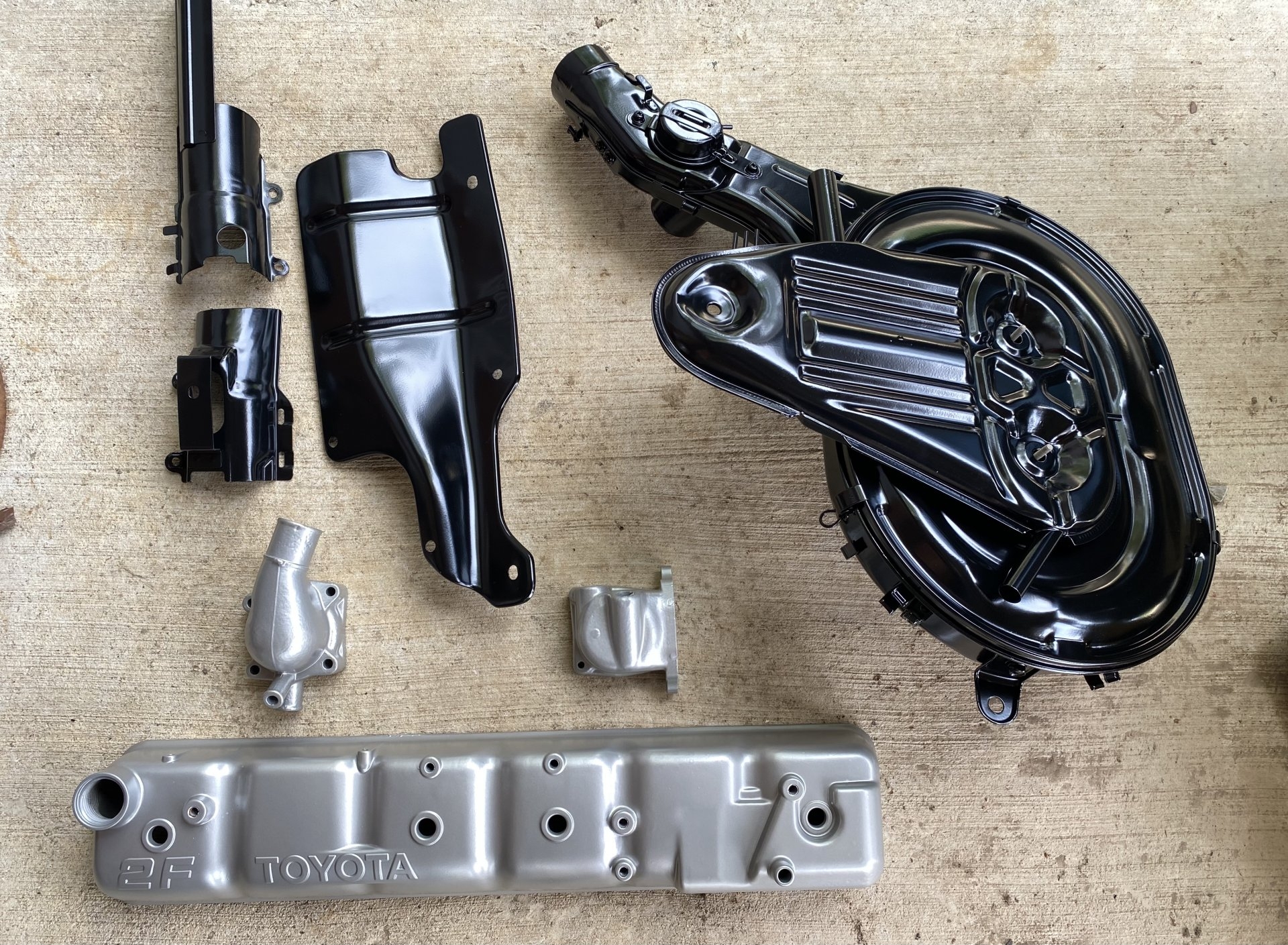

I normally put it in the block but this time I’m going into the thermostat. I’m getting it from powder tomorrow.

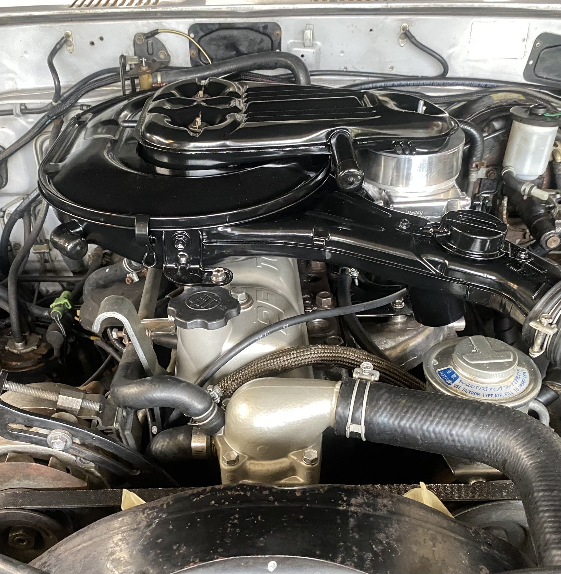

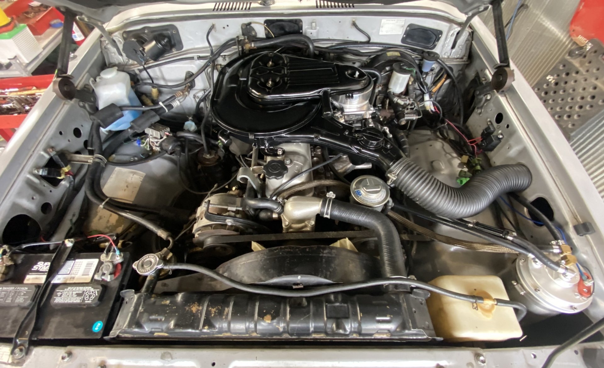

Ole R2D2 is put together. Engine fired perfectly. Everything sounds good.
Problem with the lower thermostat housing getting a good seal with the temp sensor so I had to remove it. I had a non smog lower that was brand new here and installed it and moved the temp sensor to the side of the block where I normally install it.
Now I don’t have any temp sensor. It’s sending an error code. Without that input I can’t tune it.
I’m going to toss a new sensor at it then if that does not work I’ll see what Holley says.

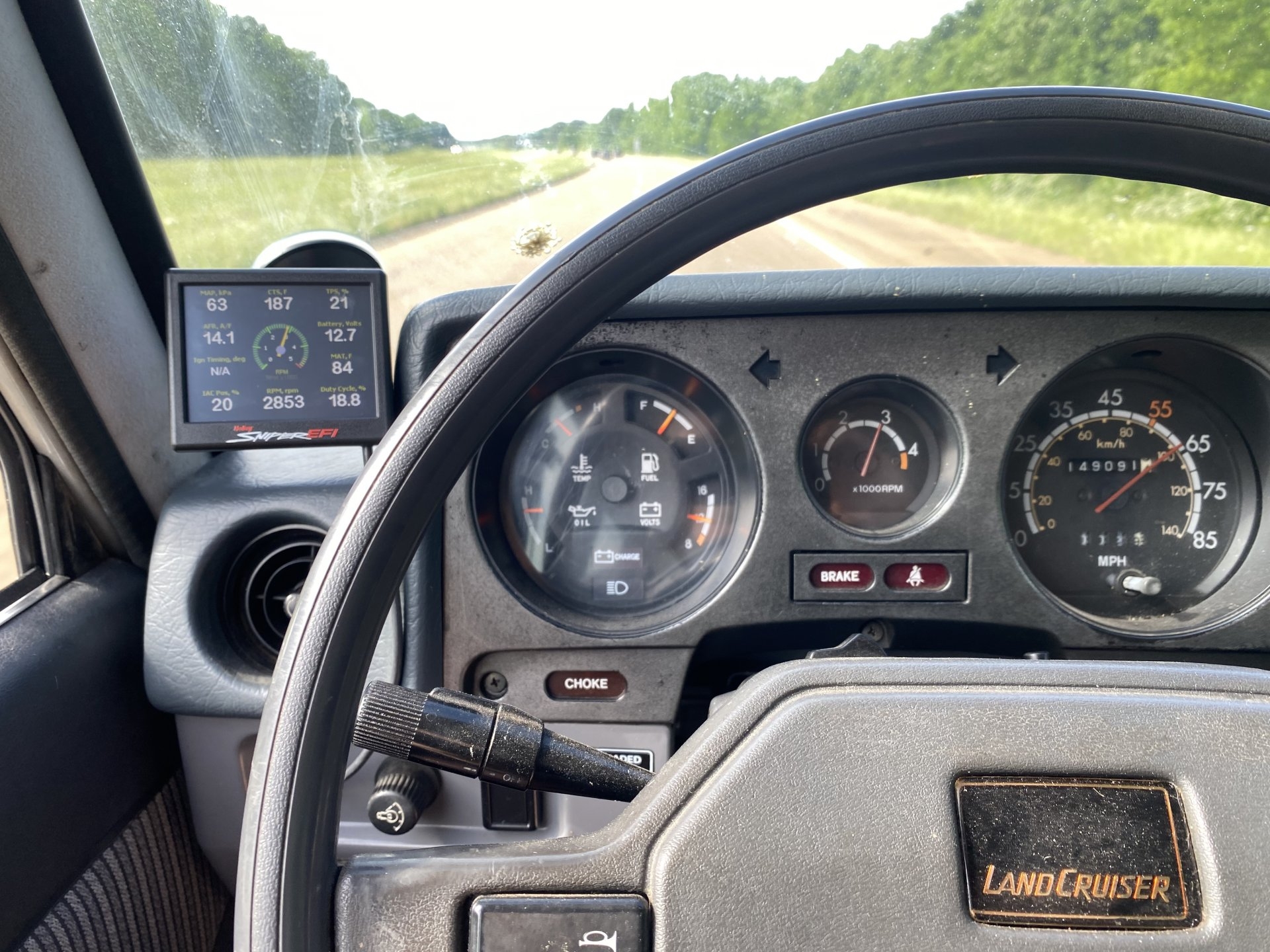

Long day testing the Sniper.
Tooling along great this morning and it ran out of fuel on me and I coasted to a stop on the exit ramp about 10 miles out.

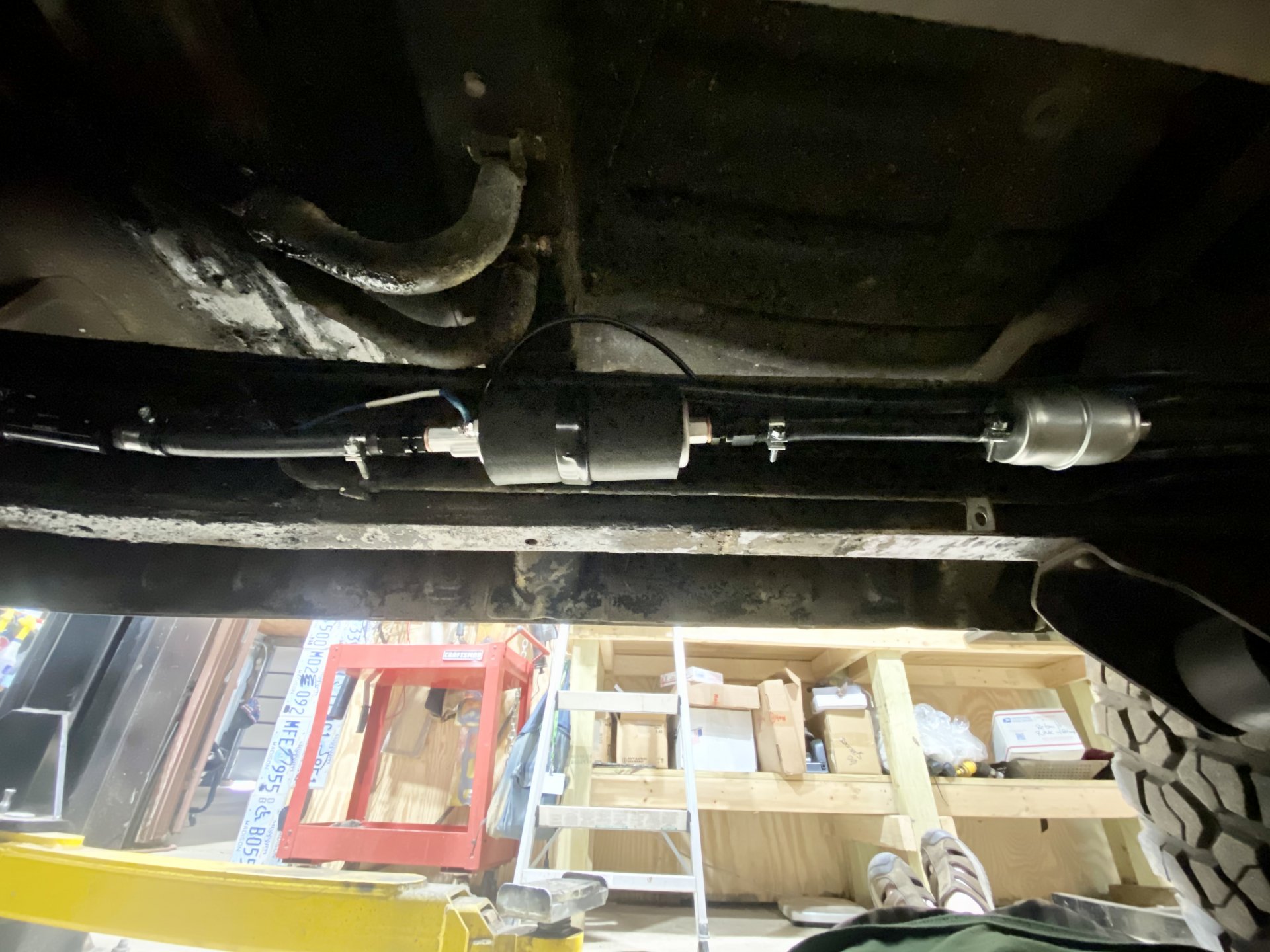

@FJ60Cam set me up with an in-line pump setup so I could get this thing down to one fuel pump to simplify things. Theory is based on the pulsating flow I was getting earlier.....plus I broke the positive lug off the PowerSurge so it had to be removed anyway to get repaired
So. Set up the new pump yesterday. Primed the system. Gauge looked good. Fired it up and it ran smooth as silk.
For 10 minutes then the surge returned.
I messaged Cam and Holley and they both suggested I had an obstruction in the return.
Seeing that the truck ran so good before the fuel injection and that it also has a brand new OEM tank I just assumed the return line was good.
Well that ASSumption was wrong. The return hard line along the frame has a blockage. I’m guessing the fuel pump return was doing all the work with the carburetor because once I bypassed the hard line I now have a perfectly running Snipered 2F.
But since this truck hates me I still have a coolant leak in the old upper thermostat housing I had powder coated. I’m going out of town for a few days so I put in an order for a new upper and a couple hoses to replace when I return. Hopefully that will get me there.
