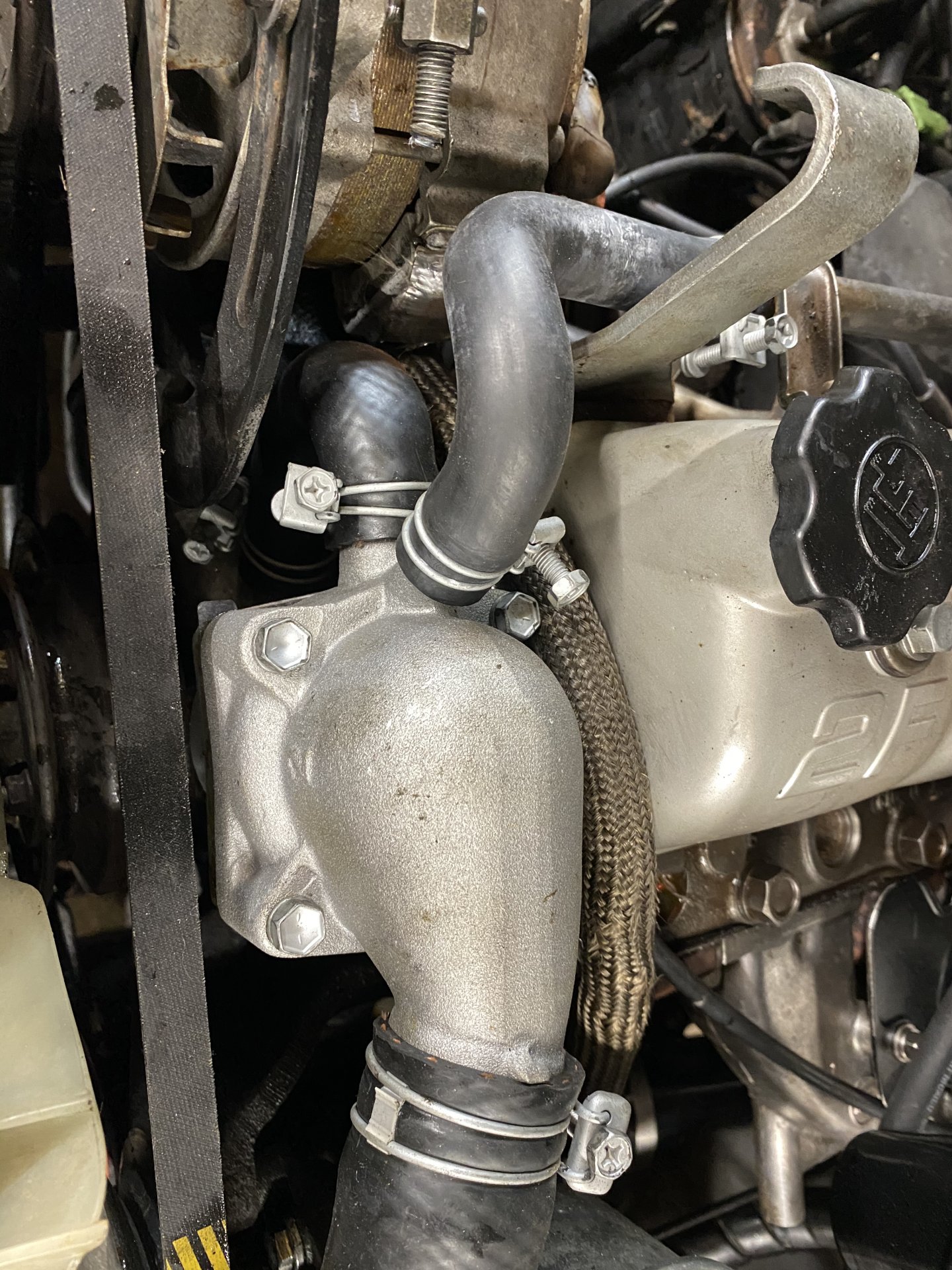

Got home from out of town and made a final push to finish this thing. @Onur sent me a new thermo housing and some hoses and the leaks are all gone.

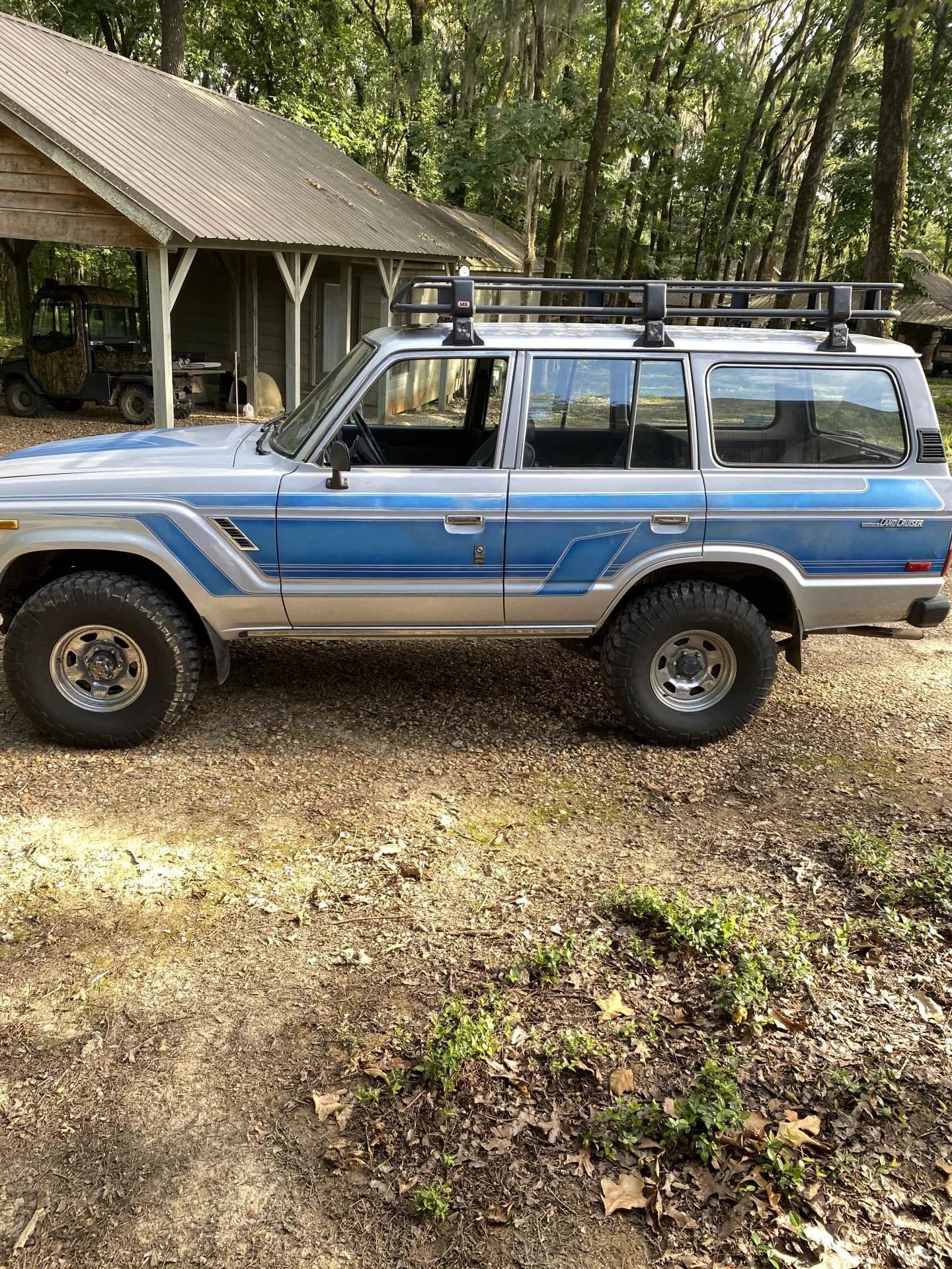

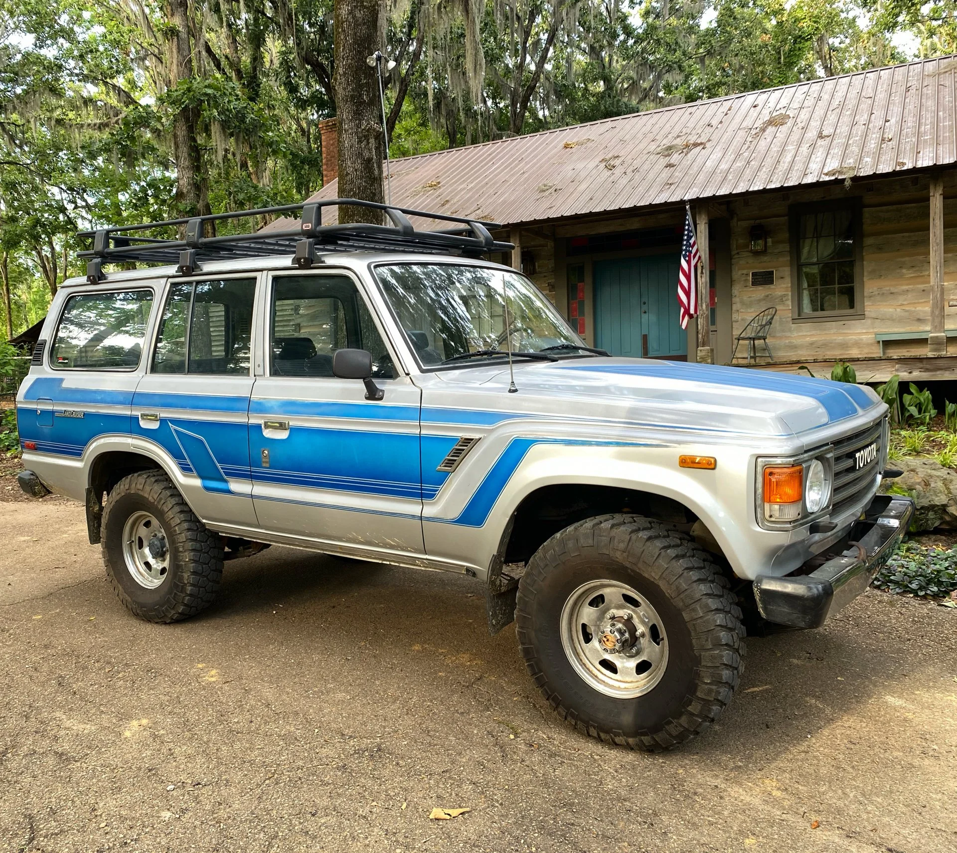

25 trouble free more miles of testing done and it’s running like a champ.

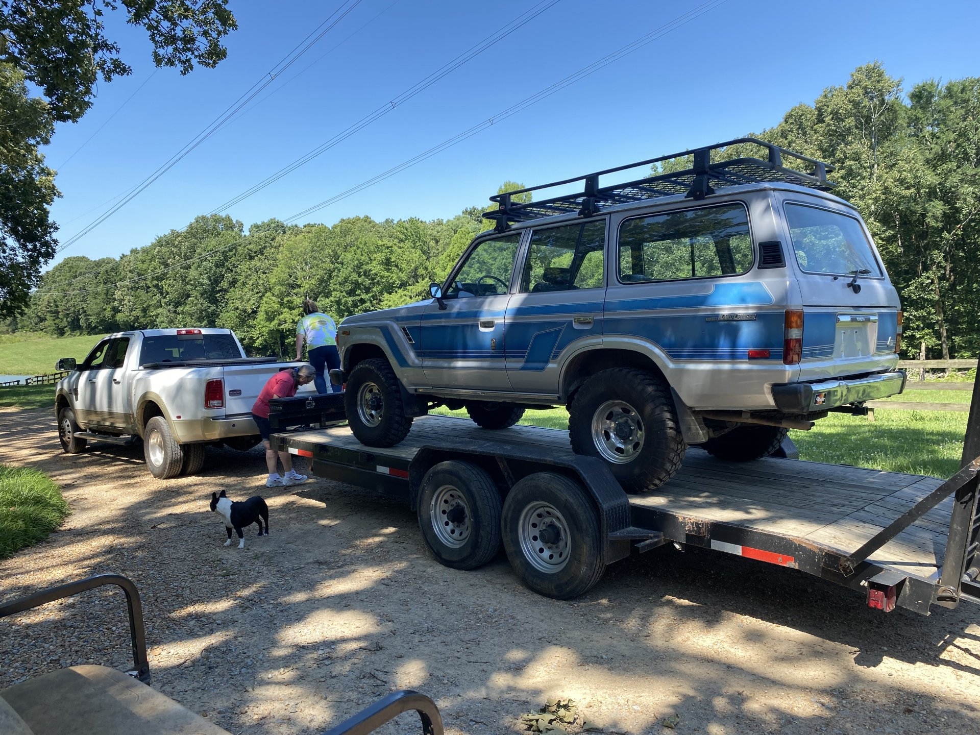

Time to call the shipper......
