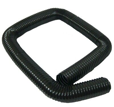

This is really the first year that I'm using Pork Roll in the winter. So I really never worked on setting up the heaters and other creature comforts.
Bought some $17 2.5" defroster tubing and rigged it up. Fits well and seems to be the cheapest option that I could find. Hopefully it will help somebody else.
