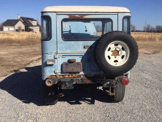

Unfortunately the 80 didn't come close to getting the 40 out of my brain. I monitored craigslist nationally, this site as well as ebay for months. I even made some offers on a few but for one reason or another they didn't pan out. I finally came across a (early) 1970 located out in New Mexico. It pretty much spent the last decade sitting in Arizona; although, it spent some of its life in Colorado. It drew me in because it is complete for the most part - original front seats (a mess but all there), rear long jump seats, hardtop, original frame and engine. Cool looking patina too :)
Pros:
Pretty much complete (missing original rear lights and bumperettes)
Good Compression across all cylinders
Minimal rust - frame is really solid and floors, doors are good.​
Cons:
Rear sill is rusted - will probably do patch panels for the rear quarters too
Not running...yet (need a carb rebuild, fuel system gone through since it's been sitting for a long time)
Need a complete brake overhaul​
My plan(s):
Original plan "Just get it rolling...safely" - Carb rebuild, new hoses, tune up, gaskets, new rear sill, quarter panel patch panels, brakes (discs, booster, dual circuit master), tall and skinny tires and rims (welded), reupholster seats and clean up some of the surface rust on the body and frame.
Alternate plan "My OCD is kicking in" - I just want to tear the thing down! I already started emailing sand blasters to have the body blasted and primed. Once the body is off I will have complete access to the frame which will allow me to blast it myself and make it look brand spankin' new.
I'm really not sure what to do. I can go either way on this. If anybody has been in this position and has any advice, I'd appreciate it. Originally I just wanted to drive a rolling relic but now I'm getting an urge to do a bit of a restoration.
In the meantime I'm just going to continue cleaning up the engine and fuel system, getting it sorted out and running. I will be sure to post the good, bad and ugly.

Just wanted to add a few more pictures of what I'm starting with. It seems as though Wolverine was the PO (see front seat pics). The good news is that the only major rust, granted I'm from the northeast so this is subjective, is the rear sill and lower quarters. I ordered the necessary body parts from CCOT and will learn how to weld. My cousin dropped off his miller welder for me today so I'm excited to start practicing. The floor has surface rust, mostly on the driverside and in the toolbox. I'll work on sanding/grinding it down and treating it. I was expecting the pan below the fuel tank to be a mess but it is actually the cleanest part of the floor! All of the doors are solid along with the rockers. I’ll continue to clean it up and post pictures of the progress.
I’m also sourcing the parts and placing orders for Toyota front disc brake knuckles and a rear disc conversion.
Plans of the next week are to continue to clean it up, pressure test the gas tank and radiator and get the carb rebuilt.
